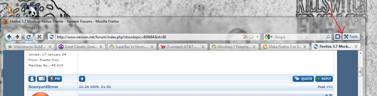

Just a little optical mistake on hover:
Is there any way to deactivate the border around this button on hover?

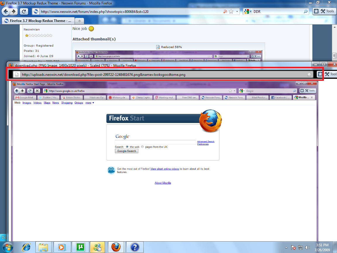

Clicking on an attachment the new window lacks transparency.
The problem is clear for the picture. Is it just me because no one else mentioned this
I think it has been mentioned once, but I've experienced it outside of this theme just using All-Glass. I don't think there's a fix as-yet, and unfortunately that addon isn't under the themers' control - I wouldn't get too hopeful, although there have been a huge number of very good and fast fixes for addon-invoked problems.
