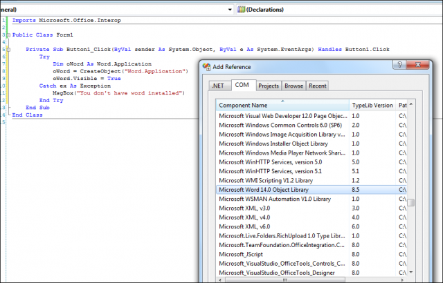

Try
	Dim oWord As Word.Application
	oWord = CreateObject("Word.Application")
	oWord.Visible = True
Catch ex As Exception
	MsgBox("You don't have word installed")
End Try
you also need to add the COM object "Microsoft Word Object Library" to your solution, and use an Imports statement for it
Imports Microsoft.Office.Interop

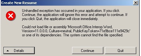

show me your whole method please, and also how are you deploying it to another machine?
  • 0
I am deploying it to my VM of Windows 2000.
    Private Sub WordSave_Click(ByVal sender As System.Object, ByVal e As System.EventArgs) Handles Button1.Click
        Try

  • 0
right well that method works just fine for me... in the fact that i get no error message when it launches word and inserts the text from a richtextbox.
so i can only assume that there is something else going on
i cannot test it on a machine without word, but i am going to work with the assumption that you are not deploying it correctly.. so how are you transferring it to your VM ?
also can you show a screenshot of when the error(s) occur, thanks! ;)
  • 0
right, so seeing as you haven't specified (and are making this difficult) i assume that is the error from the VM?
does your machine with word work ok now? it seems to have been forgotten about..
anyway, try packaging up the office .dll into your deployment package and deploying it again, you still havn;t said how you are deploying so again, i am making an assumption
work with me here! ;)

Yes, my machine with Word is working without issue now...I had left some unused code, and it was causing the issue there. I am just copying the .exe file over to the VM....is there some other file that needs to go along with it?
  • 0
copying the .exe only will not work because on the Vm you are still referencing something that doesn't exist.
i would add a setup package to your solution, and create an installer (which will include the necessary references) then you can take that installer file to your VM and install it
good luck! :)

sweet! that was it! it works now, I really appreciate your help!
