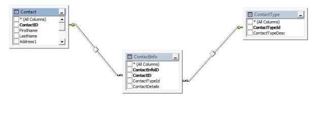

I am having some trouble getting my data out of my MSSQL database. I have three tables (Contact, ContactInfo, and ContactType). When I execute the query below I only get values back it has a reference in ContactInfo. Is there a way to get all the data out of Contact even if there is no reference in ContactInfo. I have attached a screen capture of my database diagram to help.
SELECT	 Contact.*, ContactInfo.*, ContactType.*
FROM		 Contact INNER JOIN
					  ContactInfo ON Contact.ContactID = ContactInfo.ContactID INNER JOIN
					  ContactType ON ContactInfo.ContactTypeId = ContactType.ContactTypeId

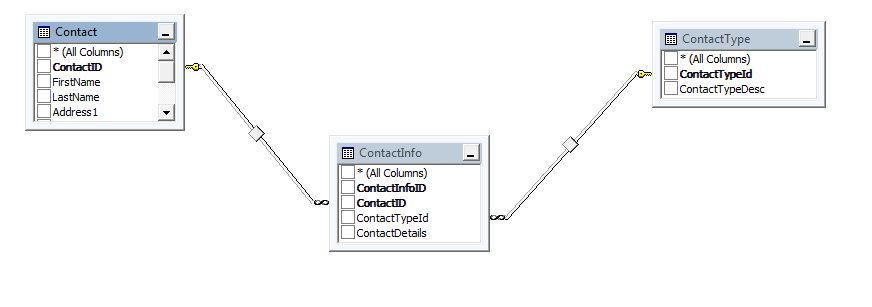

You can use LEFT or RIGHT JOIN instead of INNER JOIN.
FROM	 Contact LEFT JOIN
		 ContactInfo ON Contact.ContactID = ContactInfo.ContactID LEFT JOIN
  • 0
^ As he said, an INNER JOIN will only return records if the associated record exists on both sides of the join, i.e., if Contact.* and ContactInfo.*, and ContactType.* all have matching data. If either of those three tables produces null results, the entre row is ommited. Switching to a LEFT or RIGHT JOIN will resolve that for you, you just then have to decide what subset of data is important.
