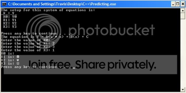

Hi again.
I wasn't sure where to put this question, so I decided to use my old post even though it isn't really related.
I tried to figure this problem out to the best of my ability but have really had no luck in understanding what was going on here.
So here's the console output:
And here's the code:

I'm trying to write a program that will do this system of equations (predicting) and later add steps to stream each process onto a text document. It's more or less just for the sake of further practice getting used to using cin.getline(s, number) rather than just cin >>, as well as getting a better handle on file streaming.
I've been testing each part of it as I write, which is why I added the part of the code to show that each part of the array had been successfully stored, but as you can see, they have not.
Now, when I compiled this code before testing it, for some reason my computer made a beeping sound as if you had tapped the shift button several time (which I suppose is possible for me have done by mistake) and I somehow ended up with the stored values of my arrays being smiley faces and, with other number inputs, unusual symbols.
Does anyone know what I may have done to change the array storage to convert input to symbols?
Using the get_num(); function is an example from my book, and using the variable = get_num(); function has worked perfectly in the past. In fact, I even copied the function definition from a working example, in case I had made an error, but that does not seem to be the case.
Any advice would be greatly appreciated as I really have no idea what I'm doing here with this problem.
Oh, and I use Dev-C++ to compile. I believe it's the version 4.9.9.2 or something along those lines.

  • 0
Quick look over the code, you need to change the value1 and value2 variables to be int's rather than chars. Your get_num() is returning an int but you're trying to display it as a character and hence the funny ASCII values.
Making those changes, it seems to work for me :)
