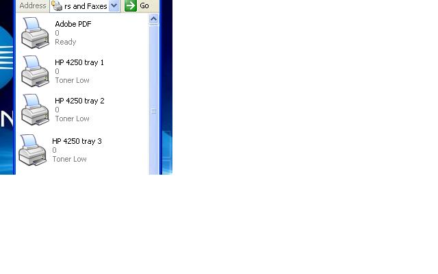

Hi,
So it looks like you have installed the printer 3 times right? With the names: HP 4250 tray 1, HP 4250 tray 2 and HP 4250 tray 3. If so then this 'should' work. But my VBA coding is very limited.

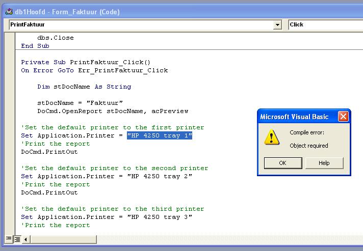

Hi,
thnxs for looking at it. I tried it to insert it by creating a button right clicking it and press and build event. When I try it I get an error "--------------------------- Microsoft Visual Basic --------------------------- Compile error: Object required ---------------------------OK Help ---------------------------
Any thoughts ?

Hi,
Any thoughts ?
Does it highlight any line of code? You did replace the form name with the name of the form you are trying to print? Otherwise I don't really know.
As for were you put it, I 'think' that is right. I am used to 2007 now. I create a button, cancel the wizard that opens and go to 'Properties>Event>Click>Code Builder' (Which should open the VBA editor) and put the code in there.
If i get time sometime I will load up a VM and give this a try.
  • 0

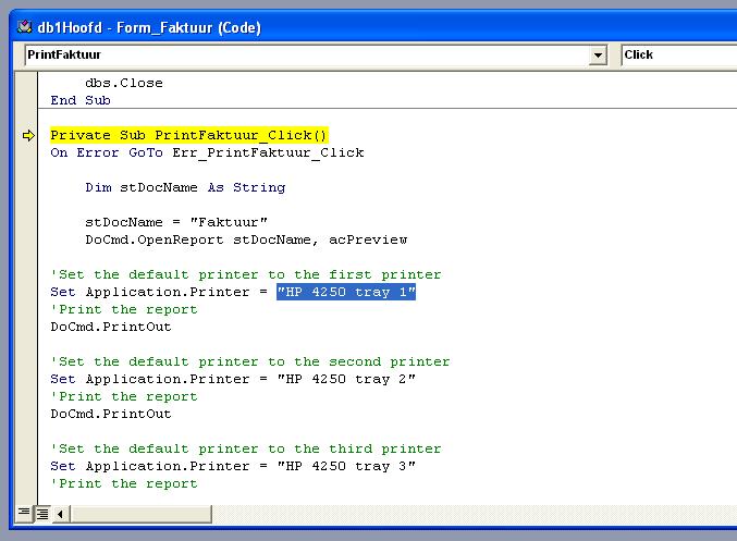

Hi,
I've made a screenshot. Could you take a looksie pls ?
Zwinky

Ok here is the revised code:
'Set the default printer to the first printer
Set Application.Printer = Application.Printers("HP 4250 tray 1")
'Print the report
DoCmd.PrintOut
'Set the default printer to the second printer
Set Application.Printer = Application.Printers("HP 4250 tray 2")
'Print the report
DoCmd.PrintOut
'Set the default printer to the third printer
Set Application.Printer = Application.Printers("HP 4250 tray 3")
'Print the report
DoCmd.PrintOut
'Close the report
DoCmd.Close acReport, strFormName, acSaveNo  'report name again!
Just make sure that the printers are listed in the Print menu with those names, and it 'SHOULD' print. Good luck!

Hi,
thnx ! It prints now. It only ignores the tray selection in the printer drivers. It prints to the bypass tray. The printers print fine on the correct page when printing a windows testpage. Any thoughs ?
I also did not use the above code. When I did this It printed but got an error that an object was required.
Thnx alot for helping !

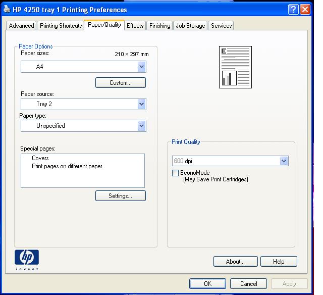

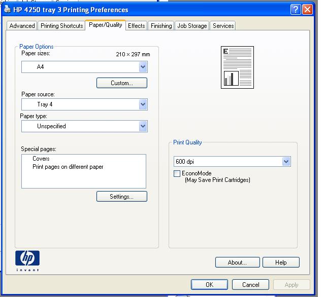

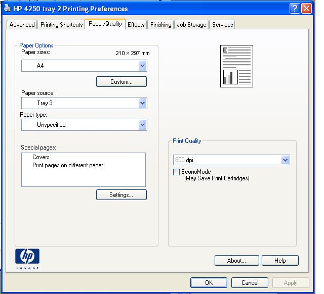

So its printing to the different printers fine, but it won't print on the correct tray. If you print manually it prints on the correct tray. Could you take a screen-shot of 3 different printers, and the tray settings you have set to print on the correct tray. Thanks
  • 0
Yep, its printing to the correct printers but ignores the tray settings. Even better ... I disabled all the other tray's in the drivers but it even ignores these settings to. Really at my withs end now ...
The screens like you asked are in attachment. Could this be driver related ? Can I set the tray in the code ? Maybe this is a solution ?
  • 0
I personal don't change it there. Try going to 'Printing Shortcuts' and creating a new shortcut. Call it Tray 1 or something. Then set the paper source. You then apply the shortcut. See if that works.
  • 0
tried it and still no go. Keep the same. It ignores the tray settings

The code I using now is:
Private Sub PrintFaktuur_Click()
 On Error GoTo Err_PrintFaktuur_Click
	Dim stDocName As String
	stDocName = "Faktuur"
	DoCmd.OpenReport stDocName, acPreview
'Set report name
Dim strReportName As String
strReportName = "Faktuur" 'Put your report name here
'Open the report
DoCmd.OpenReport strReportName, acViewNormal
'DoCmd.PrintOut - Only needed if you report doesn't print when opened, remove the '
DoCmd.Close acReport, strReportName, acSaveNo
'Open the report
'Open the report
Exit_PrintFaktuur_Click:
	Exit Sub
Err_PrintFaktuur_Click:
	MsgBox Err.Description
	Resume Exit_PrintFaktuur_Click
End Sub

Wooohooo :) It works for the invoice. I've used the code below. It now prints on tray 1,2,3 without any problems. Strangly thow I've inserted the same code for the "stockorders" and this time it wants to print to the bypass tray. Really annoying because basically it's the same code ...
The code for the invoices that works:
'Set report name
DoCmd.OpenReport "Faktuur", acViewPreview, , , acHidden
With Application.Reports("Faktuur").Printer
.ColorMode = acPRCMMonochrome
.PaperBin = acPRBNLower
End With
