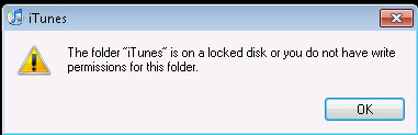

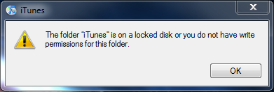

I've been running iTunes 64 bit on Windows 7 Home Premium 64 bit for a few months and it's been working great. Suddenly I've started getting this message: "The folder "iTunes" is on a locked disk or you do not have write permissions for this folder. iTunes then fails to open. I have found that I can run it as an admin and it plays my music fine but that means I have to click through a UAC prompt and an iTunes compatability prompt everytime I run iTunes.

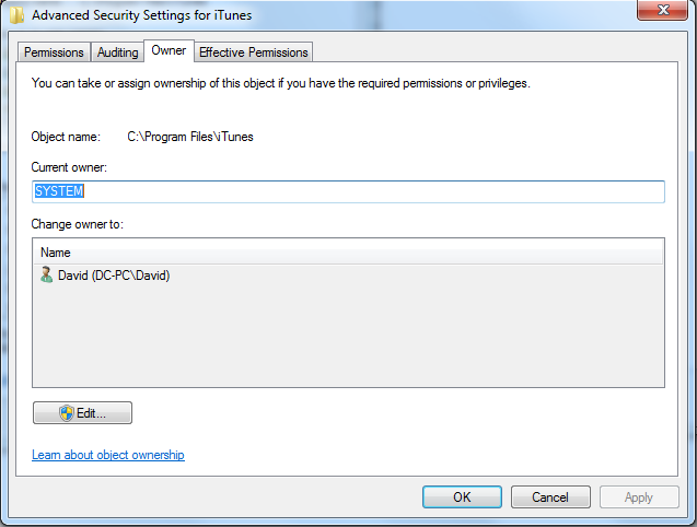

I am using an administrator account, I've checked my iTunes folder in Program Files and my music folder and I am the owner of both folders with full permissions (read, write, execute, etc). I've tried uninstalling and reinstalling and I've looked on Google for some suggestions but I can't seem to get to the bottom of it.

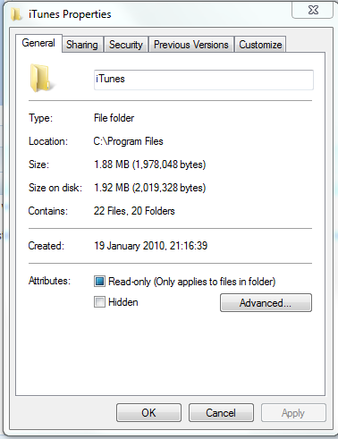

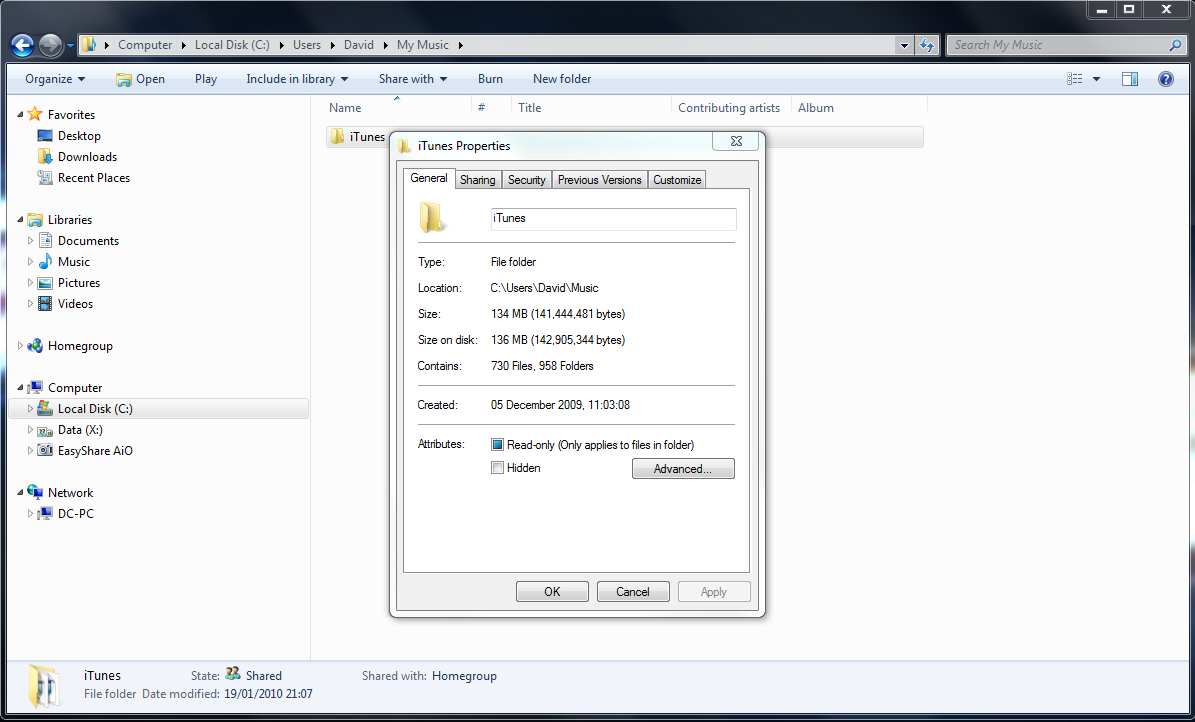

The only thing I have noticed is that every folder on my PC is marked as read only - is this normal? I've gone into properties and unchecked the read only box and applied it but when I open it back up again the read only box is checked again! Even so, I CAN write to them.

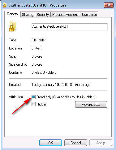

"The only thing I have noticed is that every folder on my PC is marked as read only - is this normal?"
This seems to come up every couple of weeks -- Yes the read only is NORMAL!! Windows does not use the read only attribute on folders.. And you can not set it with the explorer UI anyway. Only way to view or read the read only attrib on folder is with the attrib command from a prompt.
That is just a tri box, that allows you click through the different options of a check mark or cleared, etc.
It has NOTHING to do with your problem!
Please post the permissions of the folder -- do you have a lock on it?
You can be owner, you can have full control -- but with the way UAC works your account would have to elevate to gain access if for example you do not have authenticated users with access, or you account specifically or the users group, etc.
Please post a screen shot of your folder and its permissions. And we can straighten it out -- but its has nothing to do with this.

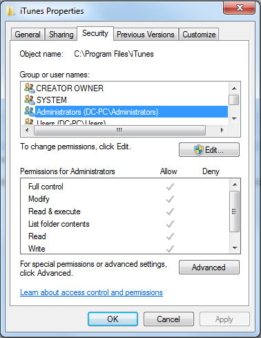

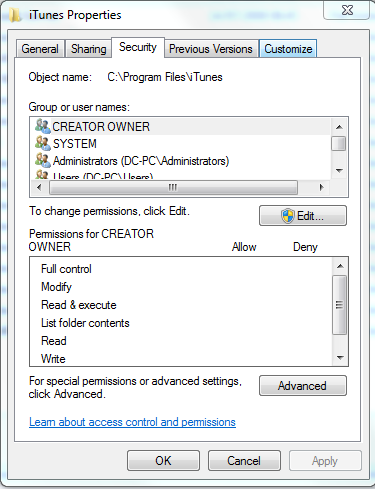

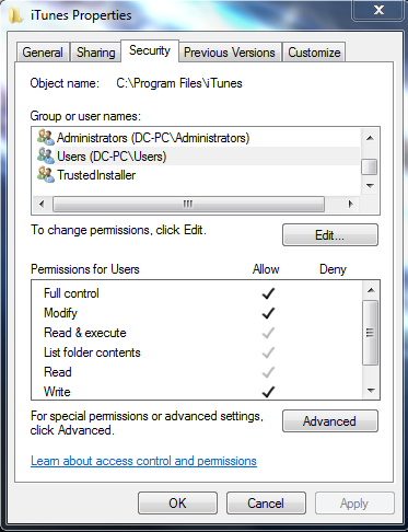

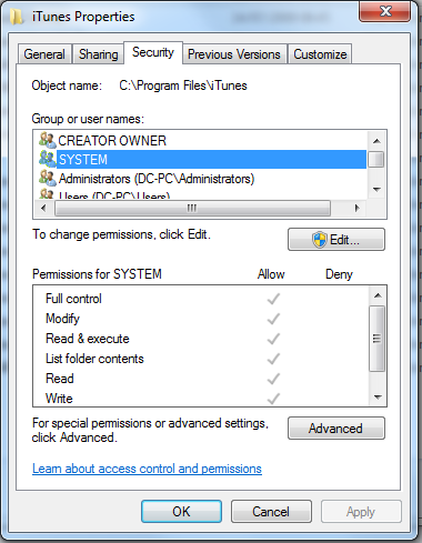

No none of the folders have the lock on - the screenshots from Program Files are attached.
There's also an iTunes folder in the Program Files (x86) folder but everything looks the same. I take it that the CREATOR/OWNER entries should be blank as they are for other folders aswell.

And what is the permissions for the user group? Just because your in the admin group does not always mean that is the permission your going to use..
And what is the exact prompt your getting - could you post a screen shot.
BTW -- how are you sure its not related to your music folders permissions? And are you running the 32 bit or the 64 bit version of itunes?

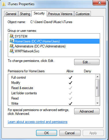

Here are the extra screenshots. I'm using the 64 bit version, and assumed that it wasn't a problem with my music folder as I reset the location to the default one but I guess there could still be a problem there. I'll take the screenshots of those and post back in a min.

Thats not a windows permissions error -- thats a itunes specific error.

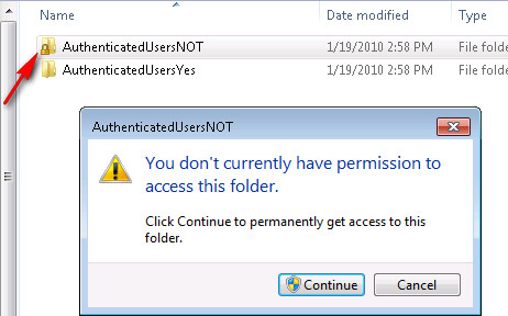

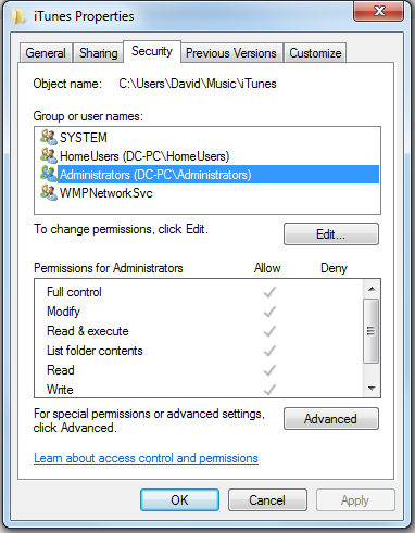

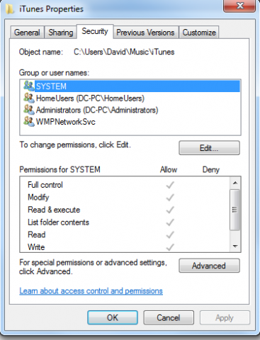

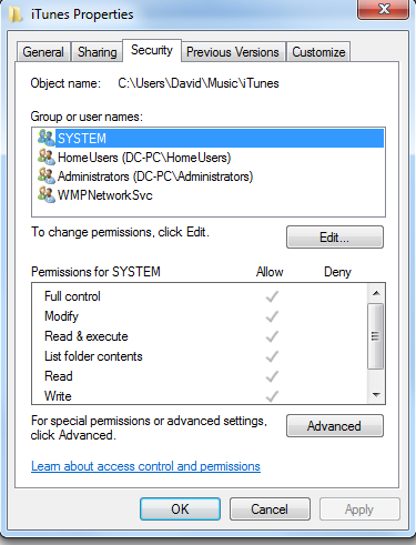

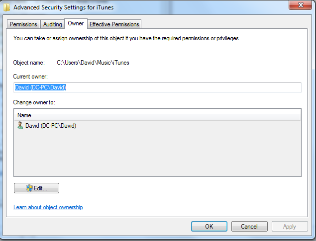

Screenshots of C:\Users\David\My Music\iTunes\
The 'David' folder DOES have a padlock on it - is that correct?

You should have permissions on that folder directly.
And the files.

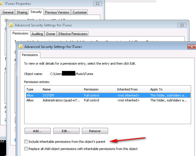

yeah I duplicated your error by removing my specific account from the itunes folder in my music folder under my profile.
Did you remove the inherit flag from the folders or something -- your account should have specific permissions on all folders under your profile.

Ticks all the way down (apart from special permissions) for both users and administrators.

see my edit -- your ACCOUNT should have permissions, not users or admins -- does not matter.
did you uncheck inherit flag?
As to resetting them -- what are the permission on your music folder? It should list you directly.. If so just have the itunes folder inherit.

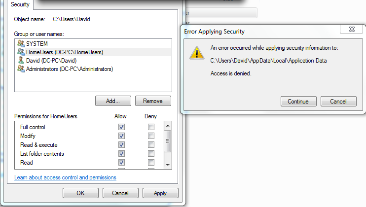

The HomeUsers group doesn't have ANY permissions - I tried to add them but get the following error. All other groups have all permissions (apart from special).

Not on the david folder -- users should not have permissions anyway -- your running home groups?? And shared your folders?
Its YOUR profile -- your profile folder -- your account should specifically be listed! Home users must be a homegroup thing.
But on the itunes folder your david account needs to be listed
edit: I would have to look on my homegroups test box to see what it does on permissons on the user folders.

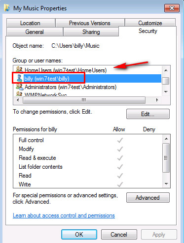

Yeah -- but your profile should have your permisions on it - not just the homegroup users account.
Here I looked on my test box running homegroups -- as you can see it added the homeusers, but see my billy account.
Your account should be on every folder and file under your profile.
Just add your specific account and you should be good, just make sure your music and then itunes folder inherits it
edit: What I don't understand is how your account would have been removed from your own profile music and itunes folder??

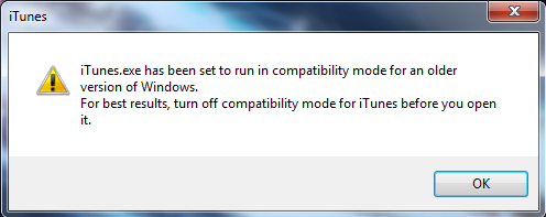

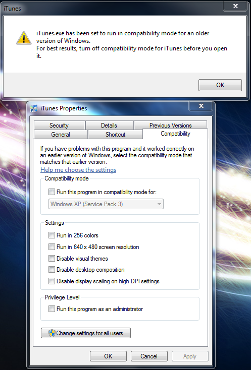

I've added my user account to the My Music folder and iTunes does start now but I get the attached message about compatability (nothing is checked on the compatability tab in properties) which makes me think I have changed something I shouldn't have when trying to sort this out, but I think you have solved my problem - thanks! :)

So your saying when you look on your itunes shortcut it has nothing set for compatibility -- but your getting this error now?

Yes, no compatability options are checked but am getting this new message - see screenshot. iTunes does open though.
