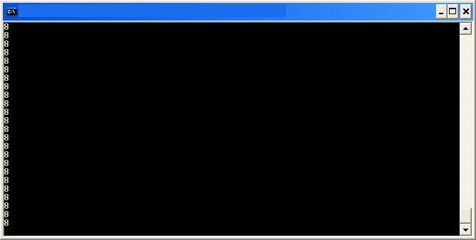

Well, I was just playing with C++ and made a trivial program:
int user_num;
while(true)
	cin>>user_num;
	cout<<(int)user_num<<'\n';
Weird thing is, if the user enters non-integer number, the program keeps repeating the integer number forever.
For example: if user enter 8.1, program will keep repeating 8 in an infinite loop.But if he entered integer number, it will just show the number normally and wait for next number.
Tried to change that, instead (int) made it (bool), and similar thing happenned, if user enter any non-zero non-integer number, the program keeps repeating 1 forever.But if integer number it will converted to 1 normally (or 0 if user entered 0).
I tried also to make it (bool)(int)user_num but same thing.
Got it fixed when I changed user_num type to float, but why the error happened in the first place ? just curious if anybody can explain.

  • 0
So you create an infinite loop and wonder why it loops infinitely?
The loop is infinite, but what it does inifnitly is:
wait for user input
convert to integer and show it
wait for other input
NOT:
wait for user input
convert to integer
keep repeating the converted value forever and not wait for other input !
This is the thing am wondering why it happened.

Found some more info at http://www.parashift.com/c++-faq-lite/input-output.html#faq-15.2
In particular, if someone enters something that doesn't look like an integer (such as an 'x'), the stream std::cin goes into a "failed state," and all subsequent input attempts return immediately without doing anything

I would venture to guess it has to do with the way cin works. When you type "8.1" and hit enter, the "8" gets stored while the ".1" sits in the stream. The next iteration comes around and it sees ".1" in the stream and ignores it because it's not an int. It then print out user_num and begins again.
Try cin'ing a string and then casting it to an int.

Found some more info at http://www.parashift...t.html#faq-15.2
thanks :)
that explains it
Fixed the code, now it is:
float user_num;
while(!cin.fail())
	cin>>user_num;
float will prevent errors when converting decimals, and the while(!cin.fail()) should prevent errors if user enter any other data type.
