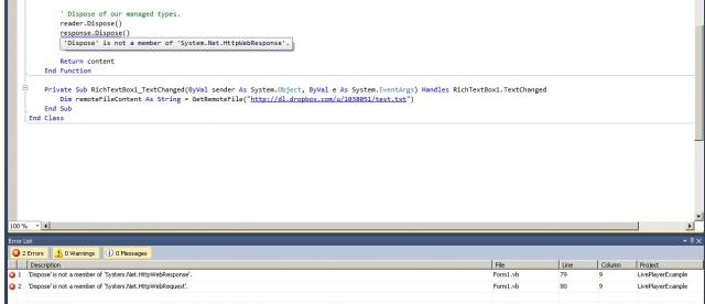

0 Antaris Veteran Posted February 11, 2010 Veteran Share Posted February 11, 2010 Ah, my bad, HttpWebRequest and HttpWebResponse Dispose methods are protected. You can remove them from your code, so remove the lines: request.Dispose() response.Dispose() Link to comment Share on other sites More sharing options...
0 Lilrich Posted February 11, 2010 Author Share Posted February 11, 2010 Yes, the app runs now but if i call the function inside a label function the text dosent display that is inside the .txt file and i know their is some in their http://dl.dropbox.com/u/1038051/test.txt Public Function GetRemoteFile(ByVal url As String) As String ' Create our web request, and get its response. Dim request As HttpWebRequest = DirectCast(WebRequest.Create(url), HttpWebRequest) Dim response As HttpWebResponse = request.GetResponse() ' Read the content from the stream. Dim reader As StreamReader = New StreamReader(response.GetResponseStream()) Dim content As String = reader.ReadToEnd() ' Dispose of our managed types. reader.Dispose() Return content End Function Private Sub Label1_Click_1(ByVal sender As System.Object, ByVal e As System.EventArgs) Handles Label1.Click Dim remoteFileContent As String = GetRemoteFile("http://dl.dropbox.com/u/1038051/test.txt") End Sub End Class Link to comment Share on other sites More sharing options...

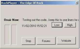

0 Lilrich Posted February 11, 2010 Author Share Posted February 11, 2010 Is it possible to put it in a text box or something like that and have it scroll along? Link to comment Share on other sites More sharing options...
0 Antaris Veteran Posted February 11, 2010 Veteran Share Posted February 11, 2010 Lol, add a textbox to your form, and then set the content: TextBox1.Text = GetRemoteFile("http://dl.dropbox.com/u/1038051/test.txt") We can only show you the door, its up to you to explore what's on the other side. Link to comment Share on other sites More sharing options...

0 Lilrich Posted February 11, 2010 Author Share Posted February 11, 2010 YAY!!! Link to comment Share on other sites More sharing options...
