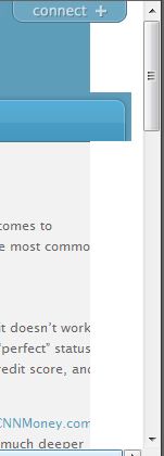

This just popped up out of nowhere, how do I correct it?
If this is the first time you are reading one of my posts, you will have to ask me for any extra info as I am not a coder. I am just pointing out the problem and hopefully someone can help me out.
Thanks!!

Link? No one can help debug the problem if they can't physically look at your code and view in a browser.
Thats what I meant about asking, forgive my ignorance.
Let me go ahead and upload the files to my host. I was using dreamweaver. Gimme about 2 minutes...
Edit: The URL is Elitecreditinfo.com
Edit 2: Still alot of work to be done in the graphics area, if you know a good font for the title and icon, let me know. :)
Edit 3: When the site is viewed in full screen it is fine, but if you out it in windowed mode, the part that is off screen turns white. If you have to scroll to the right you will see it.

From what I can tell, it looks like you have your divs set to a specific width and the background is only filling those. Try setting the paragraph width instead of the div width and see if that helps. That is the only way I can see this kind of thing happening without actually seeing your code.
