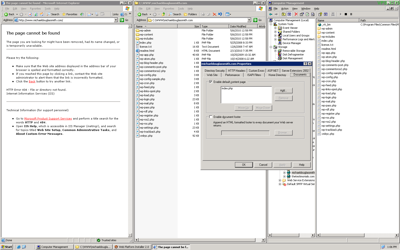

0 midosm.com Posted May 6, 2010 Author Share Posted May 6, 2010 I just published to the domain (www.michaeldouglassmith.com) on the server. I checked via the web and on the server itself. I have more than root access, Its a dedicated server so I have access to the whole server. Here is a screen shot. As you can see all the files are copied to the directory, but don't show up. Link to comment Share on other sites More sharing options...
0 Cupcakes Posted May 6, 2010 Share Posted May 6, 2010 Root access is the highest level.. Can't have "more" than that. So.. I've got a question then.. What else are you running on the server that you NEED a Windows based server? Also, have you setup and configured your server properly that it will be able to run Wordpress' requirements? Link to comment Share on other sites More sharing options...
0 midosm.com Posted May 6, 2010 Author Share Posted May 6, 2010 I am running some other like asp.net sites mostly in splash page form now. I used the Windows Platform INstaller which has Wordpress built in and loads all the require components for Wordpress (PHP, MySQL, etc). I didn't get any big red X's, only green checks. I loaded it the same way local on my W7 box and it worked 100% no issue. On the server I don't get any further than the 404. Must be some server setting missing/wrong. Link to comment Share on other sites More sharing options...
0 midosm.com Posted May 7, 2010 Author Share Posted May 7, 2010 Seems like I am making progress! Now getting a 500 error so it must see the file now in the browser. I now get: The specified procedure could not be found. Link to comment Share on other sites More sharing options...
0 sbauer Posted May 7, 2010 Share Posted May 7, 2010 IIS 6.0 requires you to approve extensions before they can be executed, which is why you were seeing the 404 messages. I'm not familiar with the platform installer, but does it install PHP for you? If so, what DLL did the installer map .php to? (It's under the Home Directory tab > Configuration button) IIS 7 (Windows 7) is quite different from IIS 6. Saying it worked under Windows 7 is like saying it worked under IIS 3, but not IIS 6. Link to comment Share on other sites More sharing options...
0 midosm.com Posted May 7, 2010 Author Share Posted May 7, 2010 mapping to "C:\Program Files\PHP\php5.dll" and now I get a 500 error. Link to comment Share on other sites More sharing options...
0 sbauer Posted May 7, 2010 Share Posted May 7, 2010 mapping to "C:\Program Files\PHP\php5.dll" and now I get a 500 error. Is that directory in your PATH environmental variable? Personally, I hate having PHP installed there. I'd rather it be placed in the root of the system drive (C:\php). Regardless, check on the PATH variable. Link to comment Share on other sites More sharing options...
