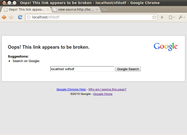

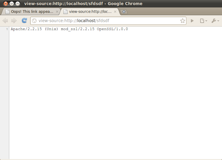

boogerjones Posted May 8, 2010 Share Posted May 8, 2010 I'm using Apache on Ubuntu to host a local website. I'm using the ErrorDocument directive to forward 404 errors to /cgi-bin/error_404 which is a perl script that looks like this: #!/usr/bin/perl print "Content-type: text/plain\n\n"; $server = $ENV{"SERVER_SOFTWARE"}; print $server; Problem is that in Chrome, it shows up as an error page, even though the HTML source is correct, as you can see in the following screenshots: What really makes me ****ing nuts is that the following works: #!/usr/bin/perl print "Content-type: text/plain\n\n"; foreach $var (sort(keys(%ENV))) { $val = $ENV{$var}; print "${var}=\"${val}\"\n"; } but this, with a single line change, doesn't (it gives the same problem seen in the screenshots): #!/usr/bin/perl print "Content-type: text/plain\n\n"; foreach $var (sort(keys(%ENV))) { $val = $ENV{$var}; print "What the hell?\n"; } What am I doing wrong? This is so goddamn frustrating. There are no errors in the Apache log. It works in Firefox, so maybe this is just a Chrome bug. Link to comment Share on other sites More sharing options...

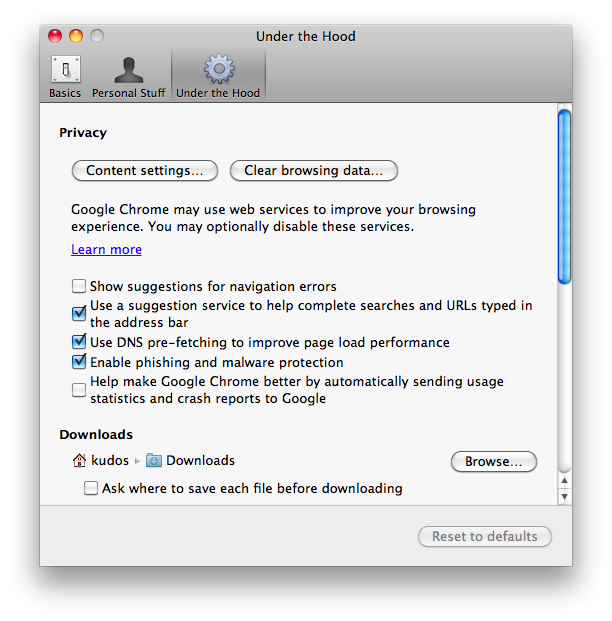

0 Kudos Veteran Posted May 10, 2010 Veteran Share Posted May 10, 2010 Untick "Show suggestions for navigation errors" Link to comment Share on other sites More sharing options...
#!/usr/bin/perl print "Content-type: text/plain\n\n"; $server = $ENV{"SERVER_SOFTWARE"}; print $server;Problem is that in Chrome, it shows up as an error page, even though the HTML source is correct, as you can see in the following screenshots:
#!/usr/bin/perl print "Content-type: text/plain\n\n"; foreach $var (sort(keys(%ENV))) { $val = $ENV{$var}; print "${var}=\"${val}\"\n"; }but this, with a single line change, doesn't (it gives the same problem seen in the screenshots):
#!/usr/bin/perl print "Content-type: text/plain\n\n"; foreach $var (sort(keys(%ENV))) { $val = $ENV{$var}; print "What the hell?\n"; }What am I doing wrong? This is so goddamn frustrating. There are no errors in the Apache log. It works in Firefox, so maybe this is just a Chrome bug.
