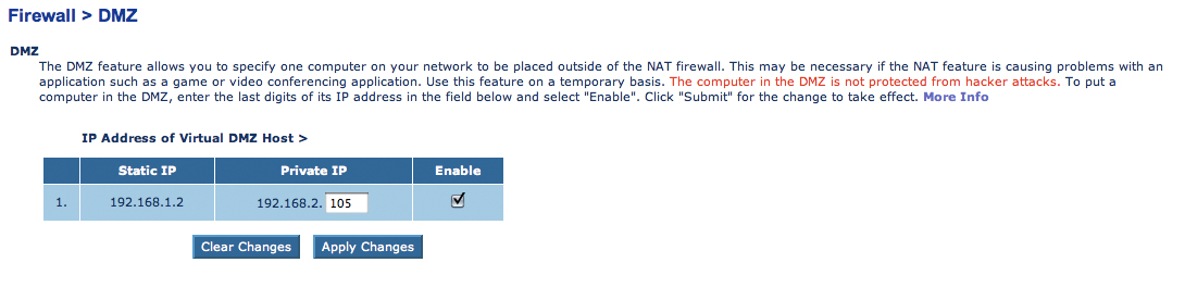

Wannes Posted June 13, 2010 Share Posted June 13, 2010 Hi I have a PS3 running the latest - I think - firmware. However, even though I'm connected to the internet wireless via my router, it can't find any of the PSN names I give in. I have a list of 15 people I'm wanting to add but all the time my PS3 says it can't find the user ID. I'm connected to the internet and logged in to my own PSN. Did anyone encounter the same error? I do have NAT3 when looking at my internet settings but this shouldn't deny me adding any friends. Thanks in advance. Ps. When trying to open up the PS Store I get error code: 80023110 Link to comment Share on other sites More sharing options...

Sikh Posted June 13, 2010 Share Posted June 13, 2010 You need to have a Nat Type 2 I believe, which is Open. Port forward or UPNP on your router or DMZ your PS3. Link to comment Share on other sites More sharing options...
Wannes Posted June 14, 2010 Author Share Posted June 14, 2010 I live in Europe and I do have the latest version so that should not be a problem. I've setup DMZ on my Belkin router but this doesn't seem to get me to NAT2... Link to comment Share on other sites More sharing options...
Wannes Posted June 14, 2010 Author Share Posted June 14, 2010 This is the only screen I get from DMZ. My static PS3 IP is: 192.168.2.105 My router IP is: 192.168.1.0 My subnet: 255.255.255.0 My DNS 1: 192.168.1.0 My DNS 2: 0.0.0.0 Link to comment Share on other sites More sharing options...
