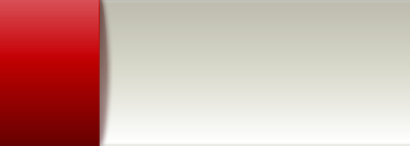

I was wondering if someone can please help me create a simple image with Convex + Concav effect? I am attaching a sample.
Looking at the image I think the trick is to make a gradient from top to bottom on one section and bottom to top on another section. I tried it but without that curved shadow effect it's not looking nice.
Can someone please tell me how to do that in Photoshop? I have Photoshop CS5 installed.
TA :)

You could make a circle, blur it and then delete the area over the red part.
Thanks but I am not a very good Photoshop person. I am just doing a small website for myself and needed something. Thanks though.
Thanks for the effort but without that curved shadow, it is not just getting the look.

Here is a psd where the image you posted has been replicated. Let me know if you have any questions.
Thank you so much mate :)
I just have one question. I did tr the same thing as you did but how did you managed to get the the gradient in the middle layer with the nice curve?
  • 0
Glad to hear you got it working. Here is how I created the second or middle layer. I created a elliptical shape and converted that to a selection with anti aliasing and feathering turned on. I then proceeded to set the fill to 0 and applied a gradient to get the effect.
  • 0
That is what I was missing. The one I made looked a tiny bit differnent than the one you made.
Converting that to a selection with anti aliasing and feathering turned on. How do I do that?
  • 0
After you have drawn the shape right click on it and select "make selection". The dialog box that appears after that will have the anti aliasing and feathering options.
