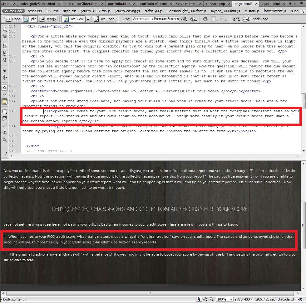

I am trying to get the text after the bullets to align the right way. I have tried all align codes I know but nothing works. I can't really explain but here is a picture to help.
I want "account" to be aligned under "When" and "if" to be aligned with "the". Thanks for all your help!

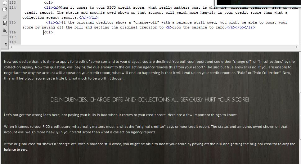

I tried that but it just gets rid of the bullets.
**In the picture I know the code isnt closed out, I noticed that when I took it and closed it with the same result, disappearing bullets. (</ul>)

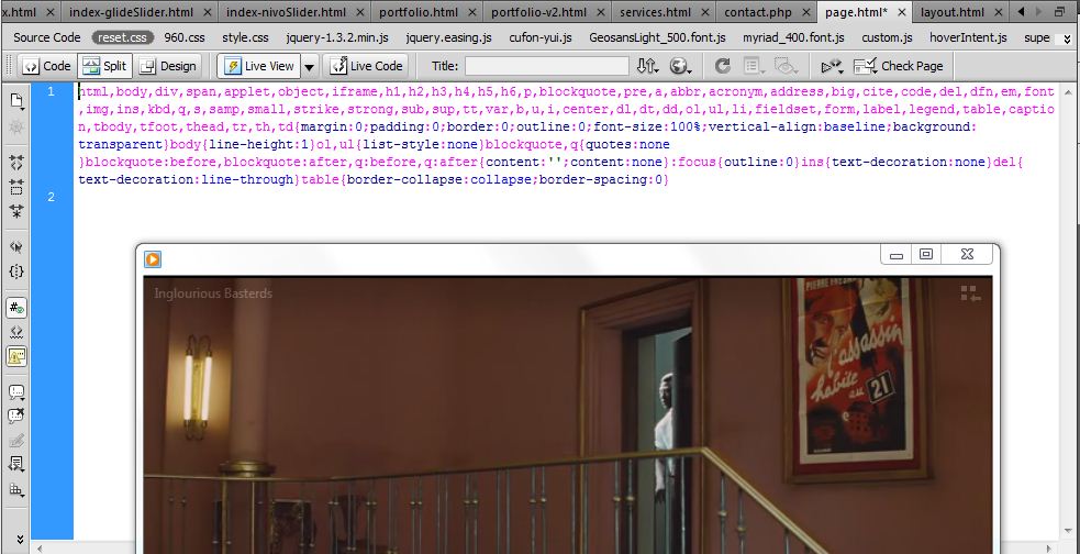

Are you using any sort of reset stylesheet? Those will generally get rid of styling on lists. You'll have to program it back in yourself.
Edit: Yep, you are. I see it in your linked resources up at the top of the first screenshot. :p

Here is the reset.css

Edit: While adding that I noticed <link rel="stylesheet" href="css/reset.css" /> in the source code, should I delete it?

right you have 3 style sheets attached to your site, 960.css, reset.css and style.css. somewhere in one of these files (most probably reset.css) the formatting for lists has been changed.
it should be something like this:
ul {
list-style-type:none;
or
li {
list-style:none;
or something along those lines
If you want all of your bullet points to be aligned the same across your site the best thing to do is delete it imo.
