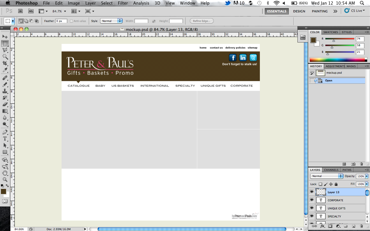

what do you guys think of this design... looking for something simple yet creative and user friendly... any suggestions or comments bad or good are welcome :)

ok guys im kinda struggling for some reason, maybe cuz im getting interrupted every 2 mins with other stuff and cant get this coding straight
the previous website had a lot of tables, and i want to avoid that completely... so i want it to be based on css and divs ofcourse... unless thats getting outdated as well lol
Based on the design above do i need to slice the layout or can it all just be done on css since its very simple and standard...
im also having some issues with getting the grey boxes lined up correctly and i want to use javascript to have a few pics on the bigger grey box...
any help is apprecaited... i had started coding it but the IT guy restarted all comps and he didnt save me stuff unfortunately so i got nothing to post as far as coding...
thx guys!
  • 0
thx guys!
Divs/CSS are the standard now and will be for a while. For the grey boxes, you should have a total of 4 divs to make it simple. One div will contain the 3 boxes, each of which get a div. Focus on positioning the container div which shouldn't be to hard in that layout. Then you just have to make the three divs inside it. There is some type float though I am not sure which one it is.

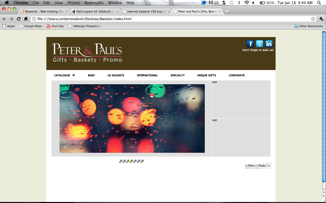

im having some trouble showing the white container background... if you look in pic above see the white behind the grey boxes... tahts what im talking about

are you talking about the white space below the boxes or the lines between the boxes.
i'm talkin about the white space that starts from above the logo up until the bottom of the page where that small logo on the right is....

html, body {
height: 100%;
#container {
height: 100%;
that might work.
if not try adding the min-height property.

that seems to do the trick except it wont show white above the logo part :s tried min-height too no luck
  • 0
Hi guys..
i got a question....
if you look at the screenshot i've attached... i cant seem to figure out why the little black dots underneath the bigger ones show.... cant seem to find out whats showing that.... it shows in both safari and chrome, but not opera.... haven't tested ie yet.
also i cant seem to get the white background to show above the brownish header... i've tried a few things but cant get it to show....

anyone have any idea why the white background is not showing above the brownish header? its driving me nuts lol
btw any opinions or critics on the design are also appreciated.... :)
i know the nav menu is not looking the greatest right now working on implementing that a little better as i move forward....
  • 0

anyone? :)
do you mean the white background of the container? and you want it to show above the header?
well without seeing your page i would assume the container div doesnt start till after the header.
you could move the start of the container div in your html above the header or wrap the header in a new div that starts before it and give it a white bg.

this is the code for the page ...css code is in a previous post...
&lt;body&gt;
&lt;div id="content"&gt;
&lt;div id="header"&gt;
	&lt;div class="logo"&gt; &lt;img src="images/logo.png" alt="Peter and Paul's Baskets" /&gt;&lt;/div&gt;
&lt;div id="social"&gt;
	&lt;div class="in"&gt; &lt;a href="http://www.linkedin.com/peterandpaulsbaskets"&gt;&lt;img src="images/Linked In-32.png" alt="LinkedIn" border="0"  /&gt;&lt;/a&gt;&lt;/div&gt;
	&lt;div class="tw"&gt; &lt;a href="http://www.twitter.com/pandpbaskets"&gt;&lt;img src="images/Twitter-32.png" alt="Twitter" border="0"  /&gt;&lt;/a&gt;&lt;/div&gt;
	&lt;div class="fb"&gt; &lt;a href="http://www.facebook.com/pandpbaskets"&gt;&lt;img src="images/Facebook-32.png" alt="Facebook" border="0" /&gt;&lt;/a&gt;&lt;/div&gt;
&lt;/div&gt;
	&lt;div class="slogan"&gt;Don't forget to stalk us!&lt;/div&gt;
&lt;/div&gt;
&lt;div id="navigation"&gt;
	&lt;ul id="menu"&gt;
    &lt;li&gt;&lt;a href="#" class="drop"&gt;CATALOGUE&lt;/a&gt;&lt;!-- Begin Home Item --&gt;
        &lt;div class="dropdown_2columns"&gt;&lt;!-- Begin 2 columns container --&gt;
		&lt;ul&gt;
			&lt;li&gt;&lt;a href="http://www.peterandpaulsbaskets.com/simplyfabulous.html"&gt;Simply Fabulous&lt;/a&gt;&lt;/li&gt;
			&lt;li&gt;&lt;a href="http://www.peterandpaulsbaskets.com/gourmetgoodness.html"&gt;Gourmet Goodness&lt;/a&gt;&lt;/li&gt;
			&lt;li&gt;&lt;a href="http://www.peterandpaulsbaskets.com/homegrown.html"&gt;Home Grown&lt;/a&gt;&lt;/li&gt;
			&lt;li&gt;&lt;a href="http://www.peterandpaulsbaskets.com/mymothersolivesandoil.html"&gt;My Mother's Olives and Oil&lt;/a&gt;&lt;/li&gt;
			&lt;li&gt;&lt;a href="http://www.peterandpaulsbaskets.com/under60.html"&gt;Under $60&lt;/a&gt;&lt;/li&gt;
			&lt;li&gt;&lt;a href="http://www.peterandpaulsbaskets.com/holiday.html"&gt;Holiday Entertaining&lt;/a&gt;&lt;/li&gt;
		&lt;/ul&gt;
	&lt;/div&gt;
    	&lt;li&gt;&lt;a href="#"&gt;BABY&lt;/a&gt;&lt;/li&gt;
        &lt;li&gt;&lt;a href="#"&gt;US BASKETS&lt;/a&gt;&lt;/li&gt;
        &lt;li&gt;&lt;a href="#"&gt;INTERNATIONAL&lt;/a&gt;&lt;/li&gt;
        &lt;li&gt;&lt;a href="#"&gt;SPECIALTY&lt;/a&gt;&lt;/li&gt;
        &lt;li&gt;&lt;a href="#"&gt;UNIQUE GIFTS&lt;/a&gt;&lt;/li&gt;
        &lt;li&gt;&lt;a href="#"&gt;CORPORATE&lt;/a&gt;&lt;/li&gt;
	&lt;/ul&gt;
&lt;/div&gt;
&lt;div id="container"&gt;
	&lt;div id="box1"&gt;
    	&lt;div class="show"&gt;
			&lt;div id="slides"&gt;
				&lt;div class="slides_container"&gt;
					&lt;a href="http://flic.kr/p/9aXsv6" target="_blank"&gt;
                    &lt;img src="img/slide-1.jpg" width="570" height="270" alt="Slide 1"&gt;&lt;/a&gt;
					&lt;a href="http://www.flickr.com/photos/stephangeyer/3020487807/"target="_blank"&gt;
                    &lt;img src="img/slide-2.jpg" width="570" height="270" alt="Slide 2"&gt;&lt;/a&gt;
					&lt;a href="http://www.flickr.com/photos/childofwar/2984345060/" target="_blank"&gt;
                    &lt;img src="img/slide-3.jpg" width="570" height="270" alt="Slide 3"&gt;&lt;/a&gt;
					&lt;a href="http://www.flickr.com/photos/b-tal/117037943/" target="_blank"&gt;
                    &lt;img src="img/slide-4.jpg" width="570" height="270" alt="Slide 4"&gt;&lt;/a&gt;
					&lt;a href="http://www.flickr.com/photos/bu7amd/3447416780/" target="_blank"&gt;
                    &lt;img src="img/slide-5.jpg" width="570" height="270" alt="Slide 5"&gt;&lt;/a&gt;
					&lt;a href="http://www.flickr.com/photos/streetpreacher/2078765853/" target="_blank"&gt;
                    &lt;img src="img/slide-6.jpg" width="570" height="270" alt="Slide 6"&gt;&lt;/a&gt;
					&lt;a href="http://www.flickr.com/photos/aftab/3152515428/" target="_blank"&gt;
                    &lt;img src="img/slide-7.jpg" width="570" height="270" alt="Slide 7"&gt;&lt;/a&gt;
				&lt;/div&gt;
				&lt;/div&gt;
            &lt;/div&gt;
		&lt;/div&gt;
	&lt;div id="box2"&gt;test&lt;/div&gt;
    &lt;div id="box3"&gt;
    &lt;!-- Start Bravenet.com Service Code --&gt;
&lt;div align="center"&gt;
&lt;div style="border:none; width:229px; height:104px; margin:0px; background-color:#dfdfdf;"&gt;
&lt;form action="http://pub16.bravenet.com/elist/add.php" method="post" style="margin:0px;"&gt;
&lt;div style="background-color:#fdfdfd; padding:3px; font:10px arial; color:#000000; font-weight:bold;"&gt;Join our mailing list!&lt;/div&gt;
&lt;div style="margin:10px; font: 10px arial; color: #000000; text-align:left;"&gt;
&lt;div style="margin-bottom:5px;"&gt;Enter your name and email address below:&lt;/div&gt;
&lt;div style="text-align:right;"&gt;
Name: &lt;input type="text" id="elistname" name="ename" size="25" maxlength="60" style="width: 164px"&gt;&lt;br&gt;
Email: &lt;input type="text" name="emailaddress" id="elistaddress87420232500" size="25" maxlength="100" style="width: 164px"&gt;&lt;br /&gt;
&lt;span style="white-space:nowrap; float:left;"&gt;&lt;input type="radio" name="action" value="join" checked style="border: 0px;"&gt;Subscribe?&lt;/span&gt;
&lt;span style="white-space:nowrap;"&gt;&lt;input type="radio" name="action" value="leave" style="border: 0px;"&gt;Unsubscribe?&lt;/span&gt;
&lt;input type="hidden" name="usernum" style="border: 0px solid black; height: 0px; width: 0px;" value="1366430928"&gt;
&lt;input type="hidden" name="cpv"  style="border: 0px solid black; height: 0px; width: 0px;"  value="1"&gt;
&lt;input type="submit" name="submit" value="GO"&gt;&lt;/div&gt;&lt;/div&gt;
&lt;div style="color: red" id="elist_err87420232500"&gt;&lt;/div&gt;
&lt;/form&gt;
&lt;!-- End Bravenet.com Service Code --&gt;
    &lt;/div&gt;
&lt;/div&gt;
&lt;div id="footer"&gt;&lt;img src="images/bypandplogo.gif" alt="ByPeterandPauls.com" /&gt;&lt;/div&gt;
&lt;/div&gt;
&lt;/div&gt;
&lt;/body&gt;
&lt;/html&gt;
