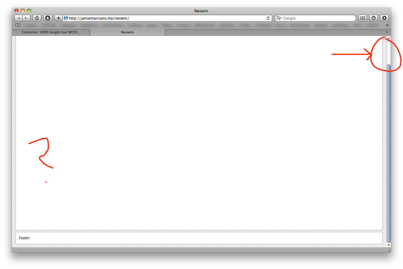

i've been struggling with this for over an hour now and cant figure it out, what i want is this (look at attachment):
I want my content area (lightest blue) to stretch all the way to my footer (dark blue), which must always be at the bottom, and i want the complete thing (content+footer) to have a 12px margin from the edges of the screen.
HOW the hell do i do this :angry:?
Oh, BTW: with the caps in the title i mean that i got it pretty much to work without the margin but when i put a margin in it, it looks good except the browser has scrollbars :(

Can you screenshot what you are trying to fix? Maybe I'm tired but I'm a little confused as to what the issue is..

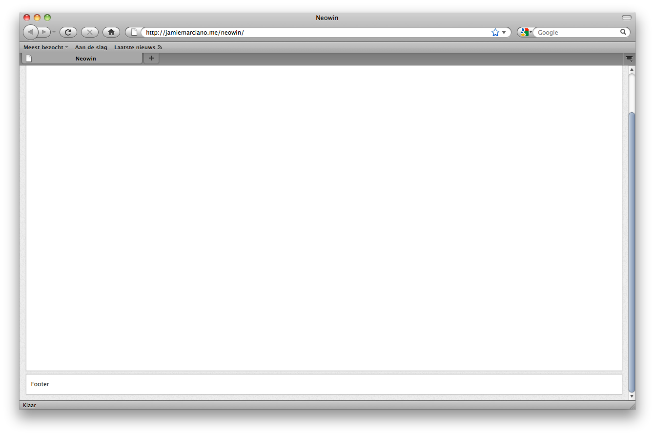

Sure, see attachments. Same for Chrome, but that's also Webkit (as is Safari).

See my screenshot. Is that your problem you're having with that CURRENT code? Or what?
So.. either you're still wanting to fix this or you nixed the idea. Which is it.
  • 0
I still want to fix it, and it's still the same problem. There are scrollbars but there is no content (so, unnecessary scrollbars). I don't get what you don't get to be honest.
To show you, i changed it back to 100% width. Now there are vertical and horizontal scrollbars. Same problem as just vertical, or just horizontal. also same fix. if there is one.
