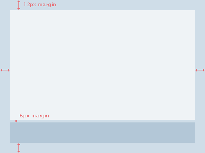

Hi guys,
i've been struggling with this for over an hour now and cant figure it out, what i want is this (look at attachment):
I want my content area (lightest blue) to stretch all the way to my footer (dark blue), which must always be at the bottom, and i want the complete thing (content+footer) to have a 12px margin from the edges of the screen.
HOW the hell do i do this :angry:?
Oh, BTW: with the caps in the title i mean that i got it pretty much to work without the margin but when i put a margin in it, it looks good except the browser has scrollbars :(

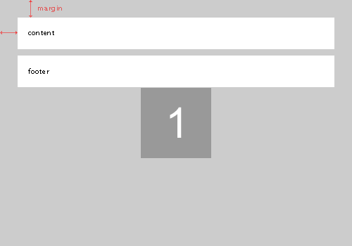

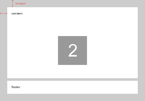

I'm sorry, i'll explain exactly what i want a little bit better:
Currently it looks like image [1], with the footer under the content area, and the content area only being as big as the content in it. (one line of text). What i wánt is for the footer to stick to the bottom, and the content to stick to the footer, at all times. as you can see in image [2]
- There should not be any scrollbars
- The margin should be equal on all 4 sides
I hope this is clearer.

Currently it looks like image [1], with the footer under the content area, and the content area only being as big as the content in it. (one line of text). What i w?nt is for the footer to stick to the bottom, and the content to stick to the footer, at all times. as you can see in image [2].
Ah, hang on. It looks like image 1? Because that's not what I'm seeing in the previous examples you've provided. I'm seeing something that much more closely resembles image 2 (which is what you're aiming for, right?). And your screenshots of what you're actually seeing also match more closely with image 2. However, the problem that you noted was that there are scrollbars, which is because you've got your container set to 100% and then you've got a footer and the margins that you want.
