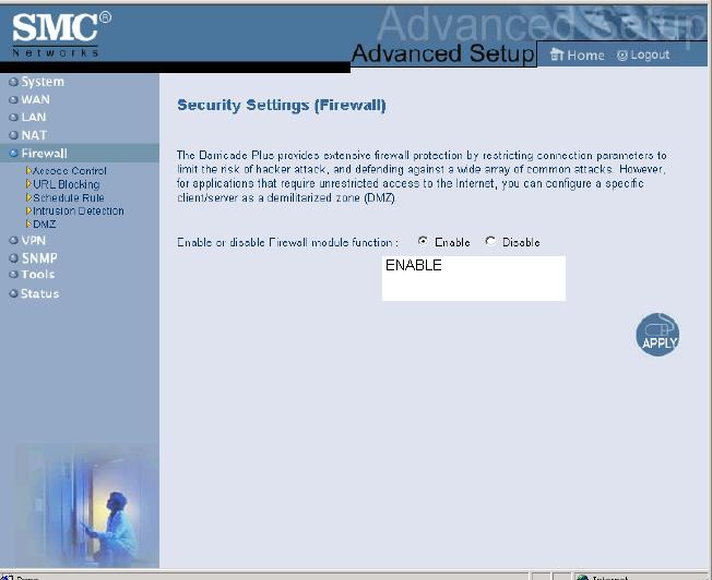

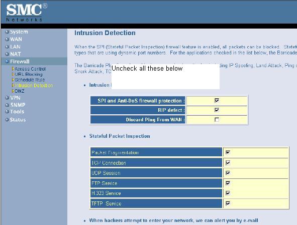

mAcOdIn Veteran Posted September 9, 2003 Veteran Share Posted September 9, 2003 No turning off the firewall from any computer on the network will turn off the firewall for them all. Where you prbably screwed up is the firewall itself needs to be on because on the SMC routers that also controls the NAT functions, but under the firewall page uncheck everything like RIP defects, discard ping from WAN, SPI filtering and so on. It's really weird how SMC set it up. Link to comment Share on other sites More sharing options...
