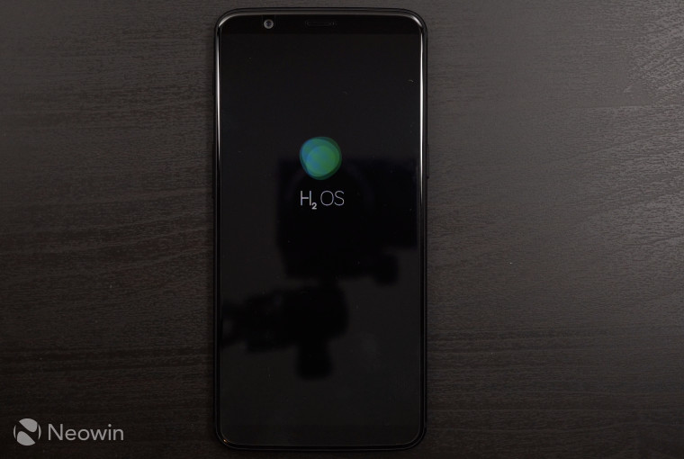

During the recent unboxing of the OnePlus 5T, it came as a bit of surprise that the device was running a specialized version of Android made for the Chinese market. At first glance, things look about the same, but on closer inspection, it could be seen that generally found standard apps like the Google Play Store were nowhere to be found. By checking the in the settings menu, it was discovered that the handset was loaded with HydrogenOS, which is a version that is specifically made for the Chinese market. The OS has its own set of apps but is devoid of anything associated with Google. As a user of many Google services, it was important to have access to these, a quick search revealed that this was possible, but would require some extra work.

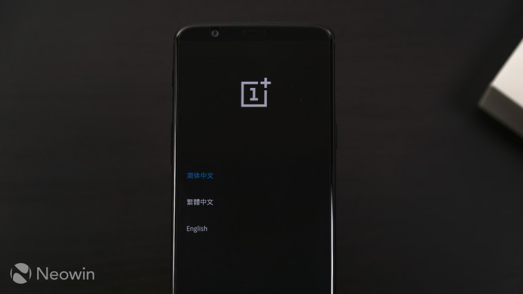

The first part of the process is to make sure you find the proper OS you want to load on your device. At the time of writing, OxygenOS version 4.7.4 is available from the support website, along with instructions on how to get things loaded onto the OnePlus 5T. You'll want to download the OS, which comes in at around 1.5GB, and copy the ZIP file to your handset. If you are using a PC, it is simply a matter of plugging in the unit and copying the file over to its storage. If using a Mac, you'll need a program called Android File Transfer. This will allow your Mac to see your phone as a storage device and transfer the file over. Once this is complete, you'll want to shut down the phone and power it up again while holding the volume down and power button simultaneously.

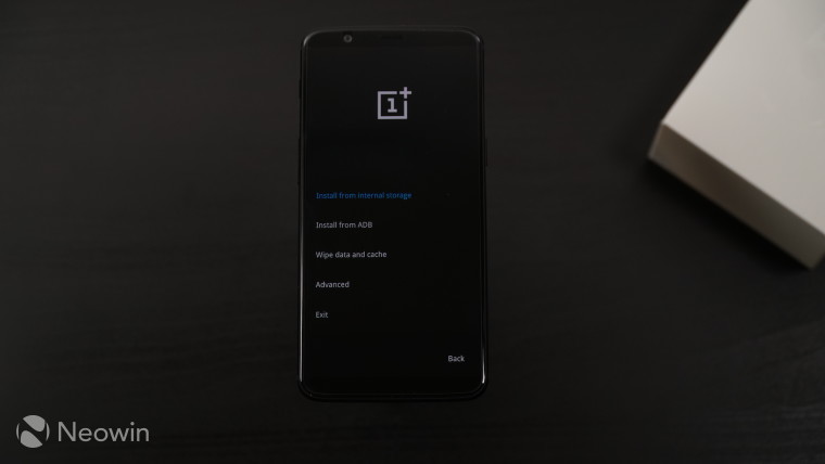

At this point, you'll be met with a screen that allows you to select your preferred language and also progress to the screen that will allow you to install the previously loaded OS file from internal storage. Once this is process is started, it should only take a few moments to complete. As a small tip, it might be wise to clear out the cache and any existing data when inside the recovery mode menu.
In our experience, while the OS loaded without issue, trying to load Google apps that required a login did not work the first time around, clearing the data resolved this problem.
