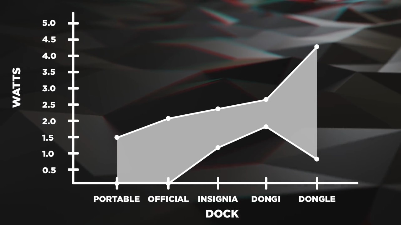

More recently, the aforementioned Bob Wulff went through the trouble of testing multiple third-party docks with a voltmeter to determine how they deliver power to the Nintendo Switch. The Genki Covert Dock wasn't available at the time, but it seems as though third-party docks (including the Insignia) can't deliver power in quite the same way, especially in sleep mode.
Image source: Wulff Den (YouTube)
Whether that's enough to cause damage isn't completely clear, but it's possibly not the behavior Nintendo had in mind, and so there's some degree of risk. I've personally tried to avoid leaving the Switch in sleep mode while connected to the Covert Dock, but the few times I've forgotten to unplug it - though only for a few seconds - didn't seem to have caused any damage. The aforementioned Reddit post does mention that a power delivery chip should be able to handle some inconsistencies in power draw, and the Genki dock appears to support the same voltages as Nintendo's official Switch charger (5V and 15V) with only the amperage being different.
