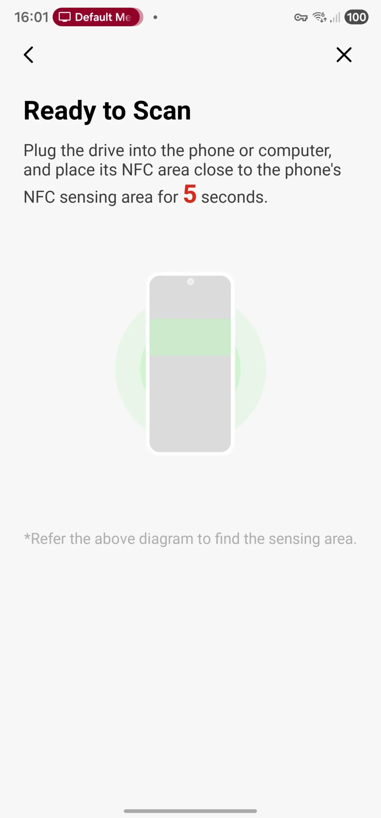

It is a little different from typical portable SSDs on the market. While many include software encryption controlled through an app, the TouchLock utilizes NFC and multi-level 128-bit AES hardware encryption. You still need an app to pair the TouchLock to an NFC-capable device, like a phone, but that"s the extent of it. This also means it is not possible to use it without the encryption, because accessing it relies on unlocking it with NFC, which also unlocks the hardware encryption.

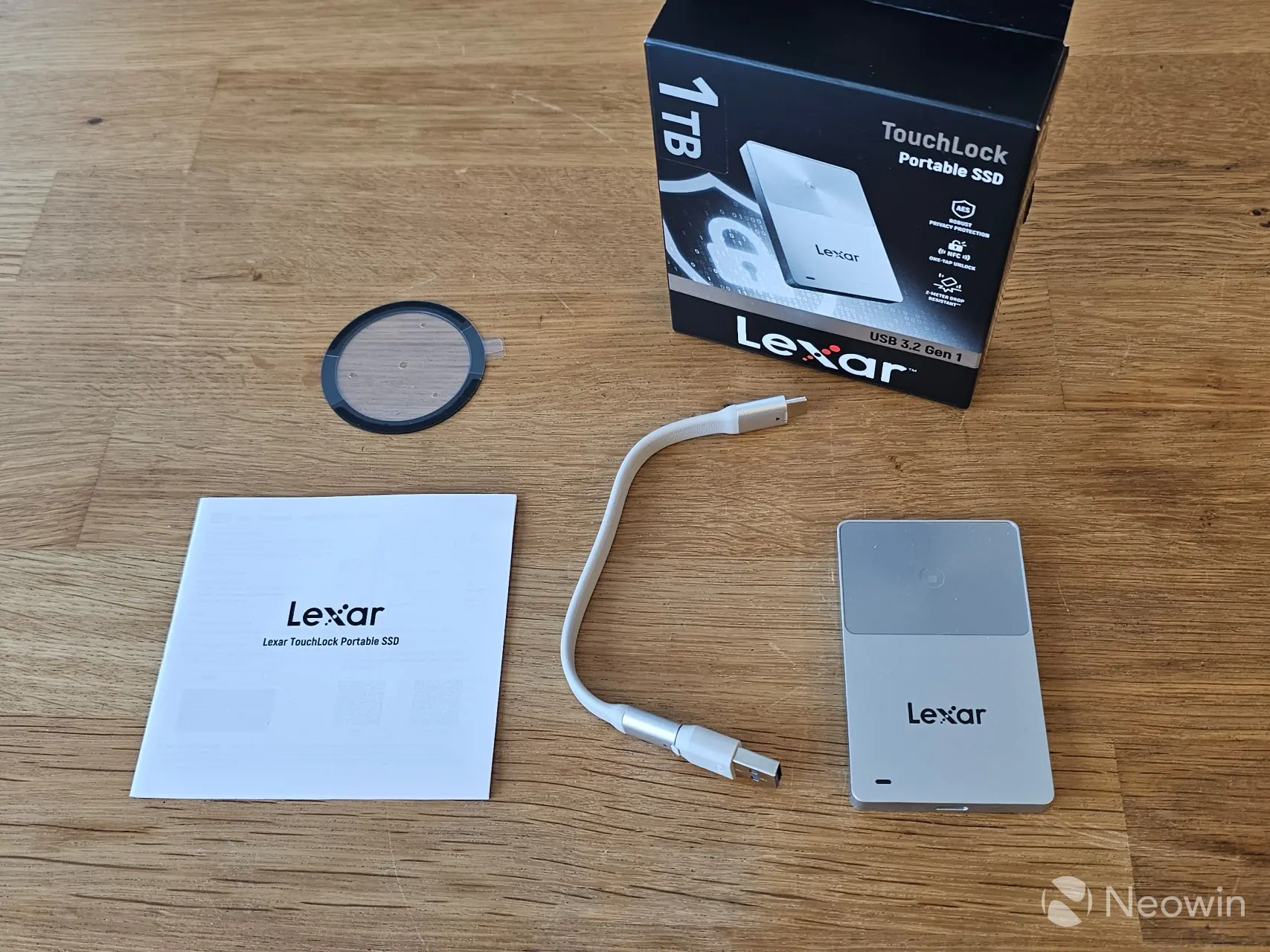

What"s in the box
- Lexar TouchLock Portable SSD
- USB-C to C cable with a USB-C to USB-A adapter
- Metal ring for magnetic attachment
- User manual
The rather compact box has everything you need to get started, it also includes a short USB cable, with one end comprising of a USB-C to USB-A adapter for additional compatibility.

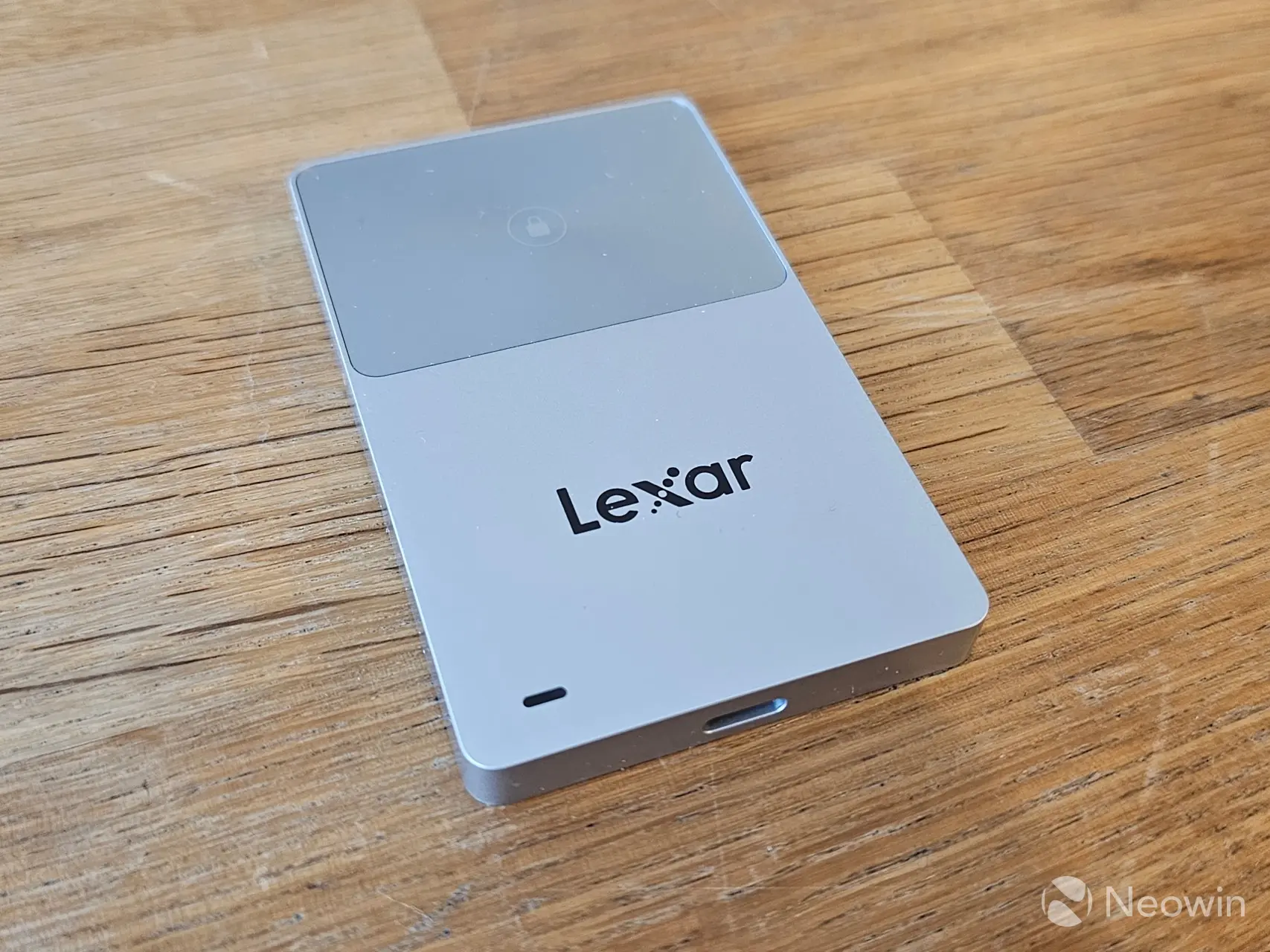

Design

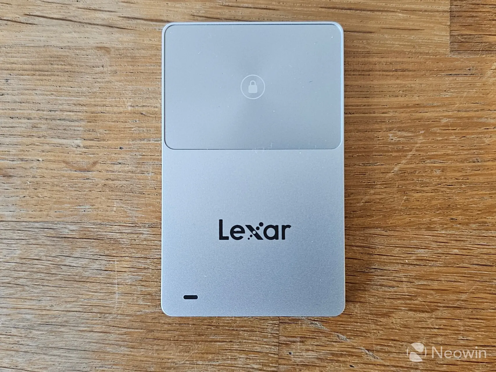

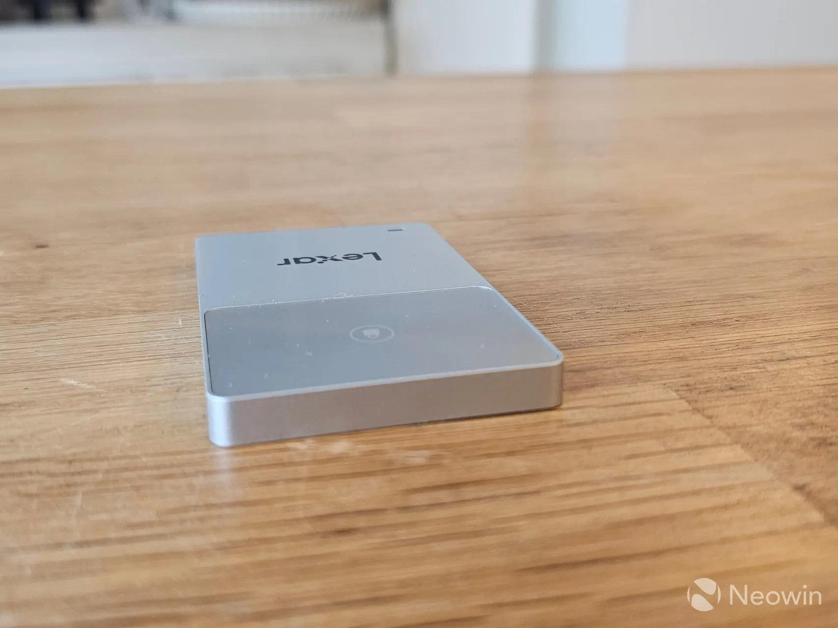

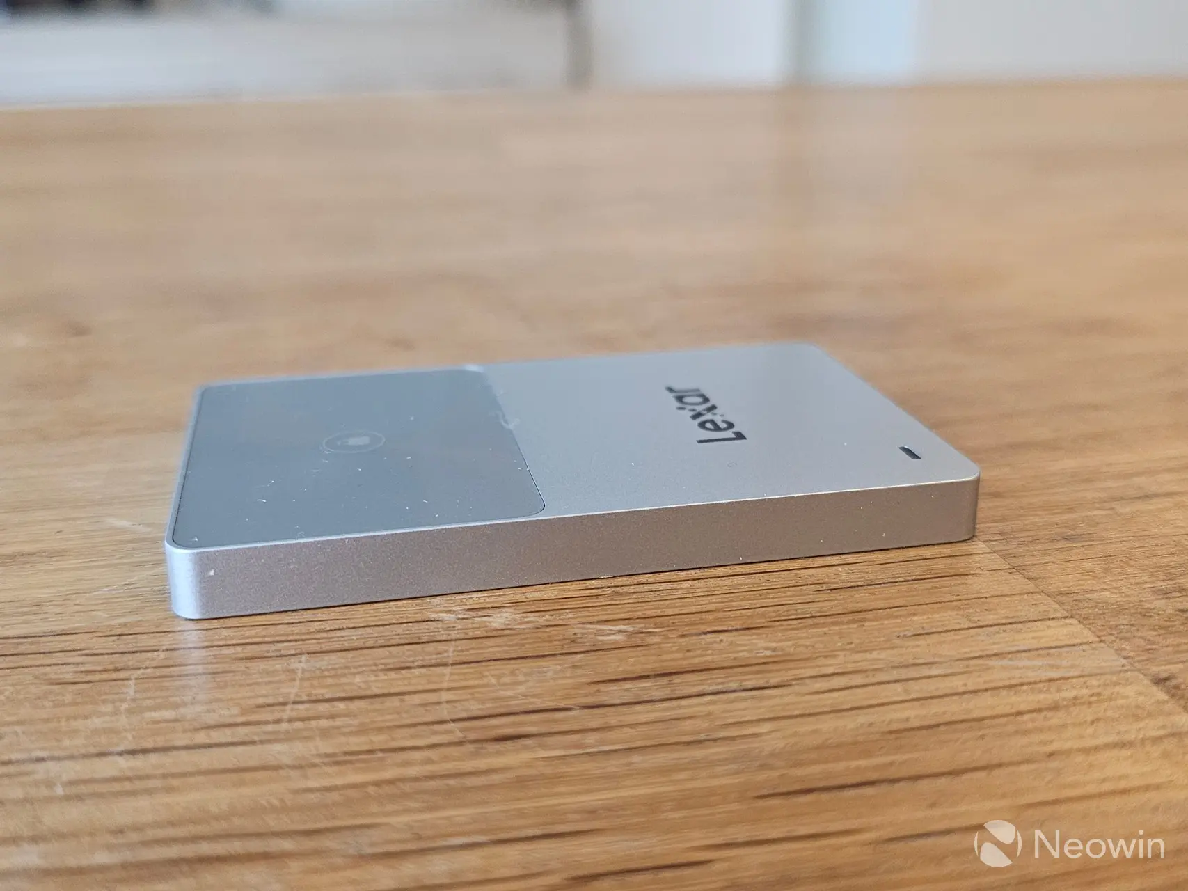

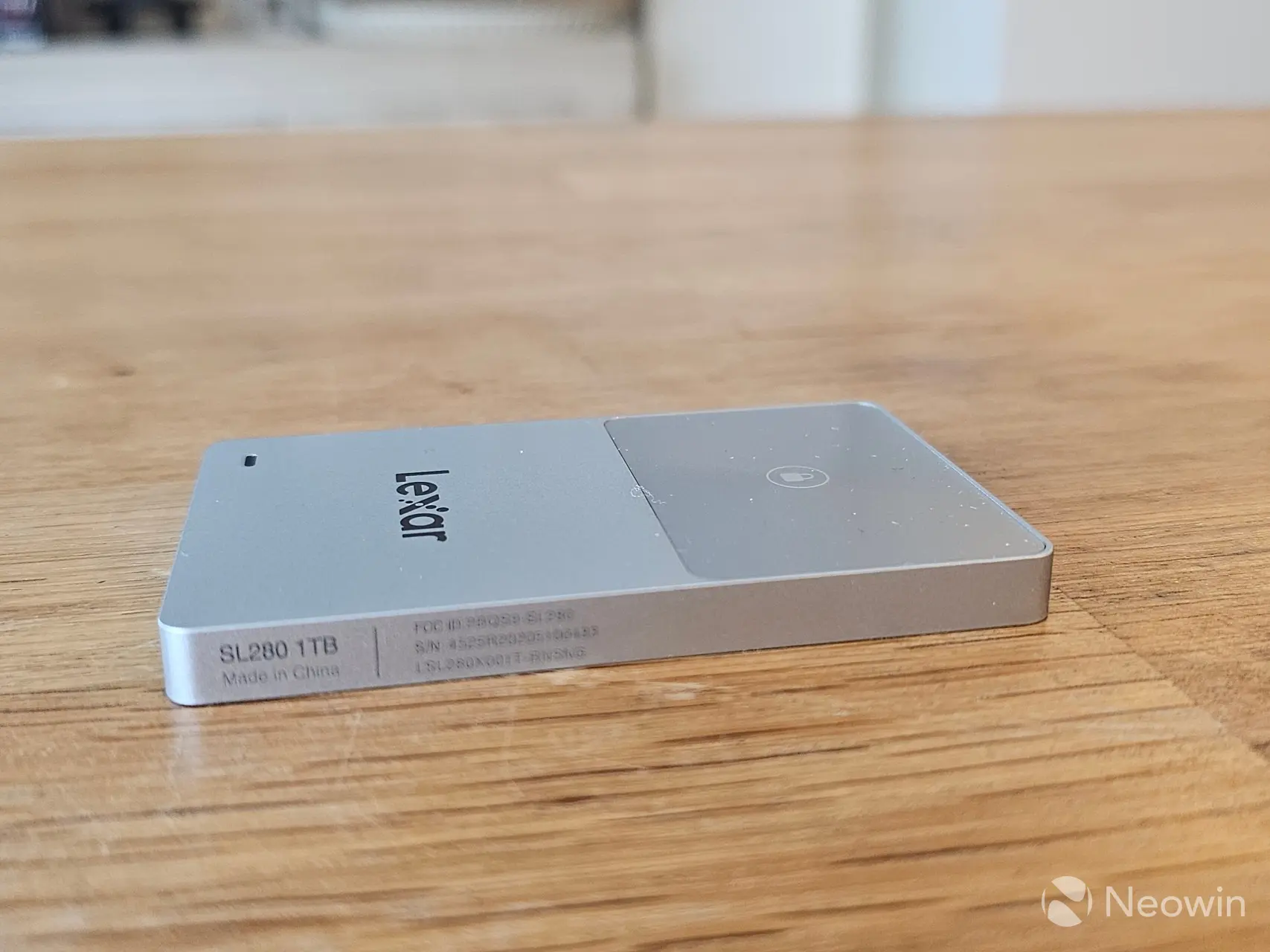

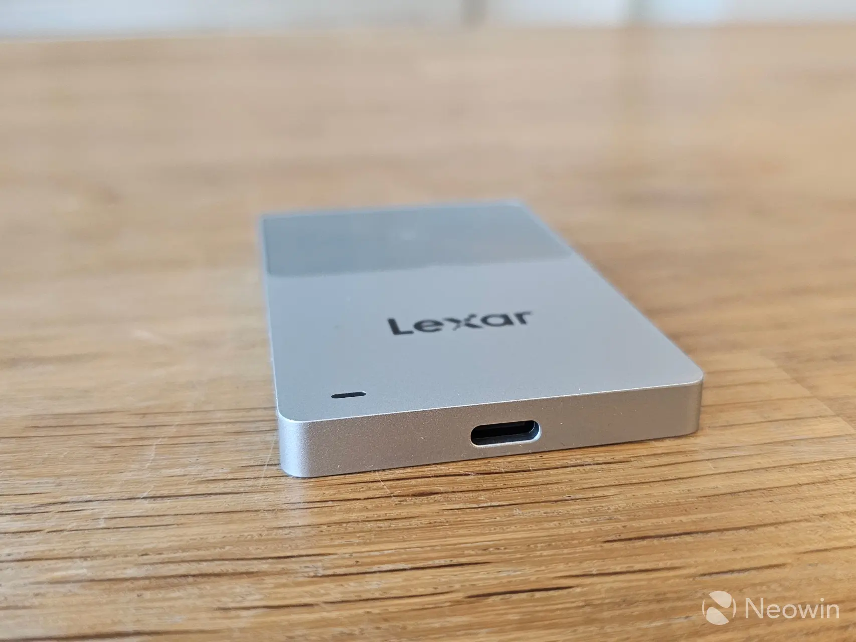

Lexar does not state anywhere on the product page or specifications what materials were used to make it, but at just 40 grams it becomes obvious that it"s a plastic housing, in fact I was able to hear a little creaking upon pressing down on it forcefully; I guess this also why the magnetic ring must be stuck on rather than being able to attach itself.
The branding on the top of the TouchLock looks quite premium, and yes, from the pictures, you could mistake it for being metal, but it isn"t.
There"s only one opening on the sides, and that is for the Type-C connector port. On the right side of the TouchLock, you can find the drive capacity and other information, such as an FCC id and serial number.

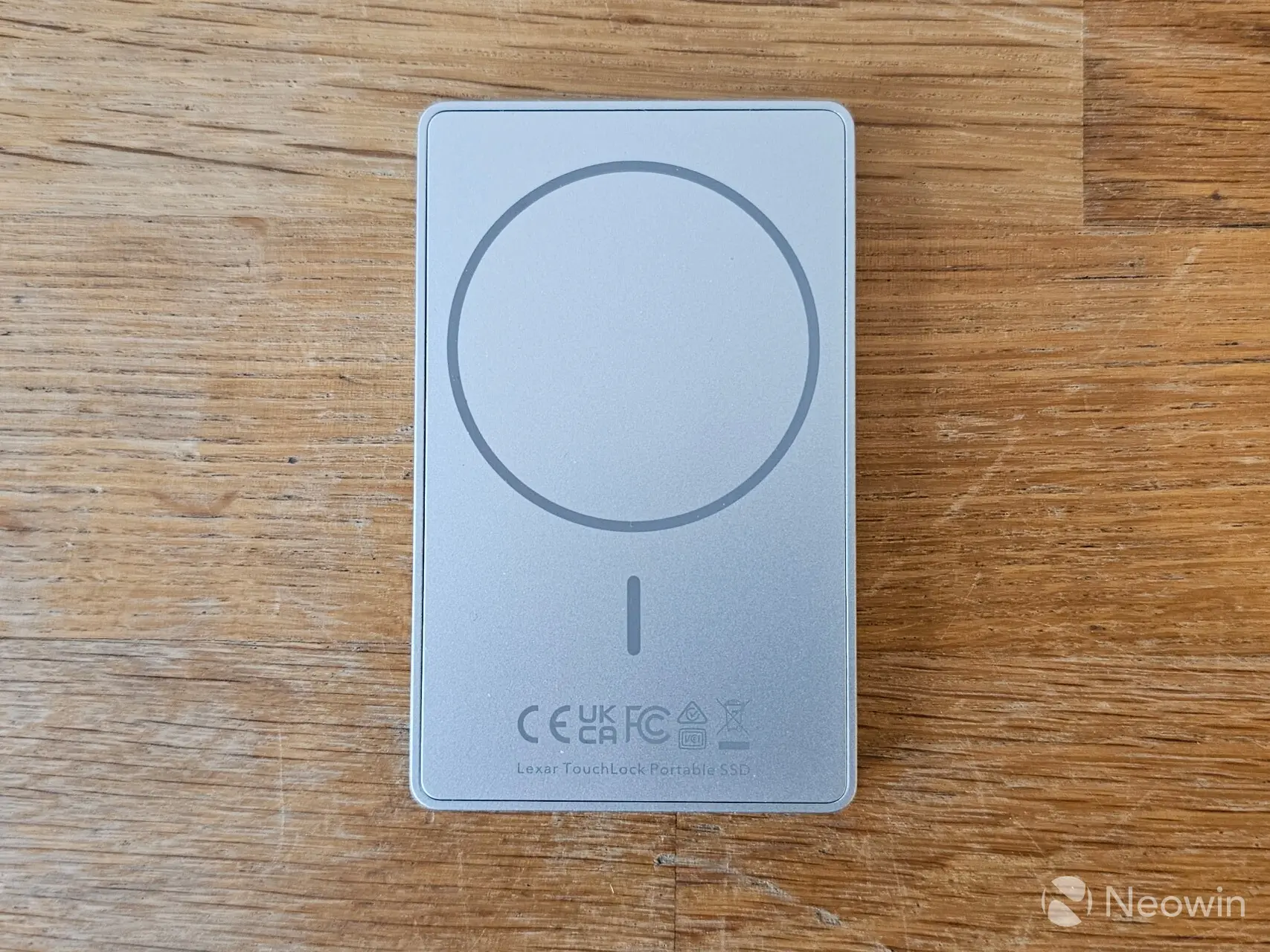

At the bottom of the TouchLock is where you will find all the regulatory safety marks and the product name. There"s also a circle to guide where you can stick the included magnetic circle that will allow you to magnetically attach it to a smartphone.

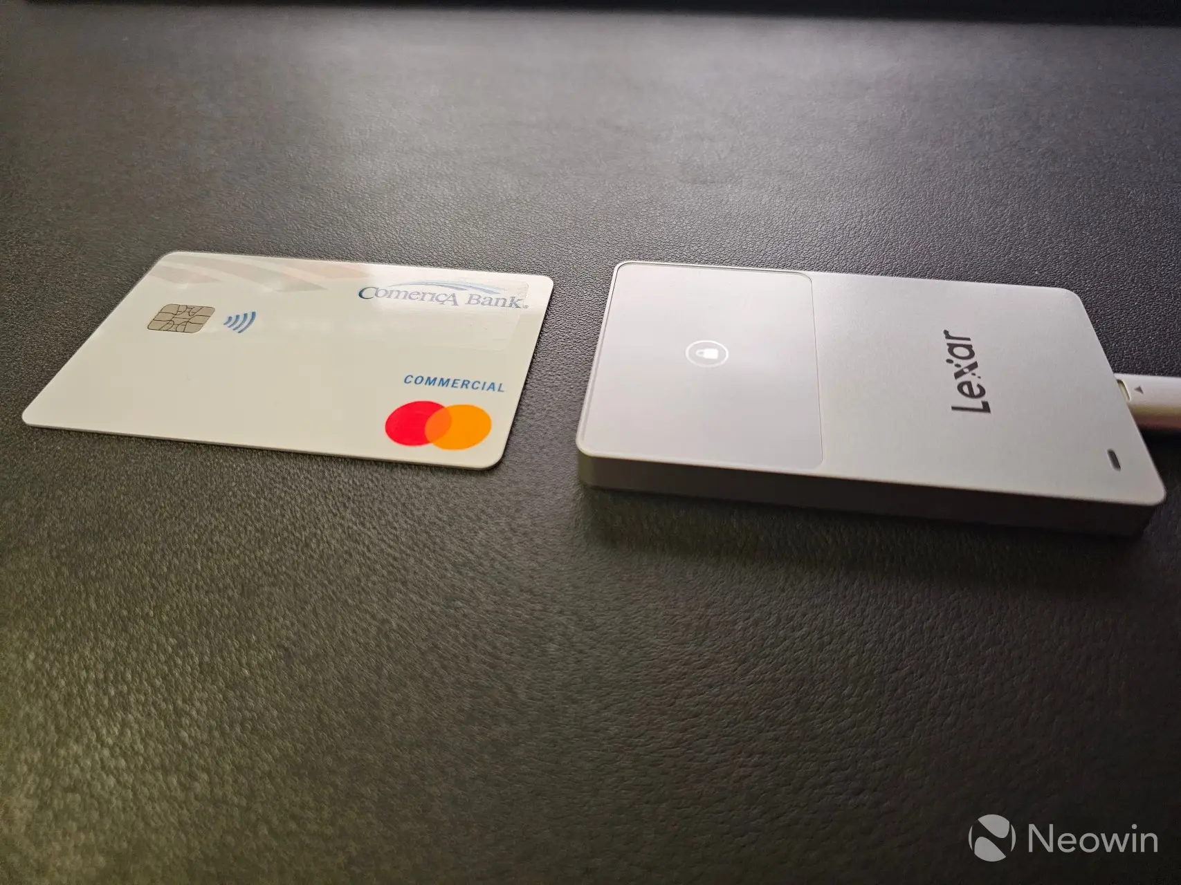

I noticed some reviewers suggested that it was no bigger than a credit card, so it could be stored in your wallet. As the above pic shows, yes, the TouchLock"s entire footprint fits on a credit card, but it is quite a bit thicker! It certainly wouldn"t take up much room in your pants pocket, but I think in most cases it isn"t going to comfortably fit in a wallet; maybe in a fanny pack, bag, or purse, it will be just fine.

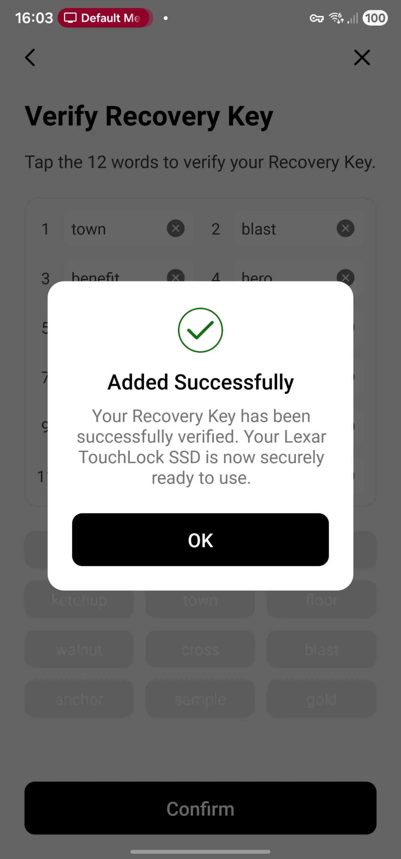

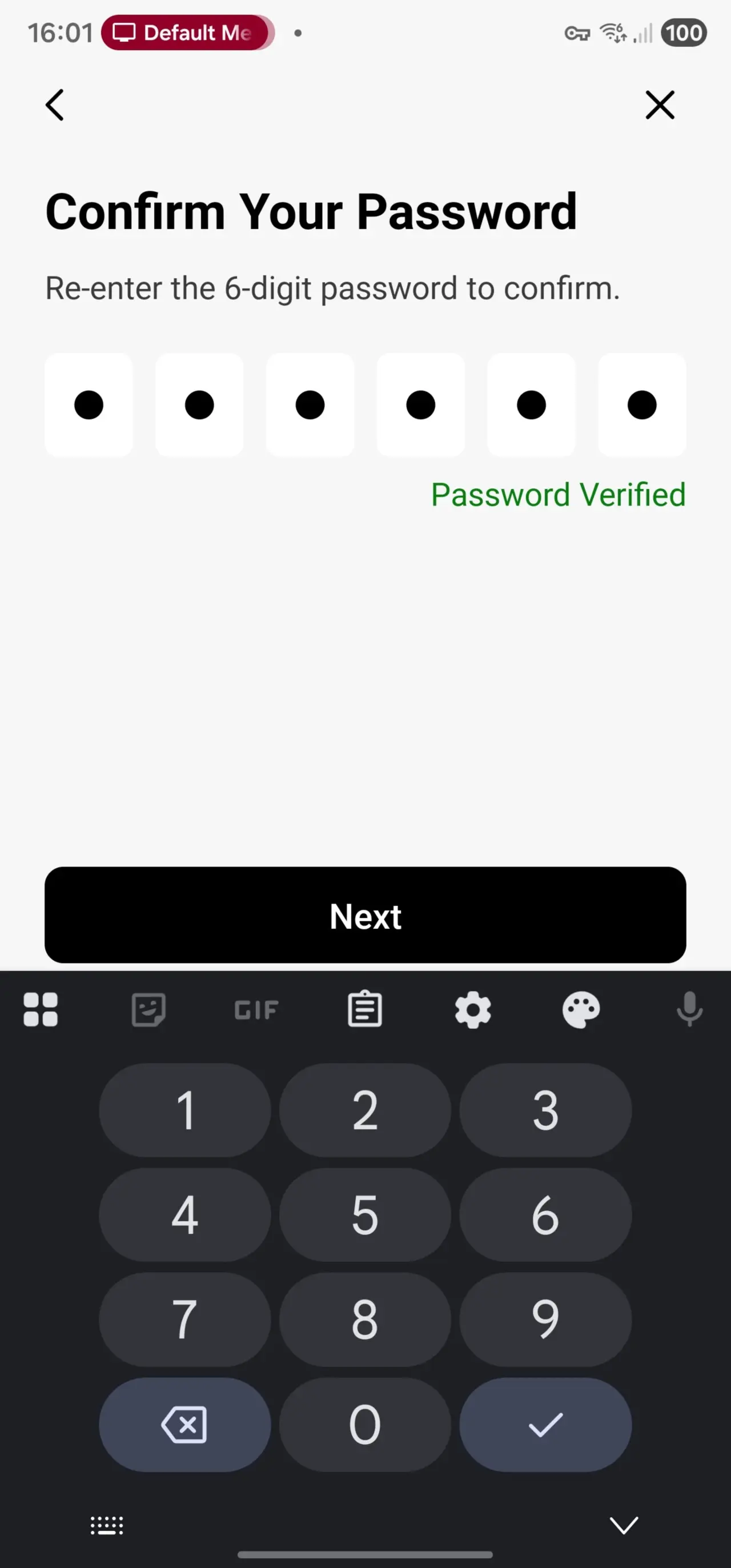

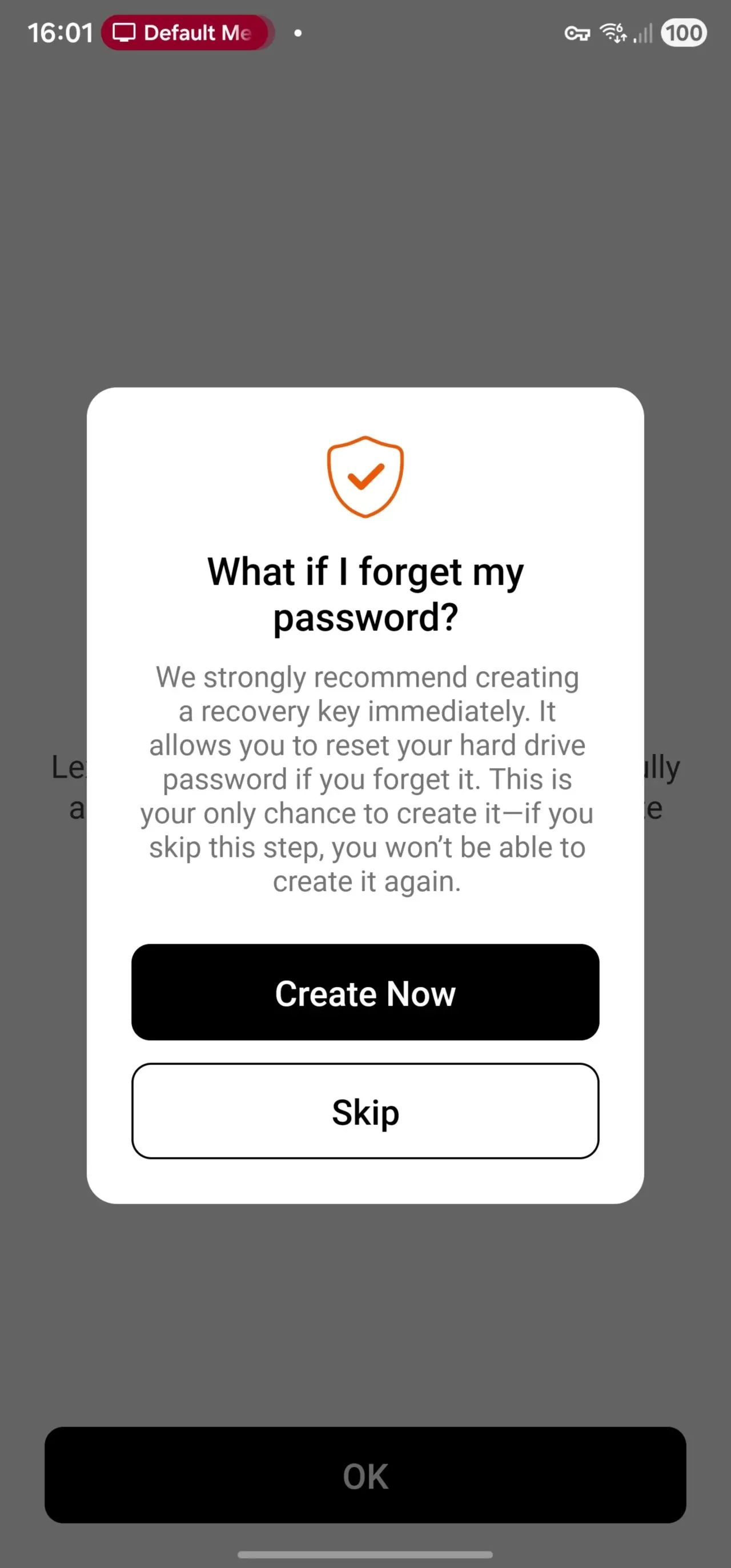

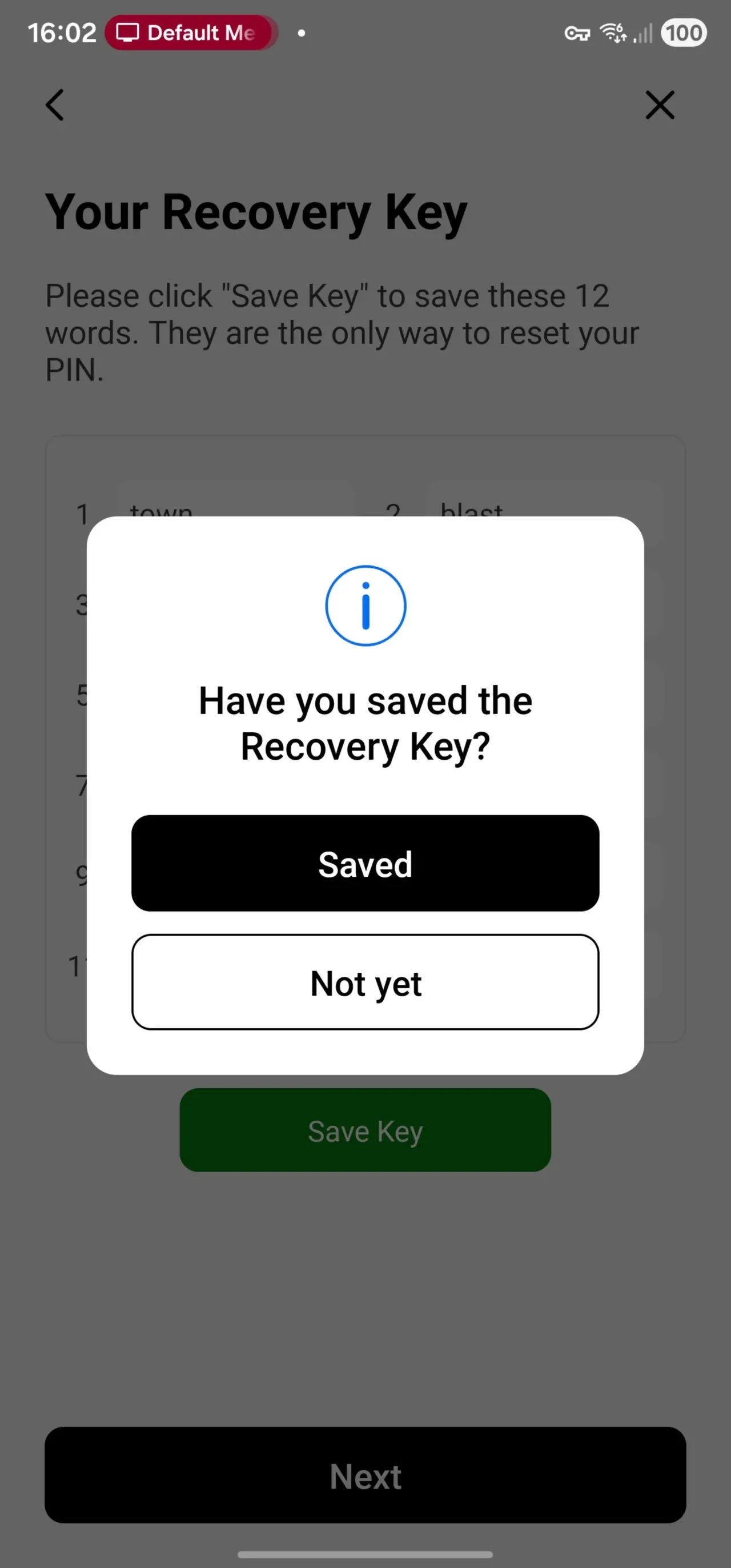

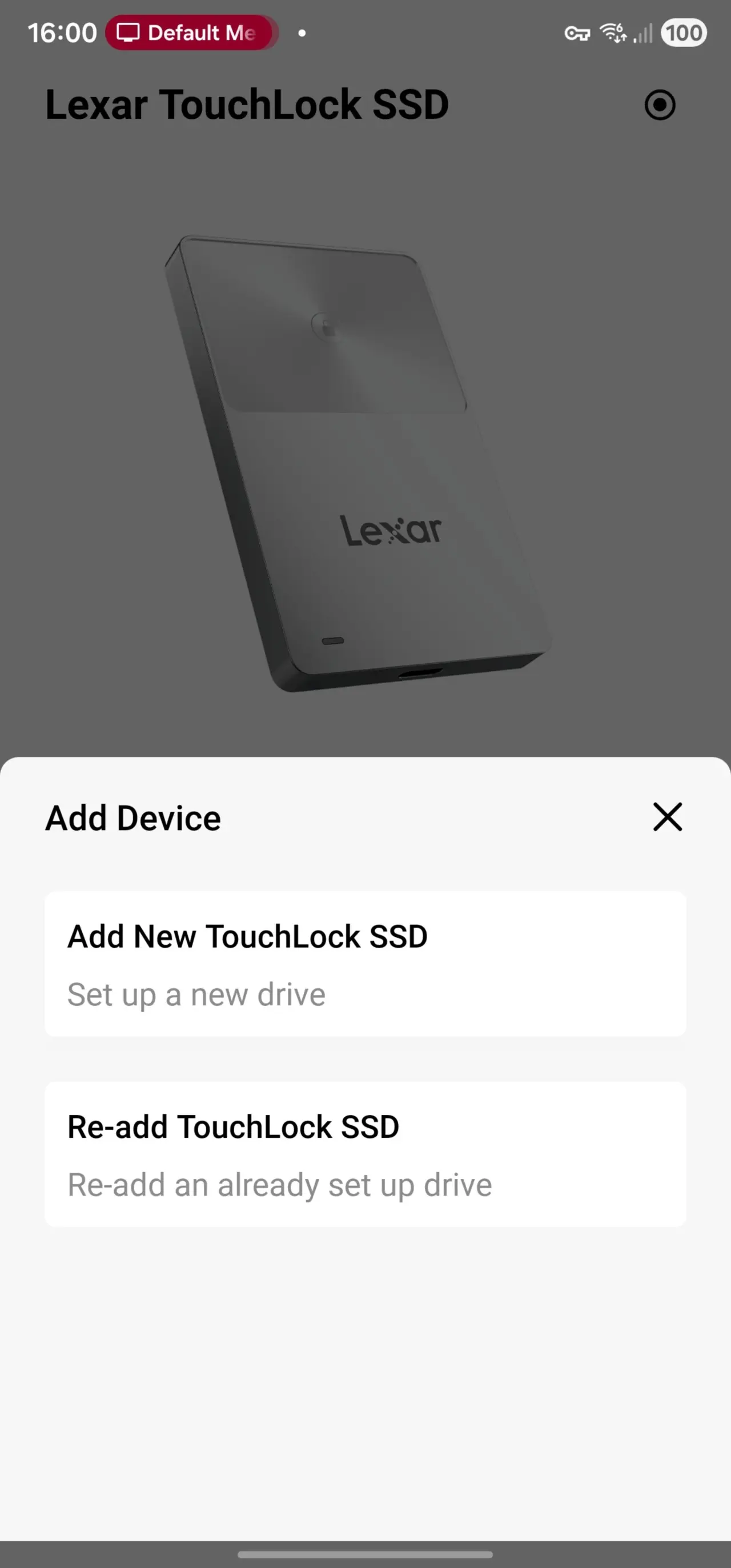

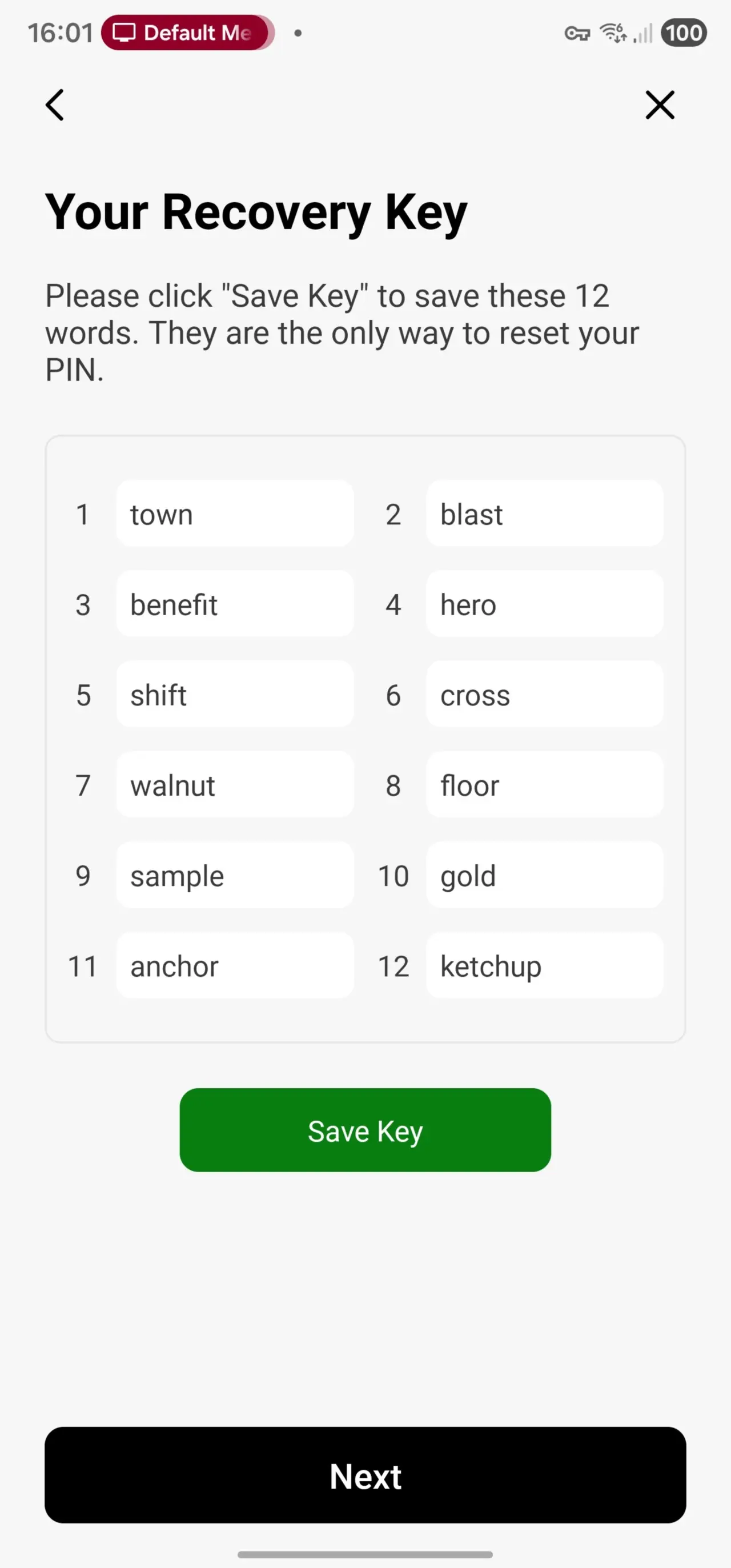

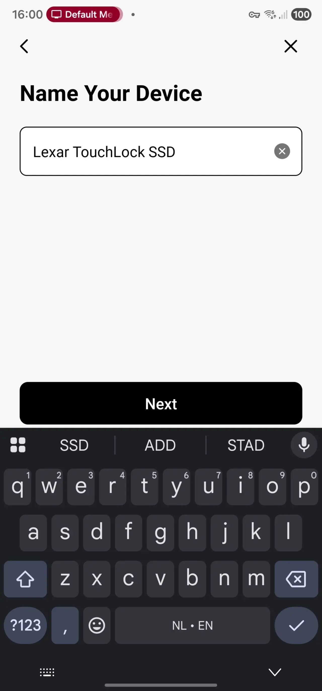

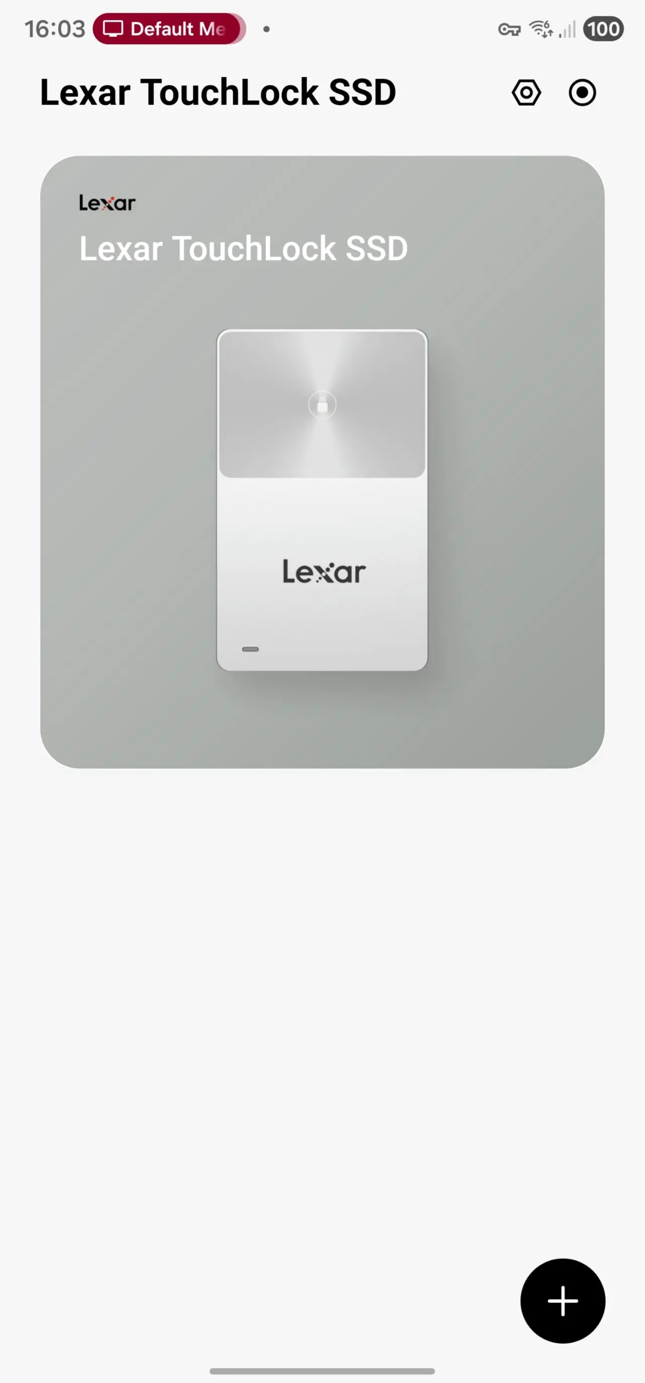

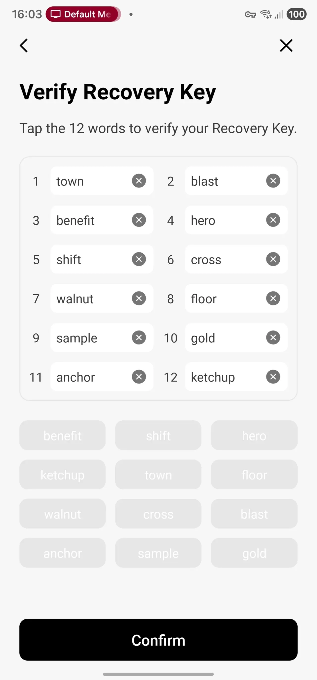

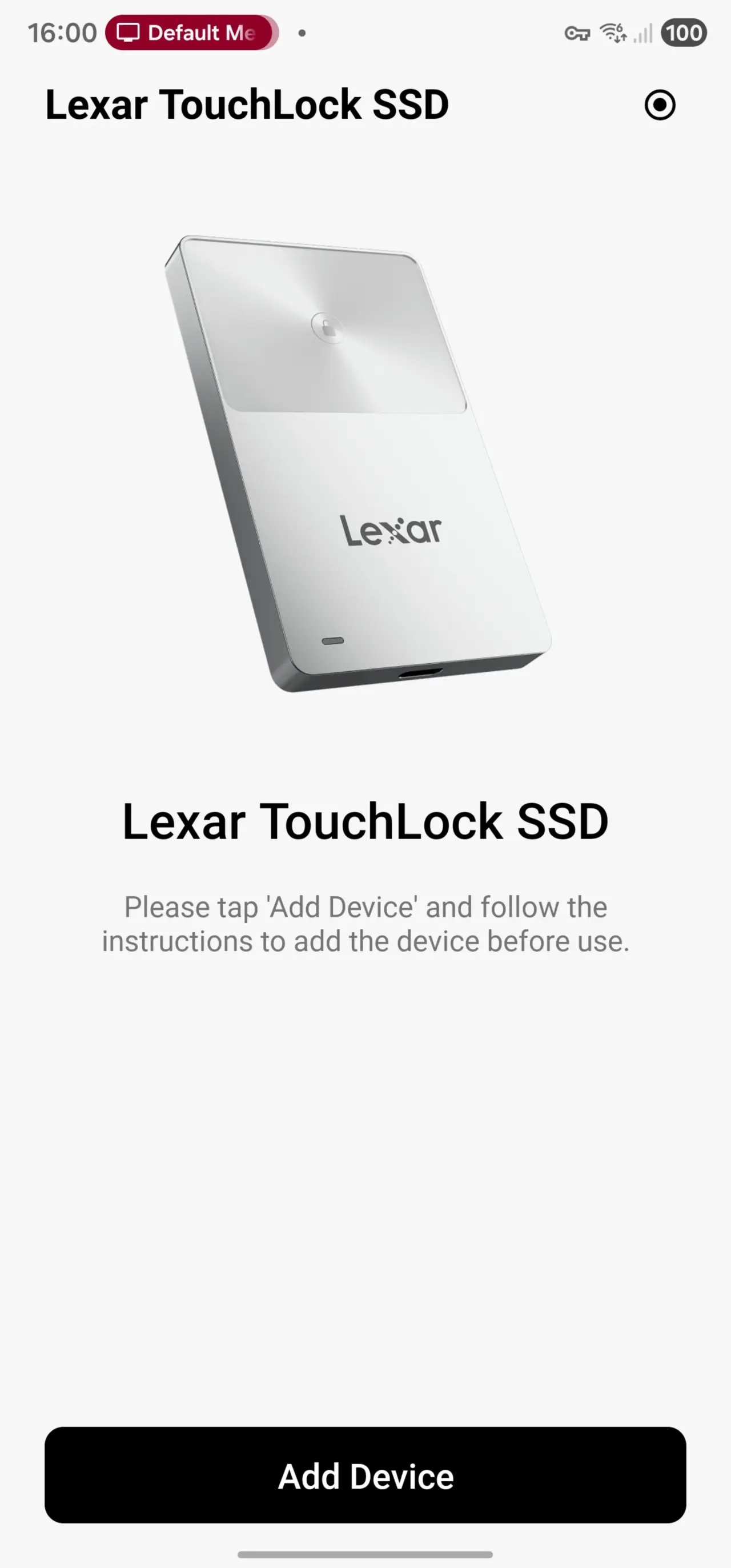

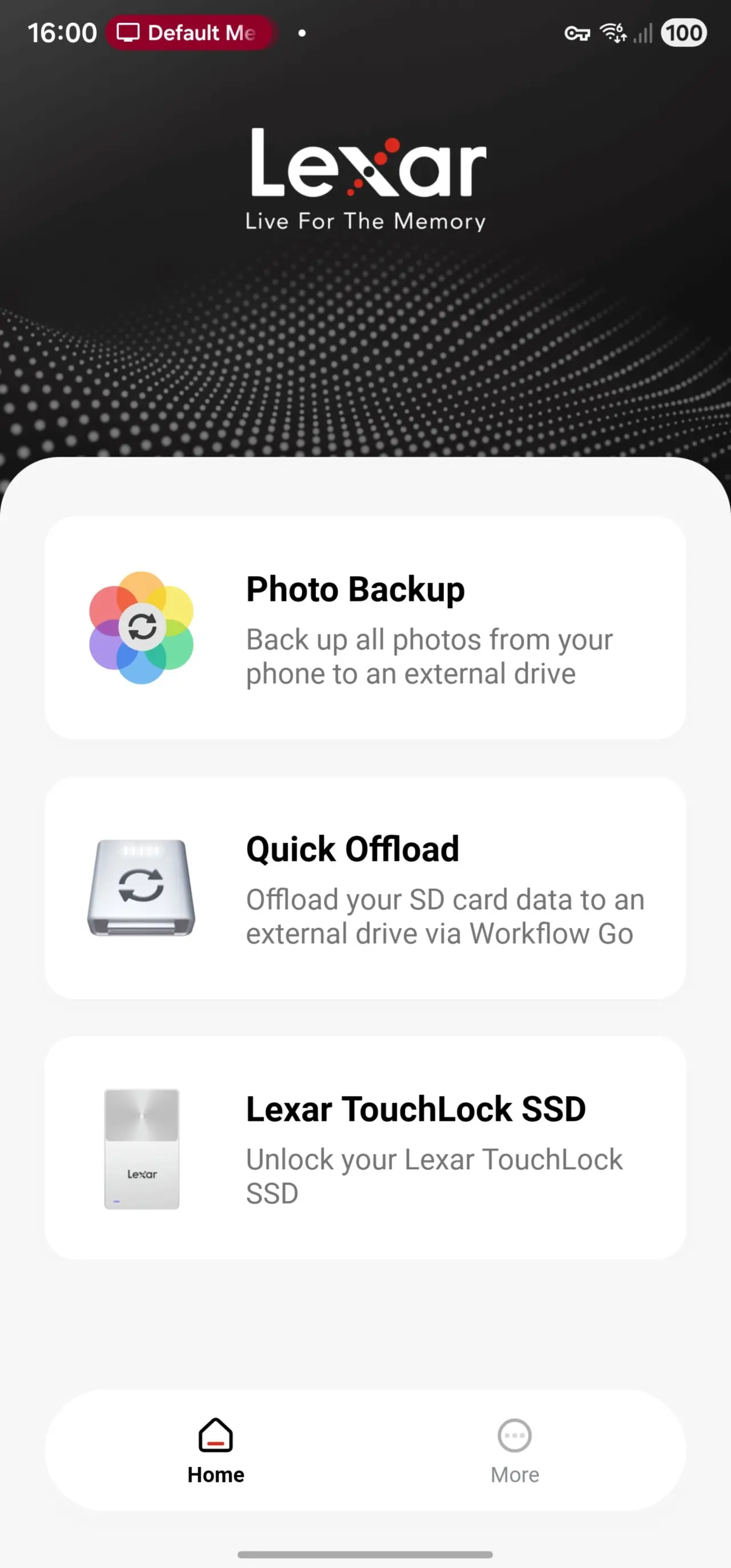

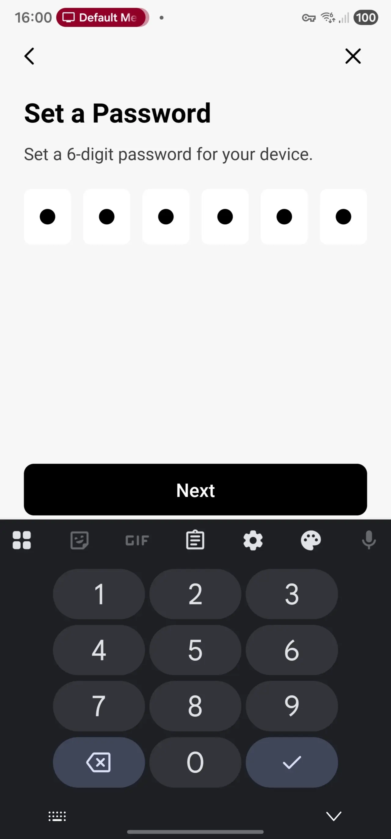

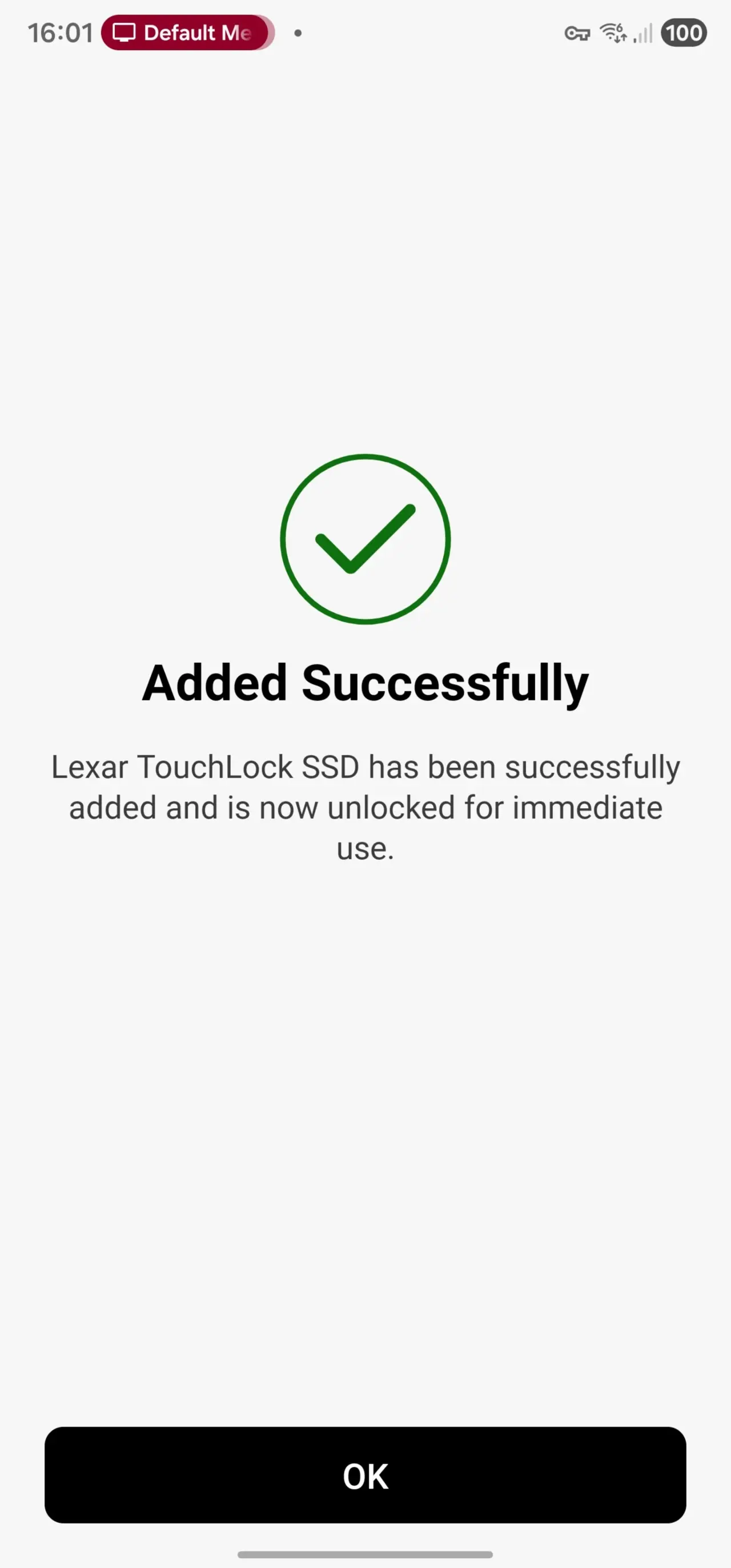

The TouchLock is supported through the Lexar app on both Android and iOS; you will need one or the other in order to pair and use it. Lexar has a video of the entire setup process, but I also captured it in the gallery below, because the video does not include the Recovery Key steps.
Lexar does warn that you must back up your recovery key, because it is not possible to view it after the completion of setup. It can be saved as an image on the device, sent to another device, or shared via an app.

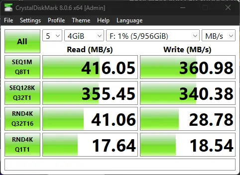

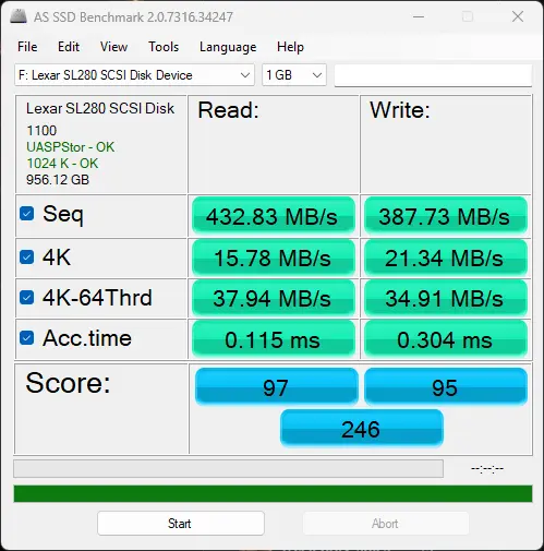

Next, I did a few tests with drive speed and manual copy/delete tests.
| AS SSD | CrystalDiskMark |
As you can see, it didn"t quite manage the write rating of 450MB/s, but it was over (AS SSD) and closer (CrystalDiskMark) to the 420MB/s read rating at 432.83MB/s, and 416.05MB/s respectively.
