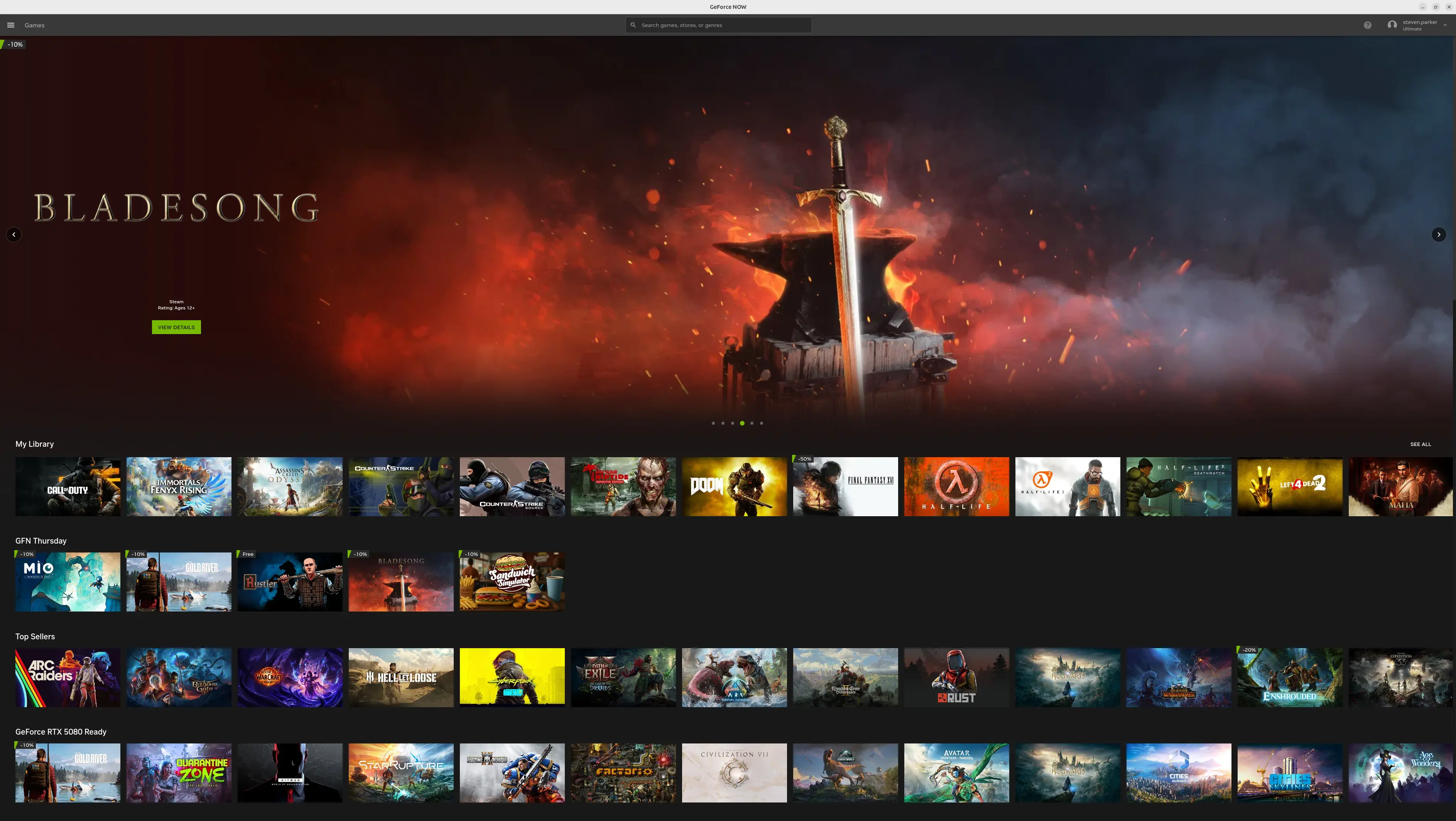

After the installation of Ubuntu, the drivers and the NVIDIA GeForce NOW beta, this is what we were presented with the following. Do note that the monitor used has a 4K resolution, so things look quite small in the screenshot:

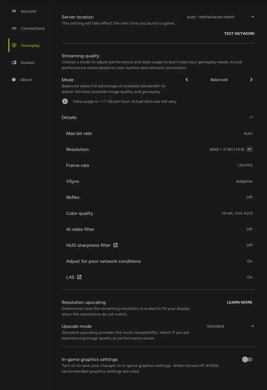

There was more information in the GeForce NOW settings, which showed the frame rate, resolution, filters and so on:

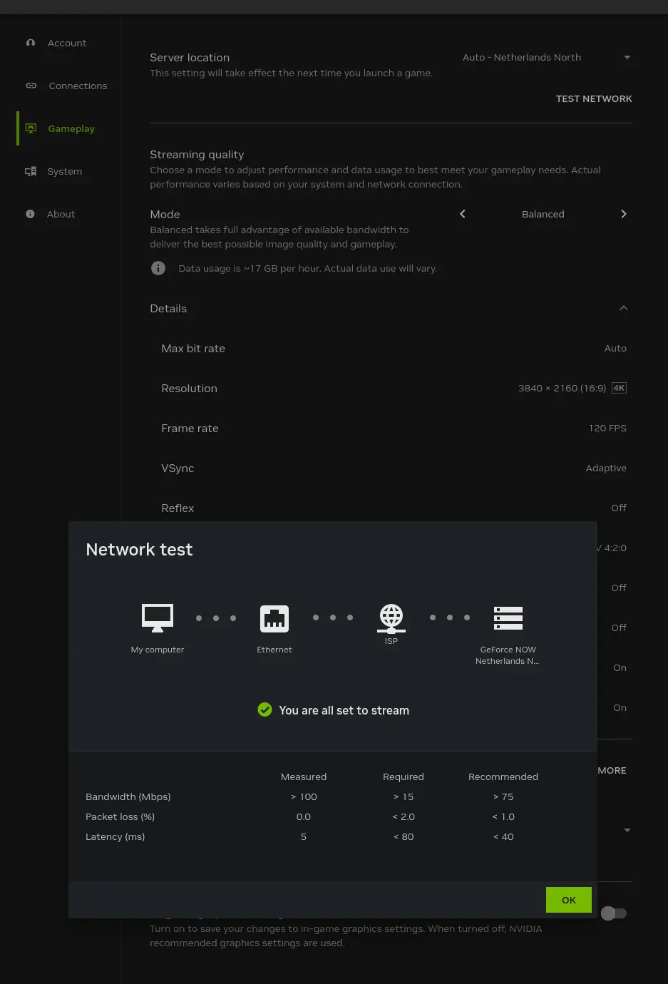

Having a good network connection is non-negotiable for cloud gaming. Here is how the network test tool looks in GFN for Linux:
