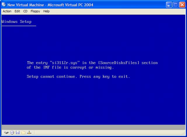

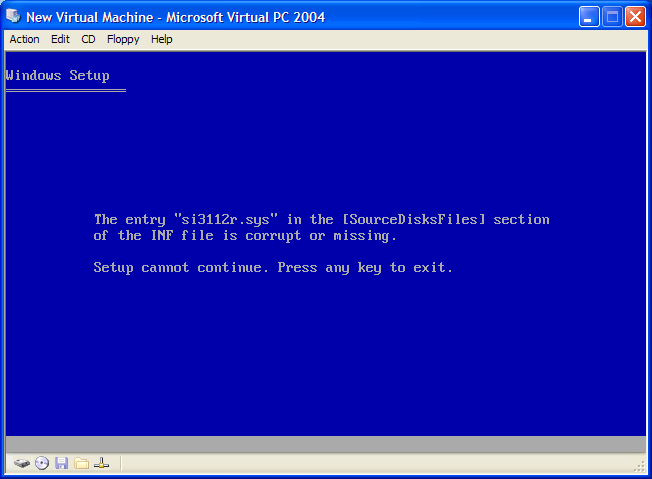

I have a Asus A7N8X-E Mobo and nope, the SATA harddrive doesn't show up.
I've tried some many guides and nothing is working. Keep getting this error:://
I have tried using Nlite to slipstream the SATA driver but I get some ****ty blue screen of death after format, about some missing drivers.
