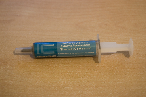

I know a few people that have personally tried it. A common mistake is to put the paste on and then get going rather than leaving it cure for a good few days. After curing the temps dropped further from just running it after applying the solution.

I had the Q6700 doing Prime95 with small FFT's the day before for the paste to cure, when IC say it's two hours if I remember correctly.
Running now with the AC Freezer Pro 7 and IC Diamond, my Q6700 @ 3.33GHz went down on idle by 4c (previous temp with AS5 used to be 44c) and on load by 5c (previous temp with AS5 used to be 65c) (Y)
I'm pleased with the results so far :) Downsides are that the paste is hard (needs warming up through hot water), not free-flowing like AS5 and doesn't spread out using a card.

after 30-60 mins of Prime95, my load temps top 79C on the hottest core. all is stable, but it's so hot... and that's w/ the Megahalems! i reapplied my AS5 last week, but havent noticed much of a difference yet. im chocking it up to bad airflow through the case... not much else i can do for the case.
how did you apply it Radish? it doesnt spread w/ a card... :ermm: :cry:

I put a small 5mm dot of the paste in the center of the CPU, the applying pressure of the AC Freezer Pro 7 spread it well.
Since doing this however, I've switched to a Xigmatek HDT S1283 and had to apply two lines of the paste due to the copper heat pipes. Idle temperatures have gone down further, up to 3c and load temperatures by 2c.
