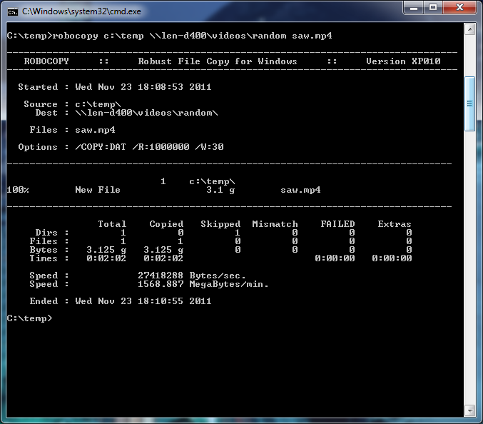

do an actual Iperf test, I sure and the hell do not trust the speed that file copy dialog shows. As to network utilization -- very interesting, but its not showing 450 its showing 360 ;)
Do a simple iperf, and or robocopy file copy -- where you will get an actual timestamp and bandwidth measurement.
robocopy will take into account actually moving a file, so you could have bottleneck with disk, etc. iperf just check the wire or wireless.

Or robocopy is great test since its real world, moving a file!

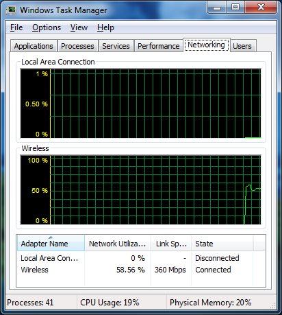

Ok well here she is:
and here's my best screenshot task manager. It was a little jumpy at first too, then it started to pick up on a steady pace.
Pretty decent i'd say :D

Well slap my ass and call me sally! Nice!!! Very impressive to be sure!
Thanks for taking the time to do the test.. Thats a huge file to test with as well..
Was that Ethernet-to-wireless or wireless-to-wireless?

For me too, CPU utilization has been extremely high (always at least 60% or more) during wireless N large file transfers.
That's ethernet to wireless. Wireless to wireless is about 6MB/s max, if someone else is using the machine you can then cut that down some more too.
@BudMan, why do you also not trust the file copy dialog's speed? :)
Not sure why yours was so high - as you can see mine was at 20% with a Core I3 CPU. Maybe your card offloads all the bit checking to the CPU, some cards are "cheaper" and don't do it on the card itself.
