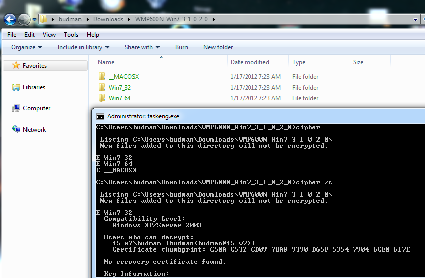

People doing the same freaking thing?? Its not possible for the files to be encrypted to some other key, if they were you would not have ACCESS to even decrypt them.. Have to have a key for that.. So you must of unzipped them into an EFS that would of used your machines keys.. Or you wouldn't have been able to decrypt them, etc.
Well Slap my Ass and Call me Sally!
post-14624-0-54959600-1326811573_thumb.p
Out of habit I used my 7zip to extract -- using the built in tools you are 100% correct the files come out encrypted.. But the folder they extract too is not, only these subfolders and files inside.
Now what is also weird is that stupid _macosx folder.. So this was created on a apple somewhere, or using some form of apple zip tool, etc.
Going to look into this deeper for sure!! And check more files off the linksys site.
I have to leave for work, but not you got me really curious to WTF would cause this?? Its clearly encrypted to my efs cert
