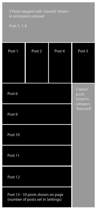

As a premise I need to mention that I'm not a programmer or developer, so my technical knowledge of getting it working is fairly limited. That being said, I've been looking around to get the right type of code (with some tweaking) to get it to work, but no dice.

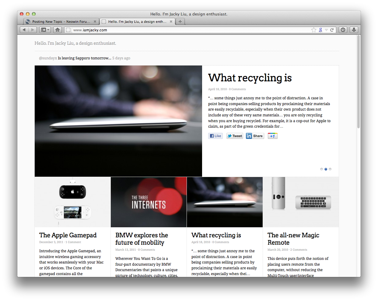

I think the problem is better understood with the attached diagram of what I'm trying to achieve. There's also a screenshot to show exactly what it looks like (you can see how the post is repeated already).
The majority of the problem I have seems to be that there are 3 different post layouts that I'm trying to integrate into the loop: 1) the feature carousel at the top, 2) the middle section with the posts being vertical, and 3) the rest of the posts in horizontal below.
  • Posts can't appear twice on the page
  • The following pages will be a different layout (only the homepage to appear in this layout)
If anyone can help me on this it'll be much appreciated, and I'll try and treat you to a nice lunch via. PayPal.
The existing code (if it helps, but it's all wrong) as a starting point:

7 answers to this question
  • 0
I think what you need is a custom loop in the functions.php file and a home.php file.
Try something like this in the functions file, instead of outputting the articles from the loop put them into variables and call the variables in the home file.

Not sure if will work 100% as is, I'm not an WP expert by any means.
  • 0
<?php $second_query = new WP_Query('posts_per_page=4'); while($second_query->have_posts()) : $second_query->the_post(); ?>[/CODE]
You need to do something here to exclude the posts that are tagged "starred". As it is, this query just returns the four latest posts.
This example should help you sort it out: http://www.jepson.no/how-to-exclude-specific-tag-from-query_posts/
