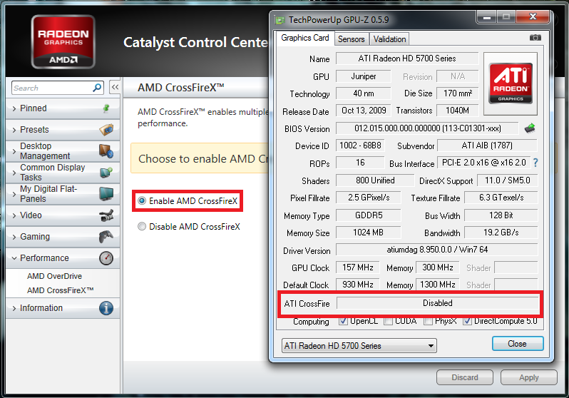

UPDATE 2: Been doing some research and it looks like Crossfire may not be working properly. It's enabled but GPU-Z says it's not (see screenshot). Is this normal or is it indeed broken?
https://www.neowin.net/forum/topic/1063112-ati-hd-5770-driver-crashing-issue/
