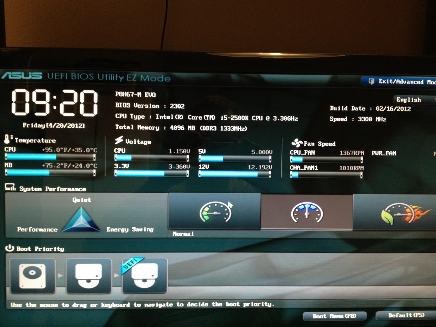

I looked more closely at the board. There wasn't any scorch marks anywhere. The CPU fan was still spinning. Also, the smell really could've been anything since this is a multi-unit townhouse. I just mentioned it "just in case". I attached a pic of the main setup page so you guys can see the temps, voltages, etc.
I'm wondering if it could be the HDD. Like I mentioned before it does NOT shut down as it would in a overheating case but, it does come back on, on its own and tries again. This happens right after the reading of the HDD begins.....every time. It doesn't matter if I'm trying to load Windows already installed or when I try to boot from the DVD...loads the Windows files and begins to read them. What do you guys think?

All those reading look spot on, have you checked the event logs ? Maybe there will be an error or critical log around the time of the reboots
