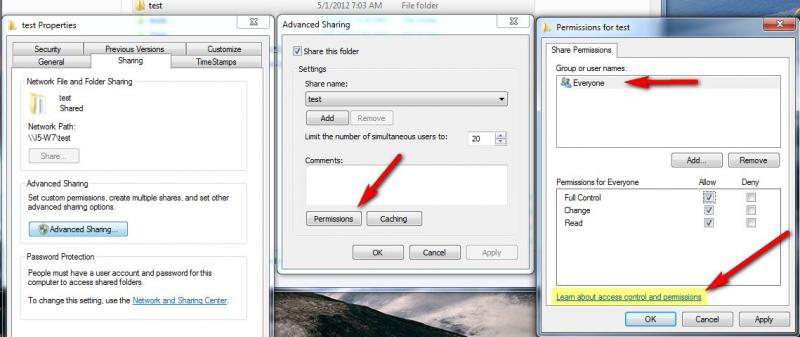

EDIT: ok I think I did it. Don't ask me how exactly, but I can simply go properties>sharing>advanced sharing>share this folder and I can access files between with all machines.
That's good enough for me.
Thanks BudMan & others for your help!
"I can simply go properties>sharing>advanced sharing>share this folder and I can access files between with all machines"
Yup that is how simple it is suppose to be!!
And what share permissions are listed there?
post-14624-0-77768000-1337341879_thumb.j
