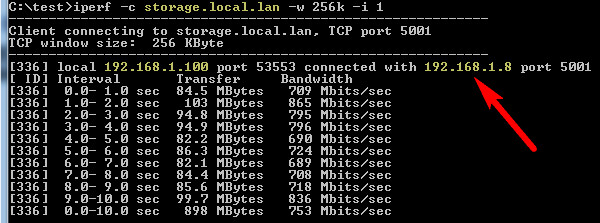

So you feel you need to hide your Private IPs from the world?? You do understand that 192.168.x.x, 10.x.x.x, 172.16-31.x.x are private addresses and don't route on the internet.. Can not find anything about you if you would of shown those ;)
so for example here
Does anyone knowing that my machines are on 192.168.1.100 and 192.168.1.8 tell you where I am? Or in anyway allow you to talk to my boxes over the internet? What about storage.local.lan -- since .lan is not a valid tld, and local is generic.. Does that give you any privacy concern info?
