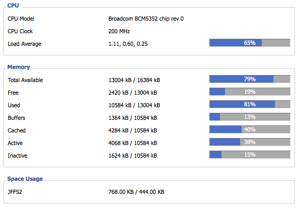

These are my stats for the router:
Basically - after reading the JFF2 support, I know I can erase that to get a total fo 2,048kb of storage available, but not going to gain much otherwise.

I am guessing this would allow more space to be added to the router's JFFS2 system and therefore allow it to install the proxy.
But how much space to you need for that package? And I know you can install them to smb shares and mount them. I have not played with that in a long long time. But I do recall doing it, that should work - do you have some nas or server that you can use to mount some space?
