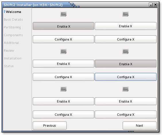

Adding another tab would really be ass-ache :p The other 2 tabs both currently look like this;
