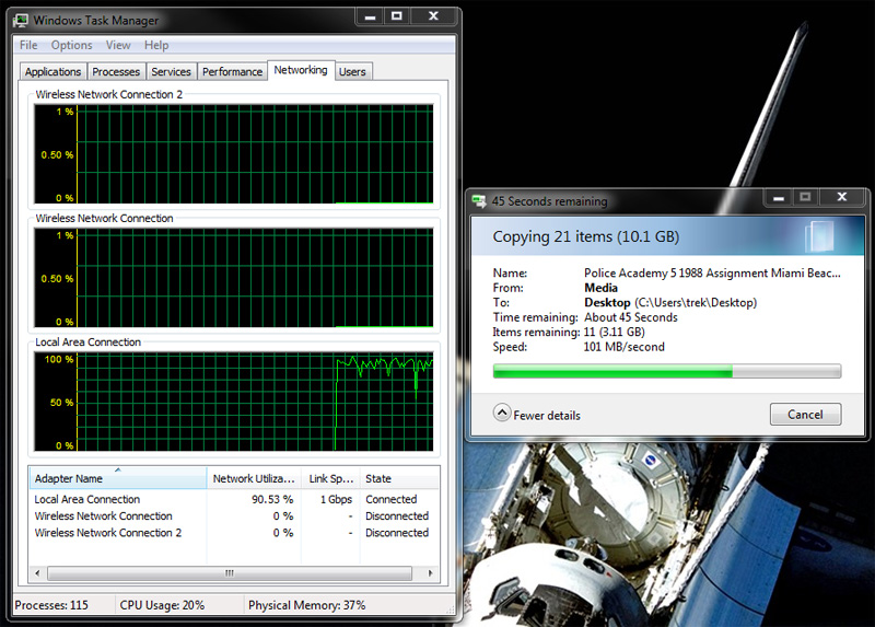

When moving large files I normally see 50 to 90 MBytes per second.
Sounds like cache on HDDs or something not being able to keep up.
Then again on my 1 Gbps network (Linksys E4200v1 router/switch) I can push 90-100MB/s straight (then again my laptop has a SSD to my NAS which are big 2TB Drives). At work from my machine (standard Office desktop) to the Server (SAS RAID 10 Drives) I get about 50-60MB/s off a WD 250GB 7200RPM HDD.
