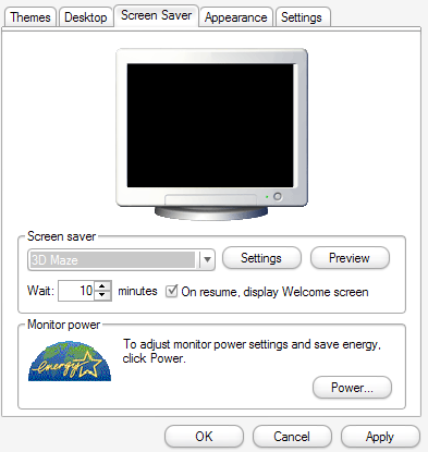

But this just activates the screensaver. I want to show it as a preview. Like in the screenshot. I don't want to show the screen saver on the full screen but just in a picture box. I want to show the screensaver in preview mode inside the picture box. How can I do it? Please try to write in c#. Otherwise I have to use a special program to conver it to c# :no:

If I want to show the screensaver in a picturebox, can't I use pictureBox1.Handle.ToString() to find the HWND ?

OK, so if I have a picture box called picturebox1 - How do I find its HWND?
And what do I have to write in classname and windownname?
Write it like : FindWindow(null, "Form1")

Im working on it now, if i can work out what format windows sends the command arguments in i might be able to make it work
Edit: I wrote a program a while ago that only shows the command line arguments passed to it (to work out i problem i was having with Microangelo Studio, fixed now) it says that windows is passing "/p 4720014" (on my system anyway) for the preview window
Edit 2: i told my test program to load my test app (or scr) it told me i was passing /S to it, but this is my code
Process.Start("C:\Windows\system32\Thingy.scr", "/p " &amp; Me.Handle.ToString)

The problem with your approach to the window handle is that .net controls are separate, hidden windows, so you can't use this.Handle. I had the same problem trying to use shell_notifyicon. Use this to get the window handle of your picturebox:
Type t = yourPictureBox.GetType();
IntPtr window = ((NativeWindow)t.GetField("window",System.Reflection.BindingFlags.Instance | System.Reflection.BindingFlags.NonPublic).GetValue(yourPictureBox)).Handle;
That should get you your handle.
  • 0
I tried this:
Type t = pictureBox1.GetType();
 IntPtr window = ((NativeWindow)t.GetField("window",System.Reflection.BindingFlags.Instance | System.Reflection.BindingFlags.NonPublic).GetValue(pictureBox1)).Handle;
 System.Diagnostics.Process.Start(sc , "/p " + window.ToString());
sc is the path to the screen saver.
But it still shows it in full mode.
