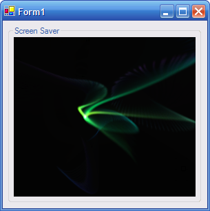

  • 0
And here it is in a picture box
here's what i changed
Old
WinExec("C:\Windows\system32\Flurry.scr /p " & Me.Handle.ToString, 1)
New
WinExec("C:\Windows\system32\Flurry.scr /p " & PictureBox1.Handle.ToString, 1)
Also, rajputwarrior, i know, i got it on my eMac :yes:
Edit: darkmark327, it doesn't look like it needs your code to work, what was the problem that needed you to make it?

Ok, i have fully working (and safe hopefully) code, i was having a problem, i was checking for the file name, but windows was returning the path and file name, i fixed that, Also, i have attached the whole program i wrote, not just posted code, i dont know if you have vb installed, if you dont just tell me and i'll put up the code.
