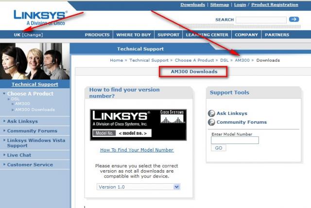

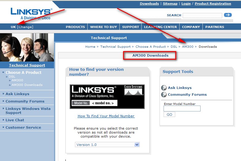

The article linked to above about the issue has a listing of modems on the bottom.. example
http://www.wlug.org.nz/Half%20bridge%20with%20PPPoA
The following ADSL2 modems are reported to have better than average half bridge implementation:
* Linksys AM300 (Firmware 1.19.04 )
i think the AM300 is a New Zealand based product, as i can't seem to find it on the Linksys UK site or on the usual E-tailers websites (well the ones I've tried are Dabs.com, Scan.co.uk, ebuyer.com or amazon.co.uk), but only one the New Zealand Linksys website
