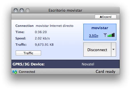

Well, as the screenshot shows, I've got about 60-70% signal and have been in plenty of places that provide full signal.
The confusing thing was that when I first got the device it was easily running at the sort of speeds I would welcome from a Virgin Media DSL line, 2Meg was pretty damned easy to pull in, but it's slowly slowed down and now it's at turtle speed.
A few of the locals said it might be because it's the weekend and lots of people are using their mobiles, but I raised an eyebrow at that thought. I mean, 3G in the UK more or less runs the same speed off my iPhone 24/7.
Signal for sure isnt the issue. But like I said, i'm not looking for a fix i'm looking for ways to improve what little i've got.

Well, I specifically got this package because it dictated "Sin Limite" or in english "Without Limits".
I'm fairly sure this isnt some kind of bandwidth cap, if it is then I'm bummed because the maximum i've downloaded is 100MB and i've got to put up with it for at least another two weeks :(
I think paying 49 Euros a month of something with a 100MB cap is a little retarded, anyone else agree? Well, I'll do a little more research into it and if it indeed turns out to be a cap then i'll phone up the bank and cancel the direct debit, I signed an agreement that stated No Limits and if I'm being limited then they obviously aren't providing me the service I agreed on. I'm legally sound here right?
So, anything I can use to help speed things up? What about Google Web Accelerator?

Hey vegetrunks, I'm from Argentina and I found this thread looking for some way to improve my 3g transfer speed. I was in a similar situation than yours (claro, 3.5g, low speed)
What I did was to disconnect from the internet, then went to options and under network selected "WCDMA only" pressed apply and restarted the computer.
That worked for me so far. I hope you have better luck if you still have the service.
