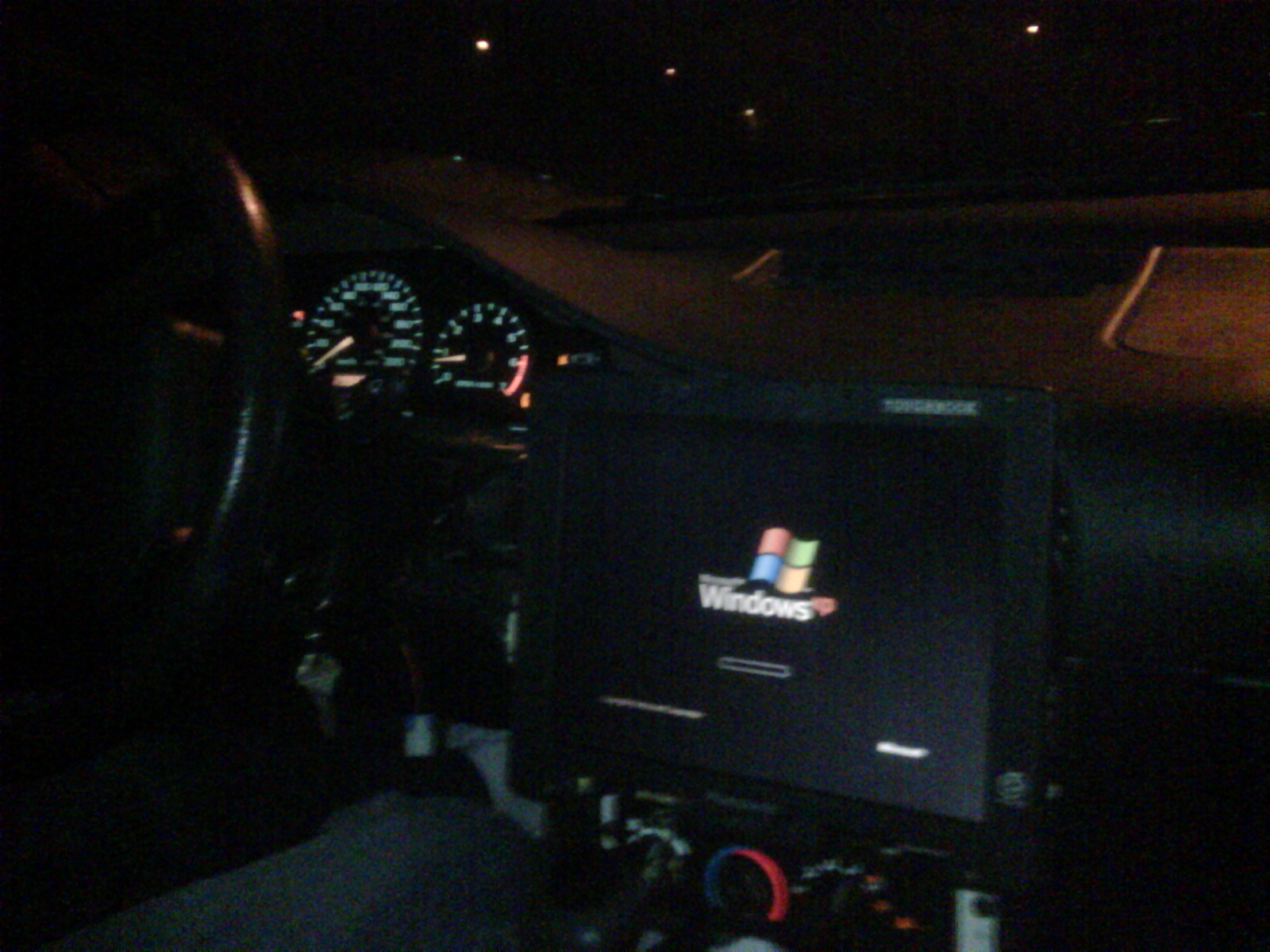

So, just an update. I managed to do it. It took a couple tries, and a few hours to do.
- I installed DOS7.1 on the hard drive using the physical laptop drive in VMware Workstation. (On a separate PC)
- I then copied the entire contents of Windows 98, and Windows XP disks into separate folders on the drive.
- Installed Windows 98 using DOS.
- Then upgraded to XP by running the setup in the XP folder on the drive.
Since it worked I didn't feel the need to do a fresh install.
I did however make a custom XP CD using nLite, just because I think a full install of XP and all its features would slow it down. The toughbook is only a Pentium II with 192 MB memory.
The Screen and Laptop are separated, the rest of the Laptop is sitting underneath the dashboard.
