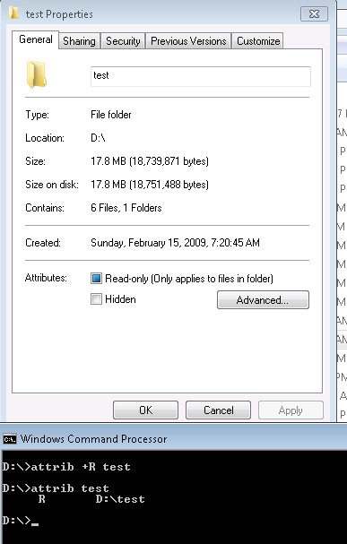

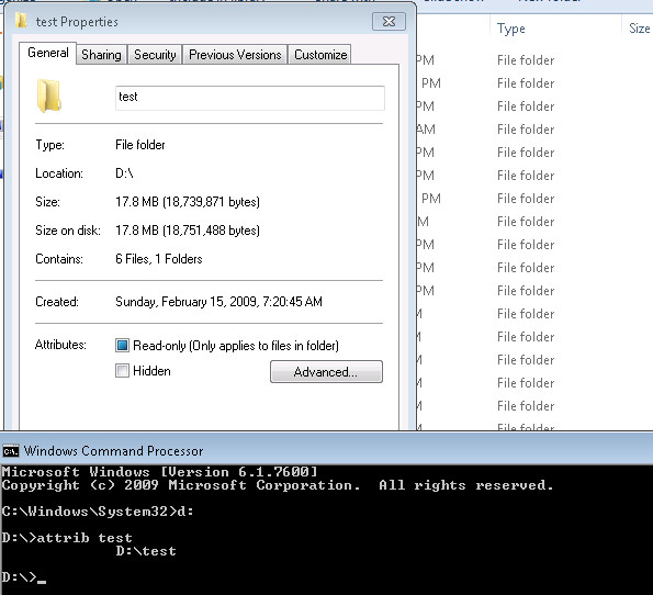

+BudMan MVC Posted December 4, 2009 MVC Share Posted December 4, 2009 "I've just noticed all folders are read only" Not this again!! No they are NOT -- your most likely reading the tri-mode flag box wrong.. Windows really doesn't even use the readonly attribute on folders anyway I have gone over this so many times over the years I have lost count.. NO they are not read only.. That is just how the toggle works for the read only check box. http://support.microsoft.com/kb/326549 "Unlike the Read-only attribute for a file, the Read-only attribute for a folder is typically ignored by Windows, Windows components and accessories, and other programs. For example, you can delete, rename, and change a folder with the Read-only attribute by using Windows Explorer. The Read-only and System attributes is only used by Windows Explorer to determine whether the folder is a special folder" Here this is what your seeing right Notice the R is not set on that folder Even when I set it shows the same filled in box.. That box on folders is only there to allow you to toggle the settings for files in that folder. Im not sure what exactly your issue is -- but I assure you it has NOTHING to do with the readonly attribute! Look on every single folder on your system and the read only box will be filled in -- You can not use explorer to view or change the read only attrib on folders. Link to comment Share on other sites More sharing options...

+BudMan MVC Posted December 4, 2009 MVC Share Posted December 4, 2009 Ok -- but thats how its been since I can remember.. I agree it could be spelled out a bit better for the common user to understand I guess ;) but how would you design it so you could set or remove the read only attribute for all files in the folder? If you left it blank, how you you toggle it to remove, if showed a check mark file or files where set, how would you toggle it to set them? Link to comment Share on other sites More sharing options...
