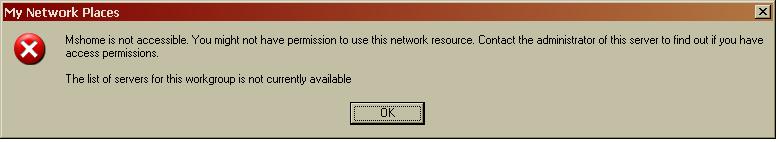

No matter what I try I just can not get this WinXP SP3 laptop to see the other computers in my father in laws home.
PC's involved
  • WinXP SP3 - Dell Laptop <-- Problem child
  • WinXP SP3 - HP desktop
  • Win7 64bit - Toshiba Laptop
The desktop and Toshiba devices work just fine together, they can see the home workgroup and they can access one another without any incident. Now this Dell laptop, it's been a royal pain ever since he connected to the school wifi at his college. Since then, there is no working at home anymore without placing a manual entry in the HOSTS file.
It can access machines by ip address, but not by machine name. This is OK for awhile, but there are some apps that are slower as a results and they bring the laptop to a near stop.
I have tried the following without success:
  • Removed network adapters and reinstalled
  • Made sure Netbios was enabled on TCP/IP traffic
  • Removed Norton Security Suite via the Norton Removal Tool
  • Reset the Windows Firewall
  • I even tried a MS FixIt thing! Microsoft Fixit 50393
  • I've binged my google so much that I need a new keyboard :blink: :wacko:
The only thing that works is the HOSTS file. Anyone else run in to this and resolved it? I'm pretty frustrated with it right now.

As to his browsing now working?? You say you can access by IP -- what about name.
Ping the troublesome machine by IP, then try it by name

Machine is named and they are all in the same group - Sorry BudMan, I made sure that was the case. ;)
This worked fine prior to connecting to his college network, since then he can not access other machines by computer name at home. Only by ip address.
With his shares and printers all being mapped, accessed, or installed from his pc named "HP" this doesn't work when he can't resolve the name. So in the HOSTS file I added the following:
192.168.xxx.xxx HP
Now those shares work as does printing, but there is a noticeable lag and as mentioned earlier, some apps just sit a think before coming back and being usable. None of that happened prior to this little mixup.

Yeah curious what the node type is, since if school set it to say p-mode then it would only be sending netbios queries to some wins server and would not do broadcast for the names.

Its a bit dated, but still good info.. For example -- so your machine can not resolve HP.. what does nbtstat -a HP return?

Here is the contents of ipconfig /all
C:\&gt;ipconfig /all
Windows IP Configuration
        Host Name . . . . . . . . . . . . : D
        Primary Dns Suffix  . . . . . . . :
        Node Type . . . . . . . . . . . . : Peer-Peer
        IP Routing Enabled. . . . . . . . : No
        WINS Proxy Enabled. . . . . . . . : No
        DNS Suffix Search List. . . . . . : hsd1.mn.comcast.net.

"Node Type . . . . . . . . . . . . : Peer-Peer
Which = P-mode
# P-node (peer-to-peer): it uses NetBIOS name server such as WINS to resolve names of the NetBIOS. P-node does not work with broadcasts, because it directly query with the name server, enabling computers to resolve NetBIOS name across routers. P-node requires that all computers should be configured with the NetBIOS name server IP address. If the NetBIOS name server is not functioning, computers will not be able to communicate.
Well there you go - its never going to broadcast for names.
And for what possible reason would you have a wired and wireless connection going on at the same time?? If you wired, disable your wireless connection. This can quite often be setup automatically to do that.. If detect wired, disable wireless -- most dell wireless drivers have this option.
Change your node type to hybrid or b-mode, or just delete the node type entry and it should revert to default and you should be fine.
http://support.microsoft.com/kb/903267
To resolve this issue, follow these steps:
1. Click Start, click Run, type regedit, and then click OK.
2. Locate and then click the following registry subkey:
HKEY_LOCAL_MACHINE\System\CurrentControlSet\Services\NetBt\Parameters
3. In the right pane of Registry Editor, delete the following values if they are present:
* NodeType
* DhcpNodeType
Note If the NodeType value is present, this value will override the DhcpNodeType value. If neither subkey is present and if no WINS servers are configured for the client, the computer uses b-node mode. If at least one WINS server is configured, the computer uses h-node mode.
4. Quit Registry Editor.
5. Restart the computer.
6. Try to view workgroup computers on the network again.
Or they have a download on that link to fix it for you ;)
http://go.microsoft.com/?linkid=9668706
