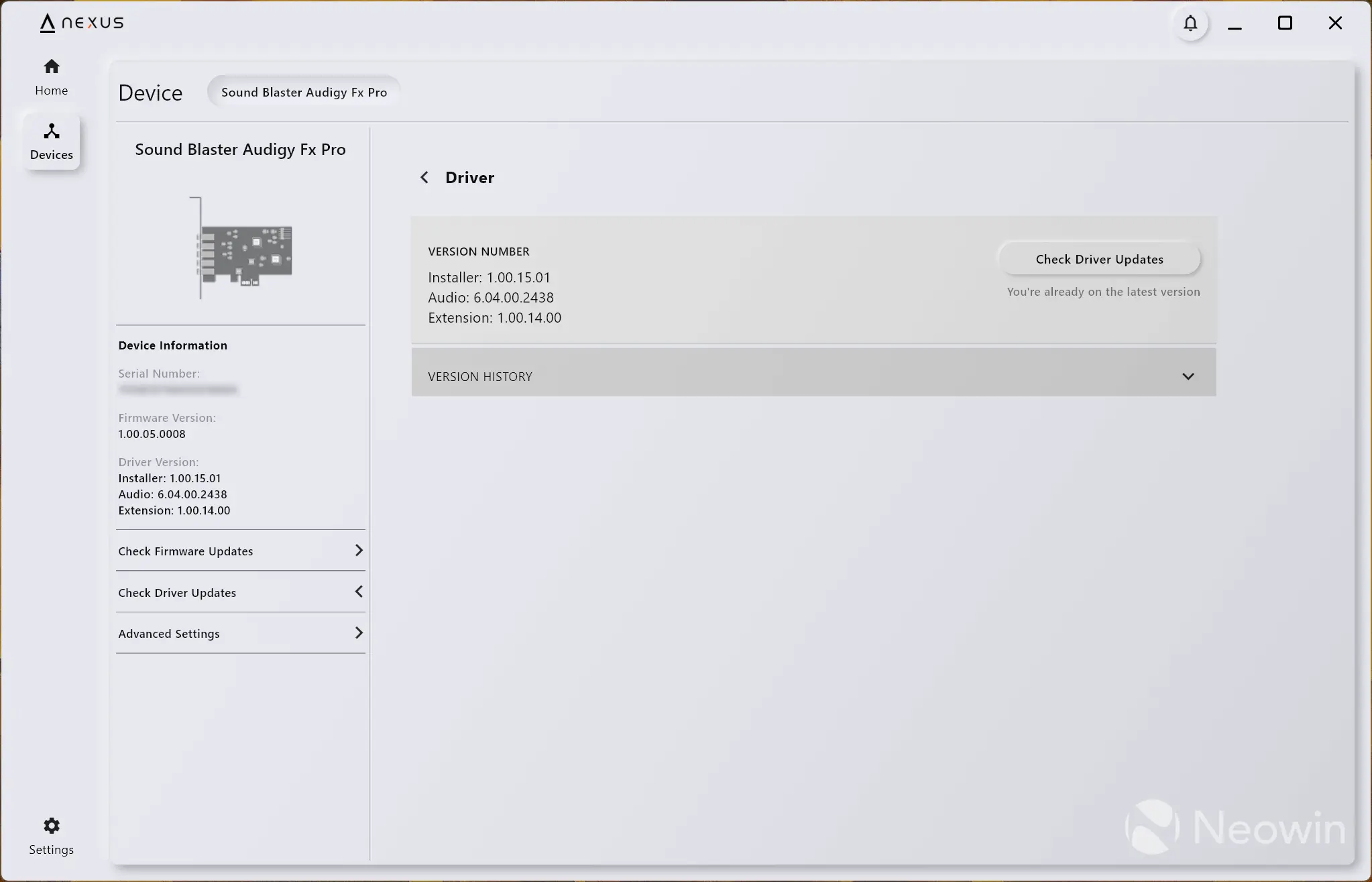

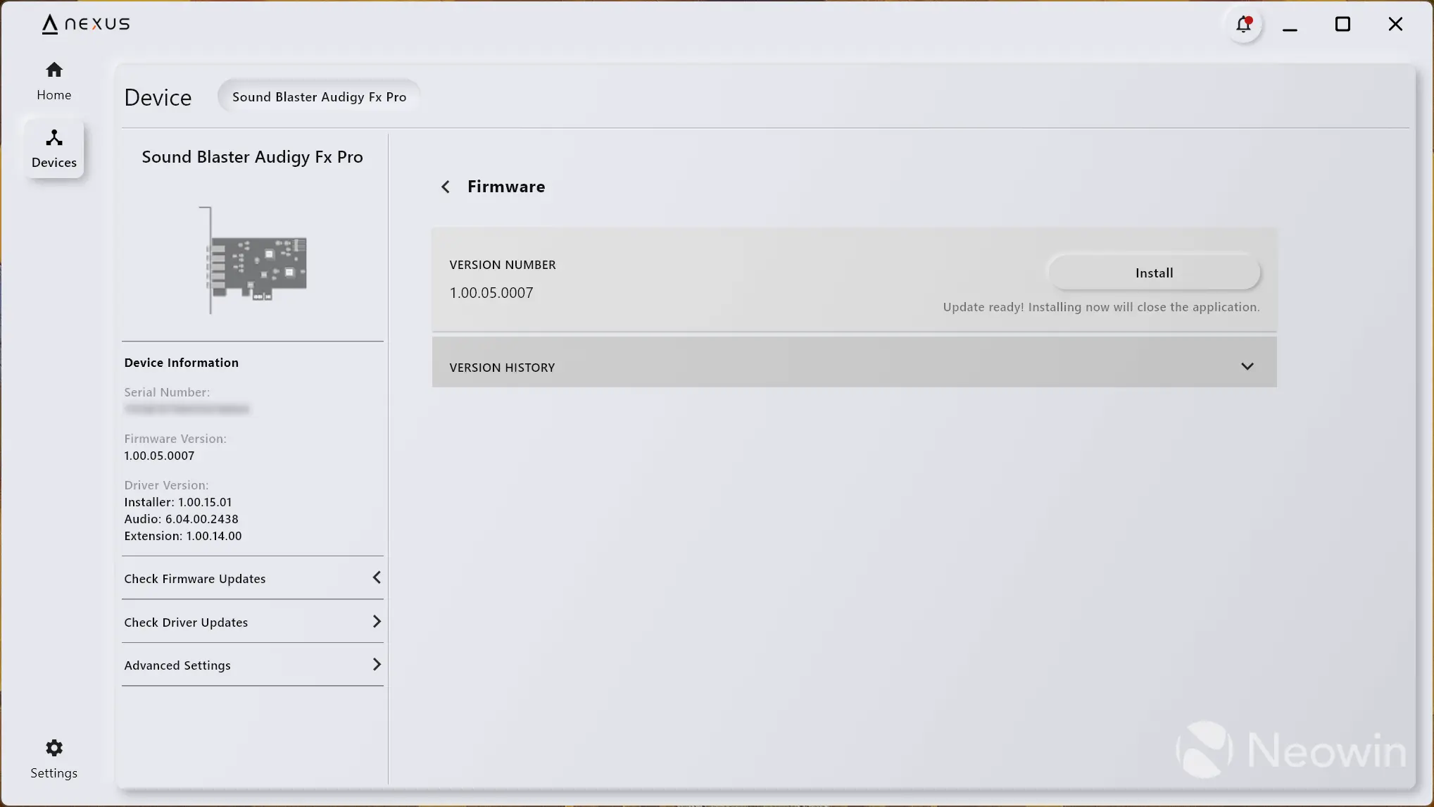

After installing the audio driver, I installed Creative Nexus, which is a new app designed for the Audigy series. Then I discovered the Audigy FX Pro needed a firmware update from 1.00.05.0007 to 1.00.05.0008, then I was set to go.
As you can see above, you can manage the firmware, driver, and inputs via Advanced Settings on the Device tab. By default Nexus enabled "Direct Mode". Upon clicking on Acoustic Engine, the Equalizer can be enabled and set to four different presets, which are:
