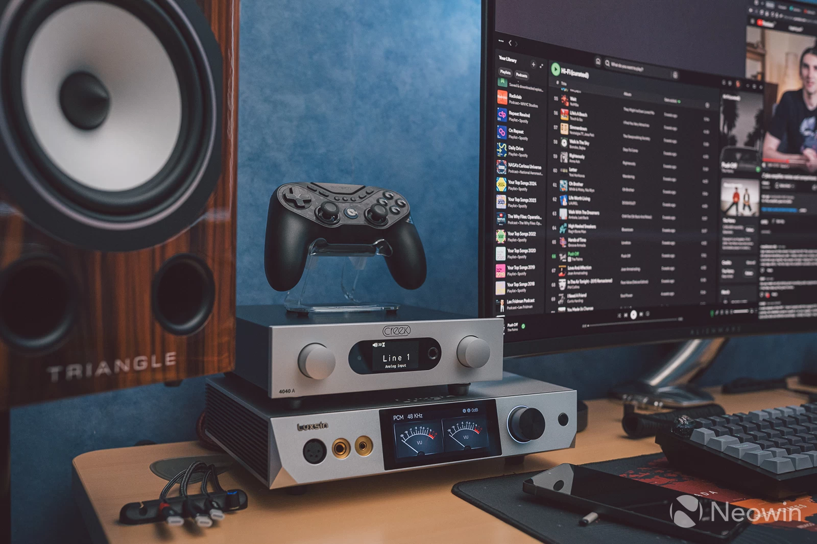

Emphasis on desktop, as my listening is primarily done in a near-field setup since I spend a lot of time at my workstation editing photos/videos, as well as writing and doing research. So, having quality audio has always been a must.
With that in mind, my existing kit consists of a FiiO K11 R2R acting as DAC and headphones amp, with an Aiyima A80 power amplifier to feed passive speakers. Whilst the price difference between the K11 R2R and the X9 is huge (€140 vs €1099), sonically I feel as though the DAC inside the K11 R2R is relatively excellent, especially once you use a clean and low-noise power supply, such as the iFi iPower2, an inexpensive switching unit that improves the sound, even if a small amount.
It is doubly an interesting comparison as it potentially can highlight the point of diminishing returns, as well as highlight key areas that actually matter for individual listening tastes. I"ll try to cover as much of this as possible in this review, and as always this is a subjective take, so your mileage may vary, but hopefully with all the information presented here today, you can make a suitably confident decision on whether the X9 might be something you want to check out.
HiFiMAN Arya Stealth headphones were used via the front balanced outputs. The DAC section was tested using the X9"s rear XLR balanced outputs going into the Aiyima A80"s TRS balanced inputs. The power amplifier is connected to a pair of passive speakers, the TRIANGLE Comete 40th Anniversary.

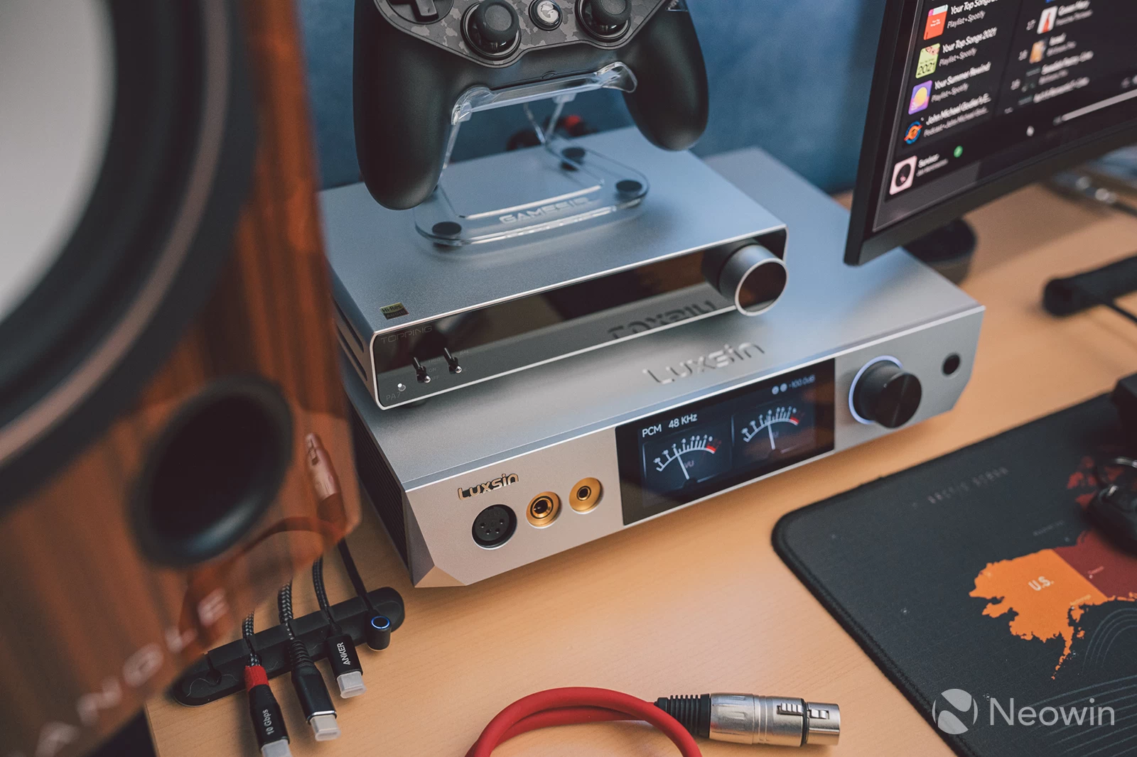

What struck me the most when pulling the X9 out of its pouch in the box was how hefty and solid it felt. The diamond-cut fascia panel has some interesting design features: an angled front that looks up with flat corner cuts that slope downwards, there"s no mistaking this distinct design for a model from another brand, even from a distance.
The only physical button is the one to the right of the volume knob. This is the power button (long press for off, short press for on), which also functions as a mute button with a short press when the X9 is on.
The volume knob is suitably weighted and feels premium to turn. Not only does the internal pot ratchet sound nice, but if the X9 is turned on, then the relays actuate with each increment, and this sounds really cool to me. However, reading around after I posted the below video on forums, opinion was divided, with some saying it appears this is just an array of relays actuating instead of a full-blown R2R ladder with relays.

These are the Creek 4040 A...
... and the Topping PA7:
The 4040 A should have sounded excellent based on rave reviews, but sadly it was a disappointment to my ears and in this sort of configuration. I heard a lot of interference noise being passed through the chain to the Creek which wasn"t being filtered out by its internal components. The soundstage was also compromised by placing vocals too central in the stereo image leading to fatigue in my head fairly quickly. Songs that I have listened to for many years across multiple devices felt flat and lacking via the 4040 A on my speakers with, the X9 remained in its bypass mode so not adding any new colouration or filtering into the mix. There is also audible hiss in the noise floor when nothing is playing and cross-input noise overlap could also be heard.
None of those issues are caused by the X9, but worth pointing out, because as soon as I swapped out the 4040 A with the Topping PA7, everything became clean and silent, and the soundstage for vocals was back to how it should be, with a greater air of refinement and clarity over the already excellent output from the Aiyima A80 power amplifier and Sparkos OpAmp upgrade I had in all this time.
In fact, such is the pairing between X9 and PA7, that dare I say it, this might be a formidable combination to beat at under £1500. Clean and edging on smooth/warm to mitigate any harshness in the higher frequencies that tend to exist, especially in 1980s pop music, such as Lucky Star by Madonna.
I will not be getting in the Ferrum WANDLA HP until after July, so it"s hard to say how the X9 stands up to a box that costs nearly 3x more, but if our community-collective ears and gear are anything to go by, then this is high-end sound at mid-range price, the additional customisation features are cherries on top.
