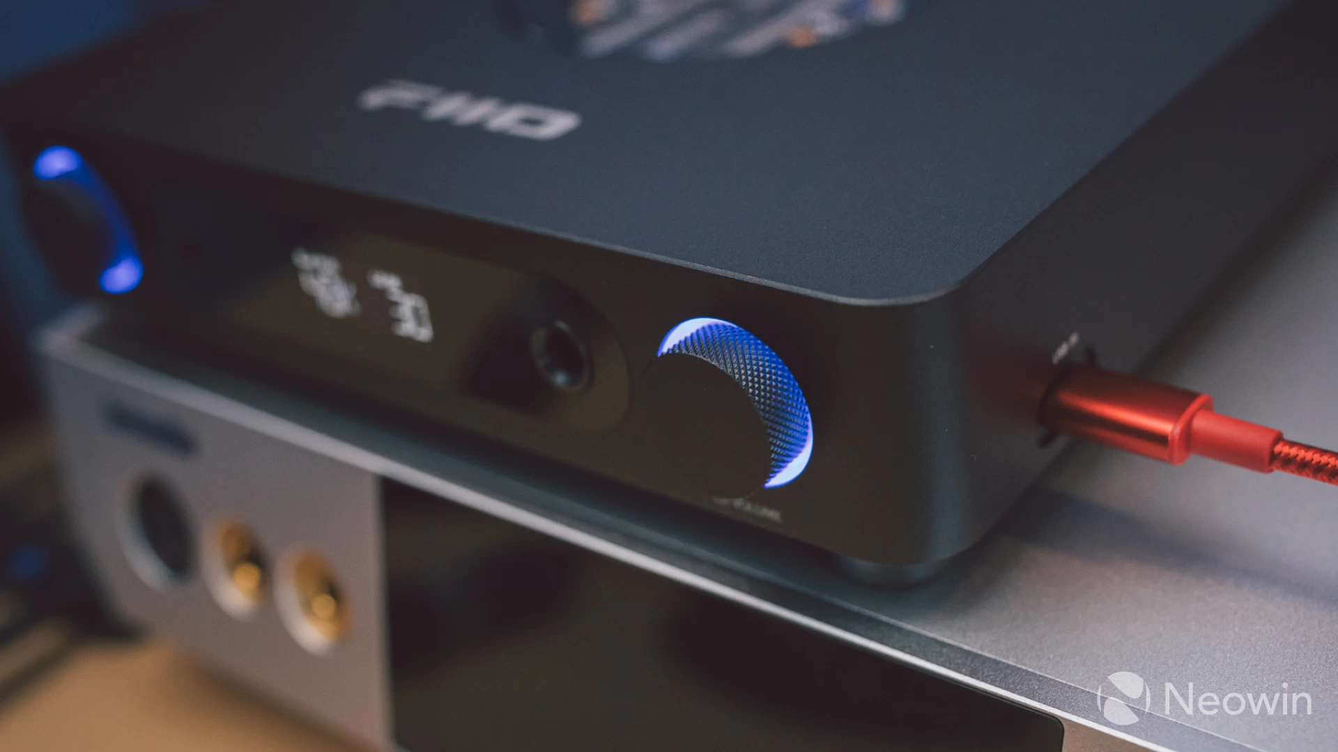

Both models share the same metal volume dial; the K13 R2R has an additional dial for mode selection, too. Both are knurled the same way for an excellent grip and one-finger operation. The volume pot is digital with the display reacting instantly to every notch on the dial, with no missed increments when turning at speed.
The remote control is new, as the K11 series never got one. It's nice to see that all main functions have a button, especially the output select modes, since the K13 does not automatically switch to headphones when connected, and as such switch back to pre-amp or line-out when disconnected. A dedicated button for each output relieves some of the faff involved with having to reach over to the mode dial each time throughout the day.

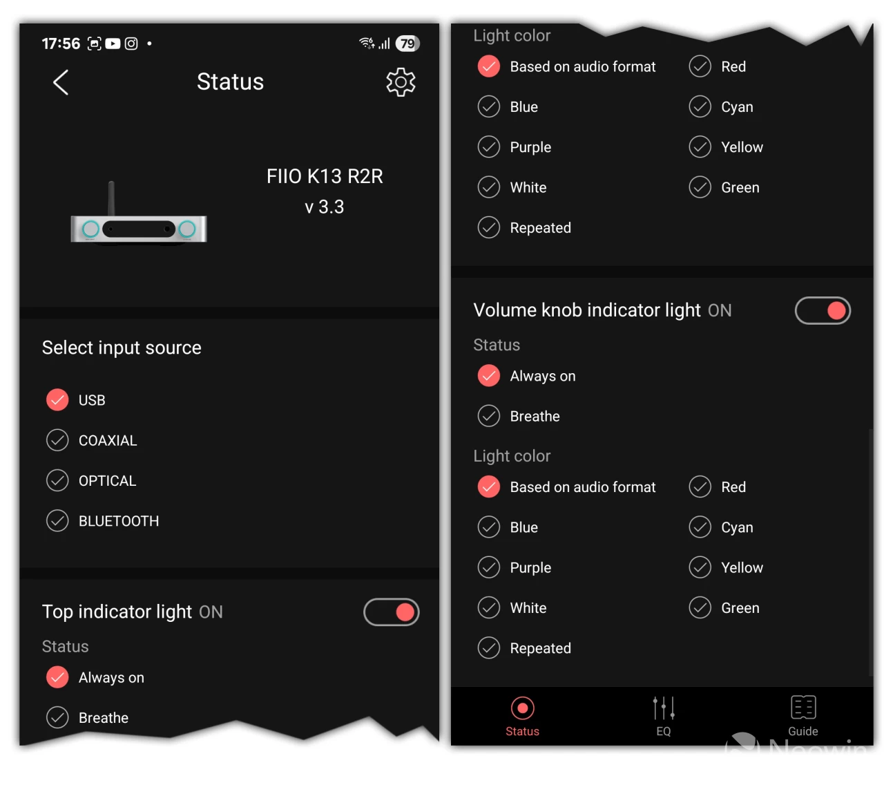

The lighting colour and style can be customised by using the FiiO Control app found on the app store on your phone. This connects via BTLE without the need to add a Bluetooth pairing and offers a range of options, along with the ability to rename the unit and update Bluetooth Firmware. The main hardware firmware can be updated the traditional way using the USB port.

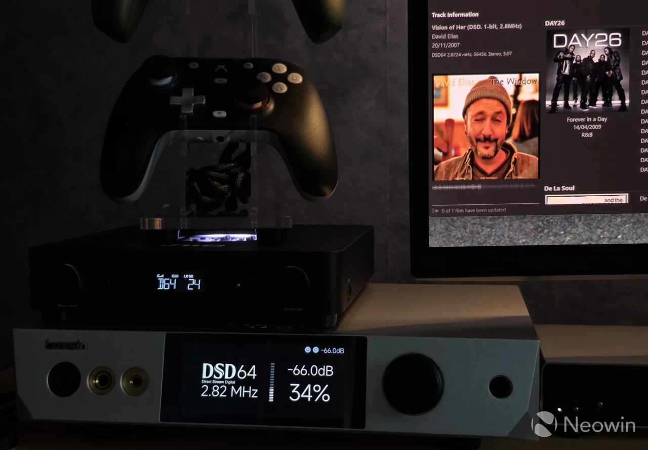

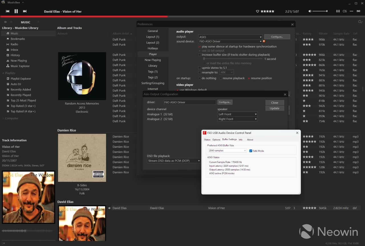

I wanted to try out DSD audio first, as this is one format I have not paid much attention to until most recently. Prior to this, my choice of lossless has always been FLAC container tracks that I have ripped myself from a CD or purchased online.
The DAC will decode most music you play as PCM, whether they are compressed or lossless. Still, if you play back DSD files (.dsf file extension), these can be played back as PCM via a conversion done on the DAC hardware as D2P (DSD to PCM) and 1-bit DSD (native), or in your software player (DOP - DSD over PCM). The DAC may have a menu option to set the DSD mode between 1-bit and D2P; the K13 R2R has this option.
MusicBee
Is any of this really that important to know? No, not really. The debates online can swing either way, the more research you do, the more you realise that ultimately what matters more is the mastering, regardless of whether the music is lossless or compressed. This is summed up nicely by Gemini:
"While DSD purists claim superior sound, many audio engineers note that the mastering and the equipment's quality are more significant factors in the final sound than the format itself"
Nevertheless, getting DSD files playing can sometimes involve some faffing around with your music software. I am a long-term MusicBee user (shown above) and had to set the player's DSD mode to use DOP, and then select a supporting ASIO driver. Note that whilst Windows has native support for exclusive mode (required for bit-perfect streaming to a DAC) via WASAPI Exclusive, it does not play back DSD files as DSD but instead as PCM, which the DAC detects as a hi-res PCM signal.
The necessary ASIO driver is needed instead, and only then does the DAC display DSD on the front panel, in this case, D64:
DSD audio

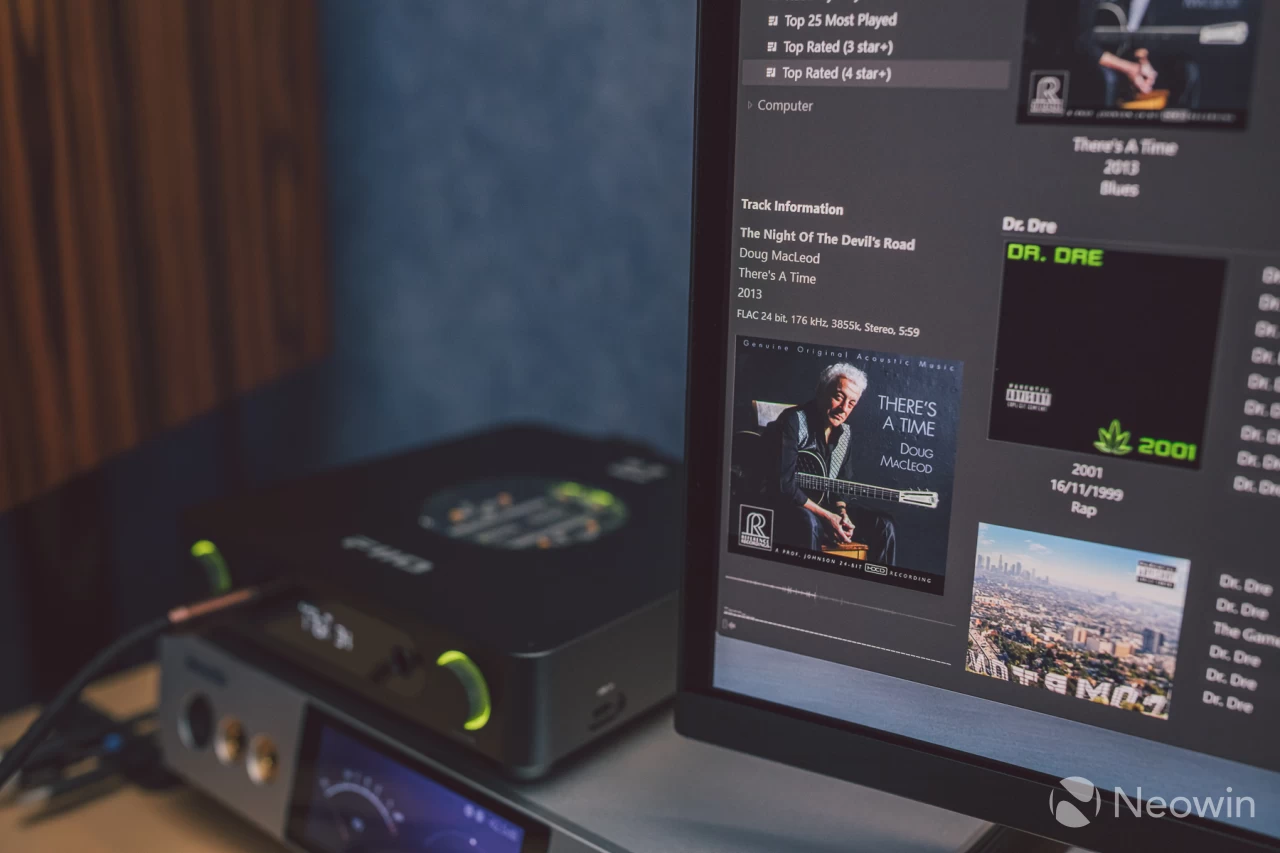

As it's September, PC gaming season is in full swing with some new games I've been getting into. Cronos: The New Dawn has incredible audio production, from the background score to the dynamic sounds throughout the game world. I felt immersed almost holographically, whether wearing headphones or through the speakers.
Firing up a movie another time showed me that the K13 also carries weight at presenting cinematic audio with aplomb; of course, this is a stereo amplifier. I'm here playing surround sound content, but down-mixing in MPC-HC from 7.1 channels showed no audible distortion at any volume level with the K13, nor was there any confusion with the output not sounding natural and cinematic after mixing all those extra audio channels down to just two for the DAC to decode.

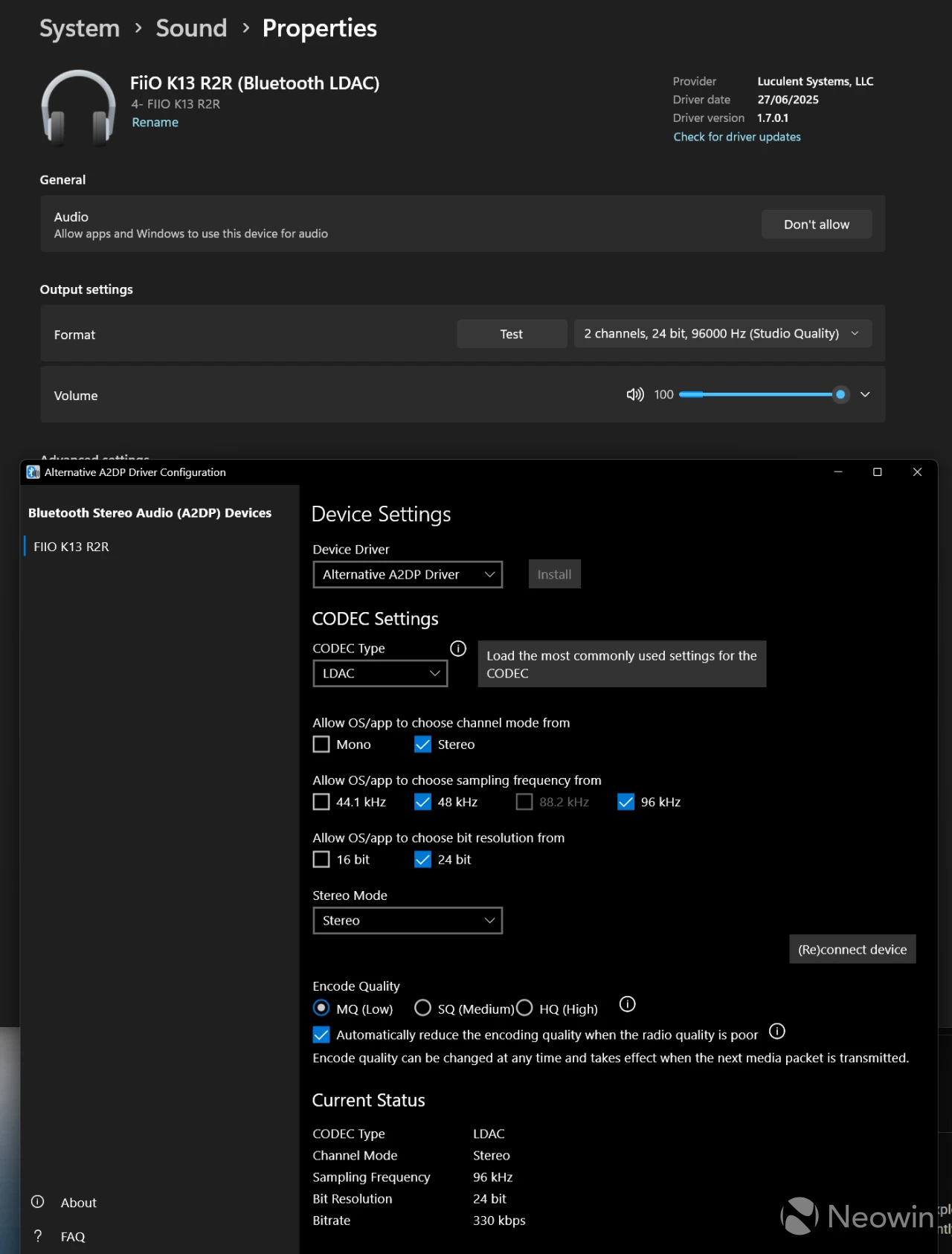

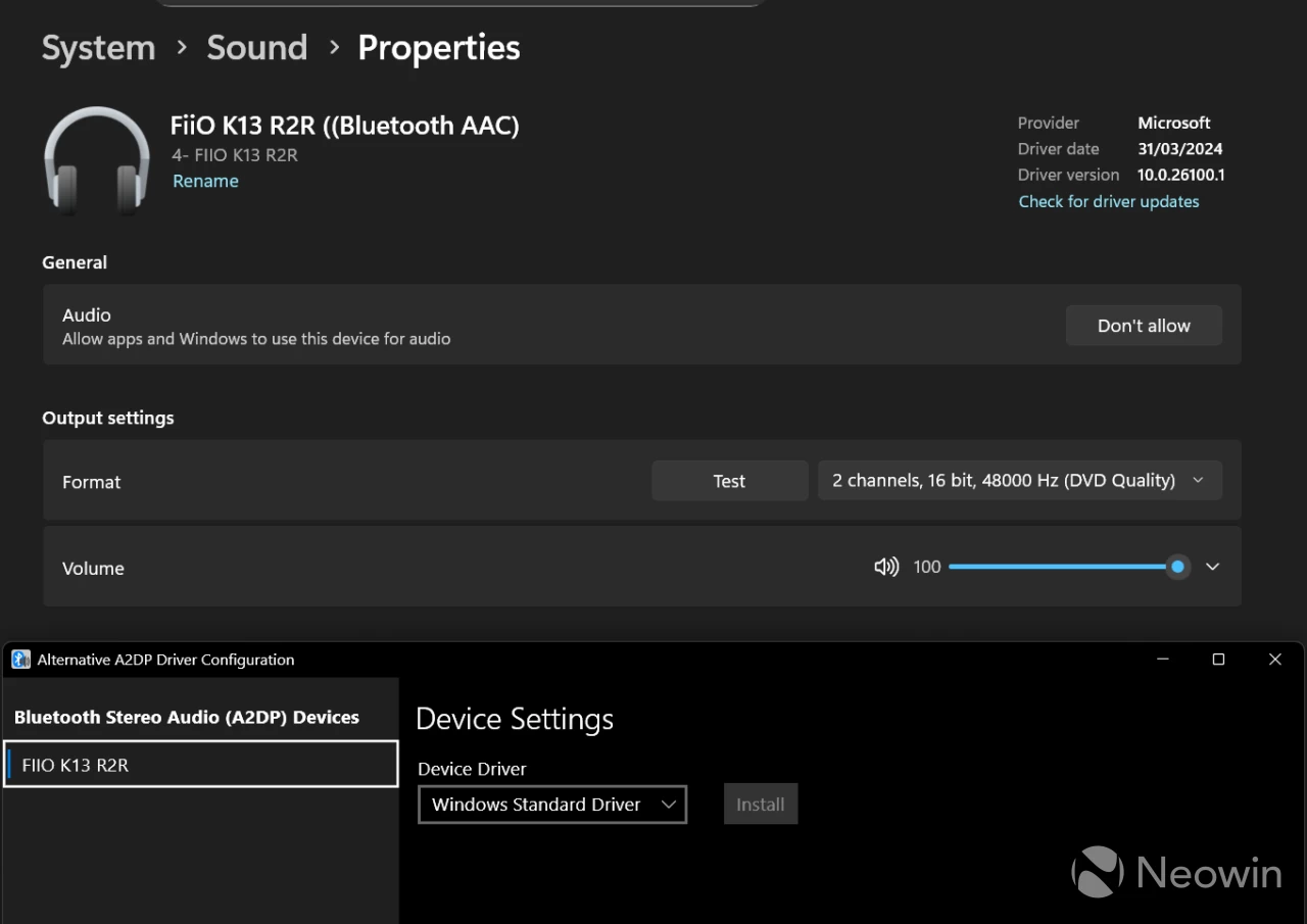

Bluetooth connectivity was painless, but as I have said many times in past reviews, if you are on Windows, then Alternative A2DP Driver must be used; otherwise, Windows will simply use the lowest quality CODEC, which in this case is AAC when using Microsoft's abandoned native driver.
Enabling the third-party driver allows the use of LDAC and sample rate and bit-depth rise to 240-bit 96KHz. Using Bluetooth, even with LDAC, will not be truly lossless, though. Still, the quality difference between it and AAC is very obvious, especially with music congested with a smattering of instruments and vocals.

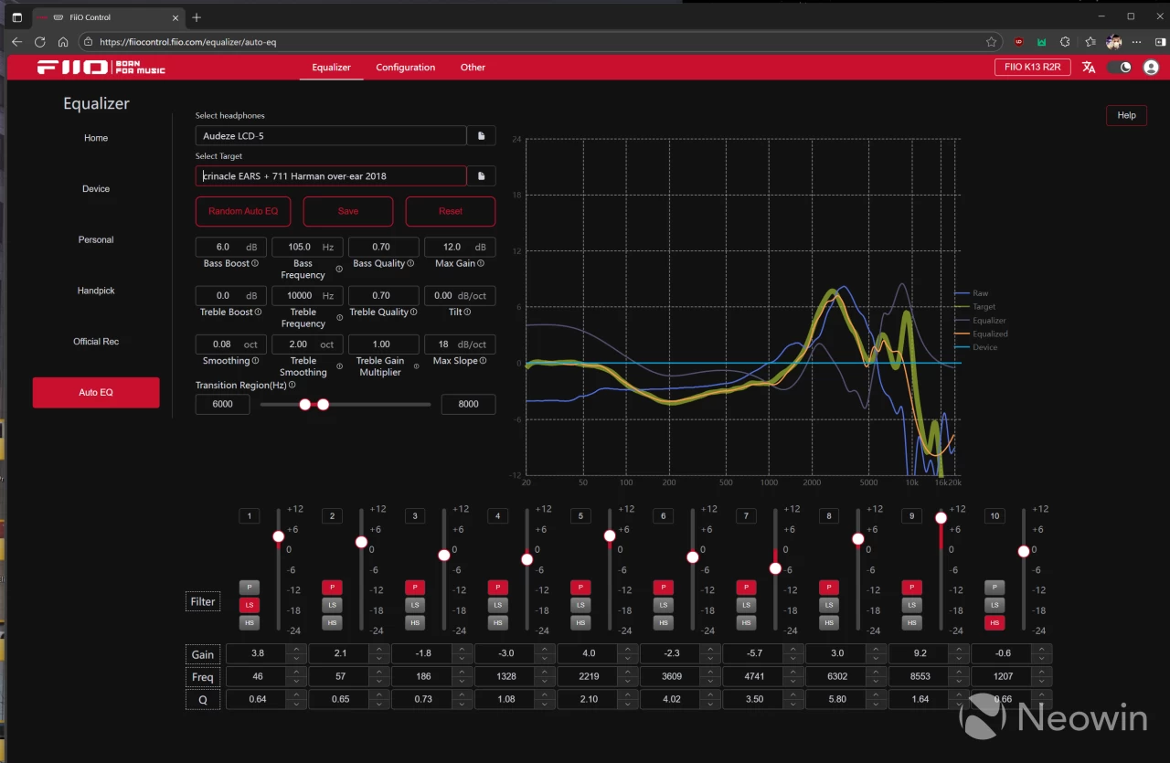

Parametric EQ and customisation
Similar to the Luxsin X9, the K13 R2R's 10-band PEQ has a built-in cloud database for many headphones available today, with target curves that can be selected and then saved to a user slot.
This is all done via FiiO Control, a web-driver-based software accessible by visiting fiiocontrol.fiio.com from a HID Connect-compatible browser such as Chrome or Edge:
fiio k13 r2r
Once connected, picking a headphone model and target curve is very easy; you can then further tweak to customise and re-save as your own bespoke target curve if the supplied one does not quite hit the mark.
The PEQ can also be configured using the FiiO Control smartphone app, though the UX for this is not very pleasing. I recommend using the browser version at all times.

The app is required to update Bluetooth firmware and customise various settings, such as RGB colours and lighting modes, these settings are not possible via FiiO Control in the browser which I find illogical again. Doubly so because whilst the on-screen menu offers the ability to customise the display, knob and panel lighting, it does not allow you to choose lighting modes or colours like the app does.
I feel that everything should be in one place, with options in the menu also included. It makes no sense to spread out different settings across three other interfaces.
