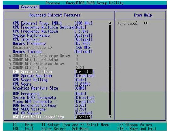

I'll get a pic of my current BIOS settings while I am there...
G
I apologize for the poor pictures...I wasn't planning on taking so many and wasn't really planning ahead...
BIOS Default -
This is what I have been running at as my default setup. It is stable and has decent performance. Basically, the initial bootup settings overclocked from 133Mhz to 160Mhz. This is what I stepped up 3Mhz at a time when I was overclocking. It would not accept jumps of more than 3 or 5Mhz at a time, but if I went slow it went up without a problem. At 166Mhz, the system is not 100% stable, and I believe the problem is my ancient Palamino. Shame I can't drop the multiplier...

1750 -
She booted and ran for a few hours at 166Mhz, but Hot CPU Tester revealed that the CPU was not 100% stable. A short while later the computer spontaneously rebooted (but did not generate a BSOD error). When she did that I reduced the FSB/CPU to 160Mhz, set the System Performance and Memory Timings to Agressive, and have been running on that since. Hot CPU Tester says these settings are stable...Unfortunately I forgot to get a new pic of these settings...which are not represented above...doh...
Ok. Thats it. Draw your own conclusions, but I say the BIOS is poor. I don't like it very much, I don't like the way it acts, or reacts to changes, I don't like the way it is hiding all of the important decisions it is making, I just don't like it. It shouldn't be so hard. Oh...and this doesn't even include the fact that I can't lower my multiplier...
Please note that I did not actually try to boot any of the above settings except for the first and last. I know that most of them won't boot, because the first day I got this board I spent about two hours trying all sorts of combinations to find something that simply worked...much less work well...
