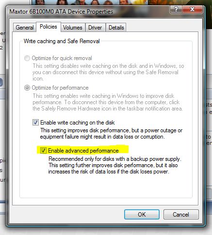

I had some problems with Vista causing my sata drives to make a knocking noise, usually related to the increased thrashing over XP. I disabled the automatic defrag and enabled advanced disk performance option in the device properties on each of my drives. Now they are silent.
