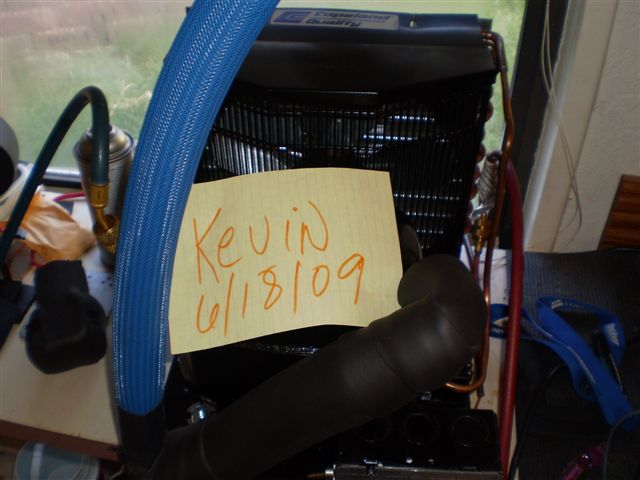

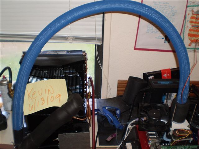

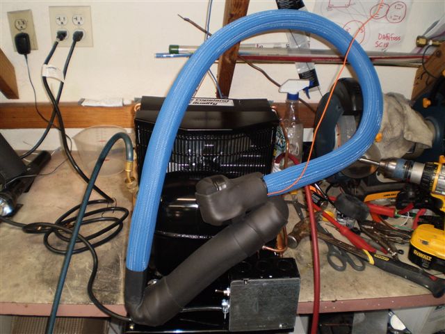

Well as some may know from my last thread, the old phase unit could not be repaired, and in the end was not worth the hassle. So i contacted a new builder and have this new bad boy.
Here are the specs
Danfoss SC18CLX.2 compressor
Chilly1 evaporator
four foot suction line
r507 refrigerant
It was tweaked for maximum cooling and will hold -37c with a 4.9ghz overclock at 1.525volts (corei7). I will be putting it on my q6600 in the meantime, but will have it cool an i7 next month (hopefully). I have almost completed my bench table (pics will be added soon).
