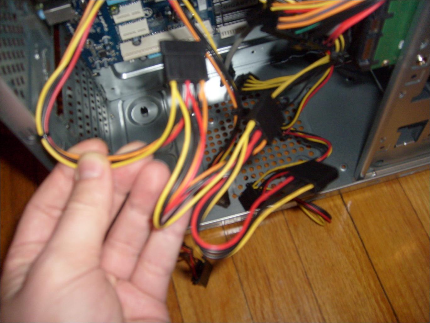

1 & 2) What are these two black and yellow cables? You can see in the first picture there are two separate cables, and the one on the left has two separate connections, as you can see in the second picture. So these black and yellow cables actually have three separate connections, all of which are different.

#1: This picture is kind of blurry so I may misrecognize it, but these appear to be extra power connectors for your CPU or GPU for a dedicated graphics card. Look near the CPU socket and if there is another socket that will accept the pin layout, that's probably what its used for. I didn't see a dedicated graphics card in your build yet, but if you are planning on adding it in later, the other one may go there.
#2: These look eerily similar to #1, so I'd look in the same places.

#1 GPU (6/8pin) thats what the little extra bit for is.
#2 CPU connectors
