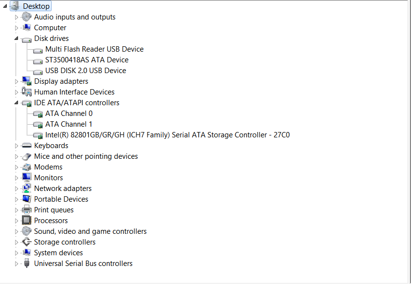

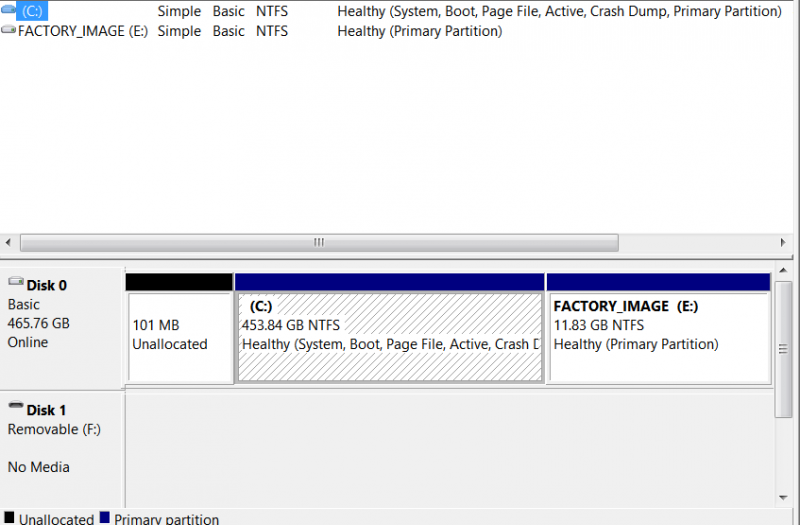

So...last night I installed Windows 8 Consumer Preview on my Hp desktop , & everything went well .....but my dvd/cd drive isn't showing up in Device Manager/Disk Management , So... I checked my bios to make sue that it is being picked up by the PC & it is .Is there a specific reason behind this ? I'm thinking that I need to install Chipset drivers to get it Win 8 to see it when Windows loads .What y'all think?
I have included screenshot of my Disk Manager/Device Manager
Thank You For Any Help Y'all Can Provide.
Specs:
Hp Desktop
Model #s5257c
Intel Pentium E5300
SuperMulti DVD Burner
post-153718-0-26027200-1335874861_thumb.
post-153718-0-94149500-1335874869_thumb.

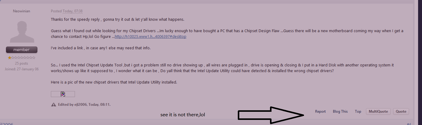

Thanks for the speedy reply , gonna try it out & let y'all know what happens.
Guess what I found out while looking for my Chipset Drivers ...Im lucky enough to have bought a PC that has a Chipset Design Flaw ...Guess there will be a new motherboard coming my way when I get a chance to contact Hp,lol Go figure ...http://h10025.www1.h...4006397#desktop
I've included a link , in case any1 else may need that info.
So... I used the Intel Chipset Update Tool ,but i got a problem still no drive showing up , all wires are plugged in , drive is opening & closing & I put in a Hard Disk with another operating system it works/shows up like it supposed to , I wonder what it can be , Do yall think that the Intel Update Utility could have detected & installed the wrong chipset drivers?
Here is a pic of the new chipset drivers that Intel Update Utility installed.
Edited by ejl2006
@ Apubo dats wat i had done after i posted my inital post , it installed & updated the chipset but still no dvd drive showing up , now like I said it does work right in win7 7 down , i have installed win 8 on several pc's/laptop & this is the first real issue i have had besides another in my people app....
