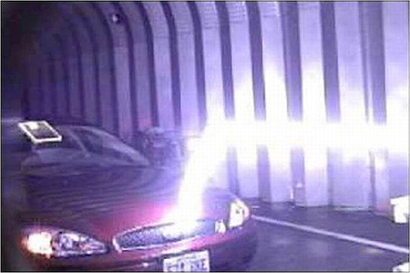

PICATINNY ARSENAL, N.J. (June 21, 2012) -- Scientists and engineers at Picatinny Arsenal are busy developing a device that will shoot lightning bolts down laser beams to destroy its target. Soldiers and science fiction fans, you're welcome.

"The plasma channel conducts electricity way better than un-ionized air, so if we set up the laser so that the filament comes near a high voltage source, the electrical energy will travel down the filament," Fischer elaborated.
A target, an enemy vehicle or even some types of unexploded ordnance, would be a better conductor than the ground it sits on. Since the voltage drop across the target would be the same as the voltage drop across the same distance of ground, current flows through the target. In the case of unexploded ordnance, it would detonate, explained Fischer.
